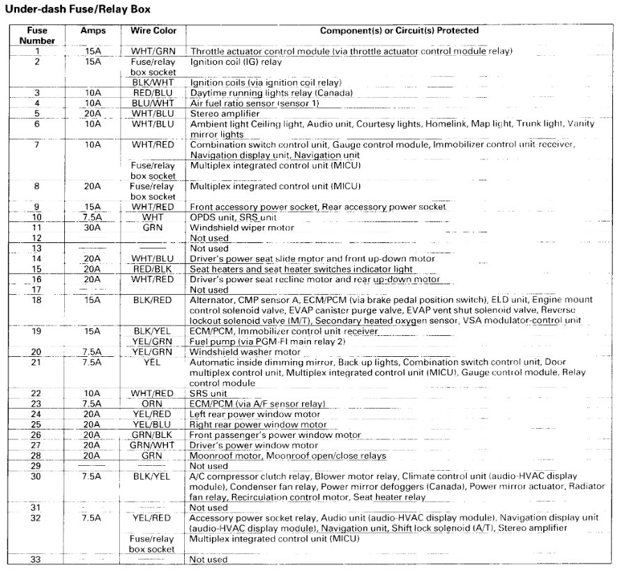

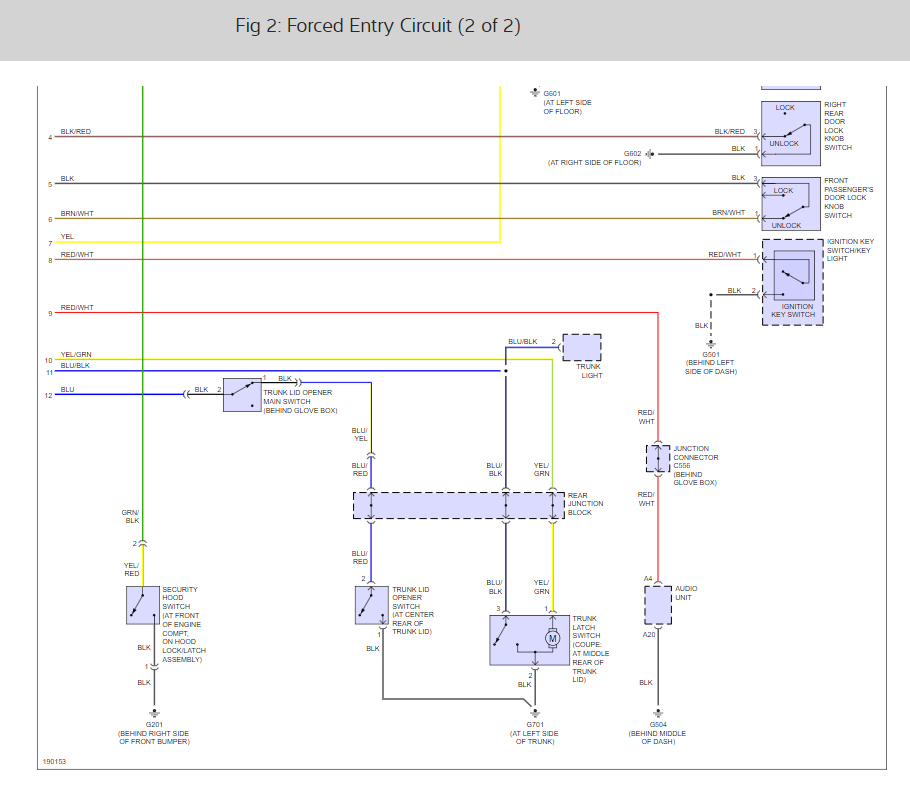

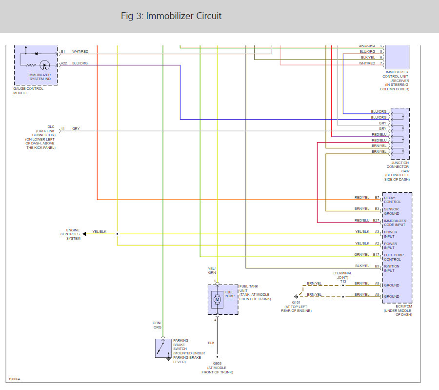

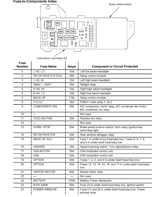

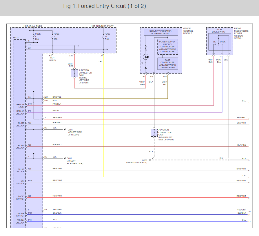

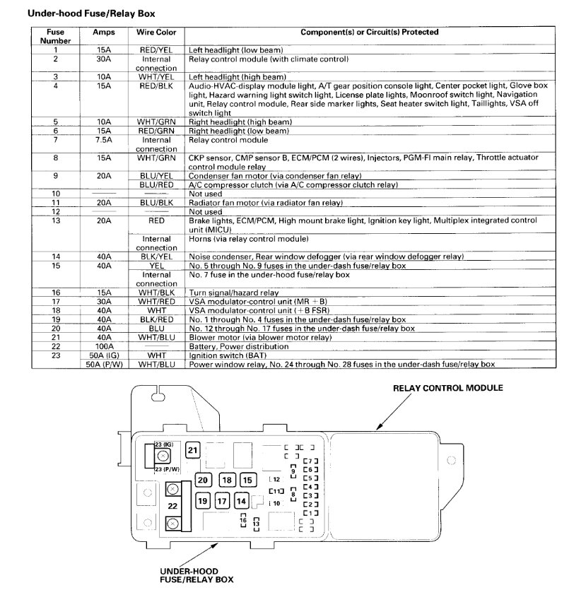

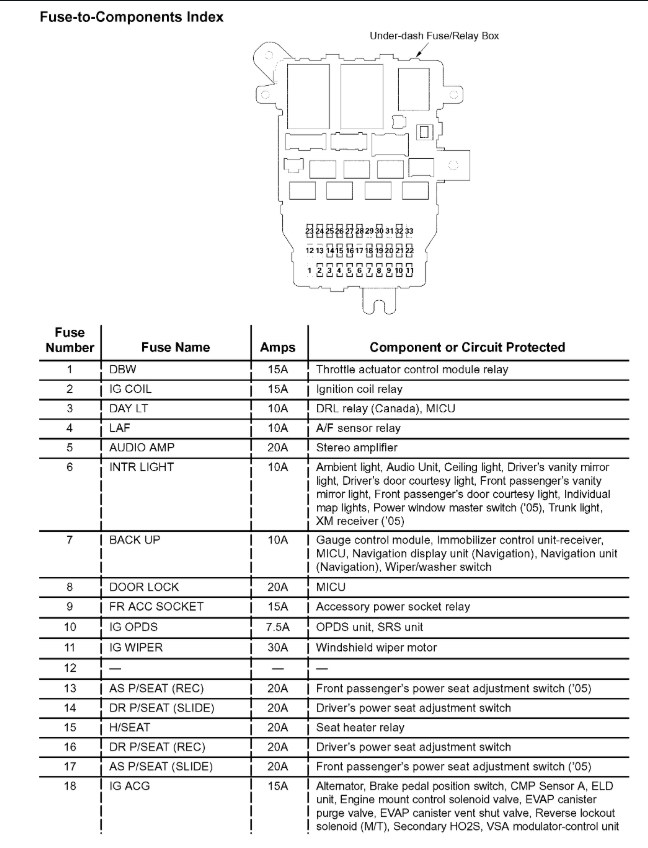

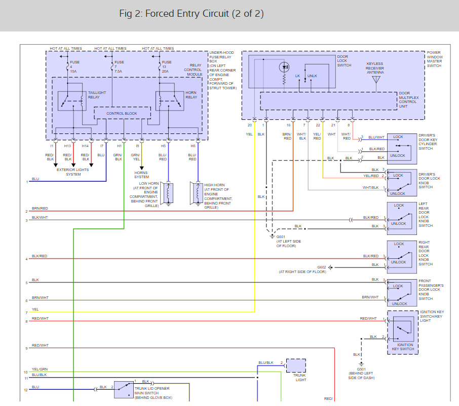

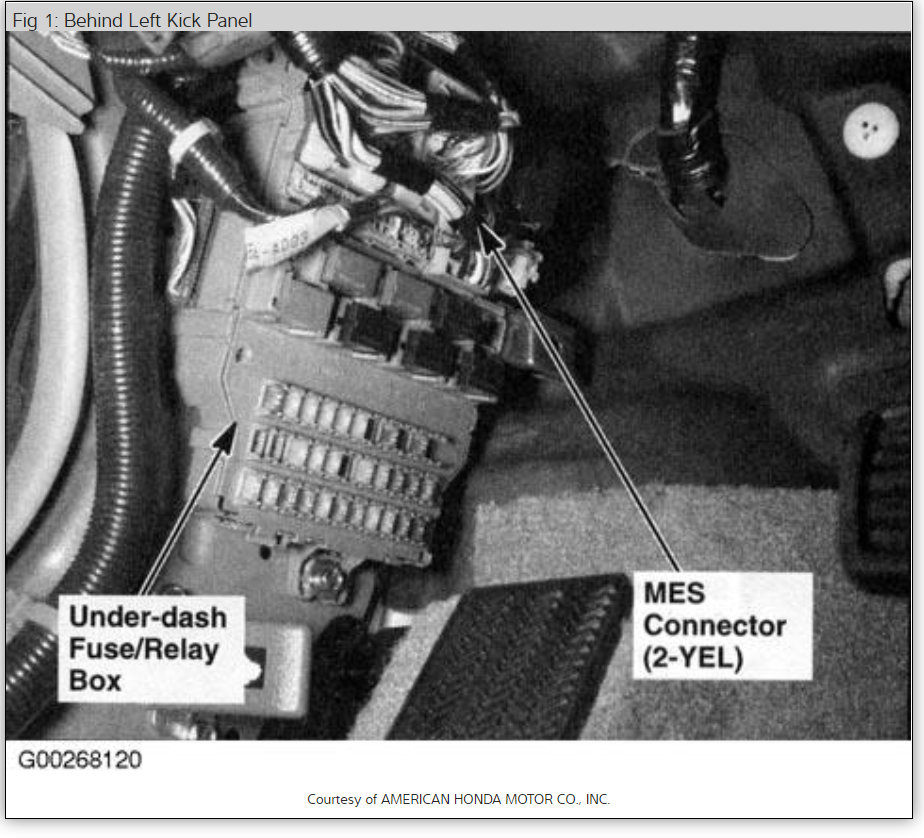

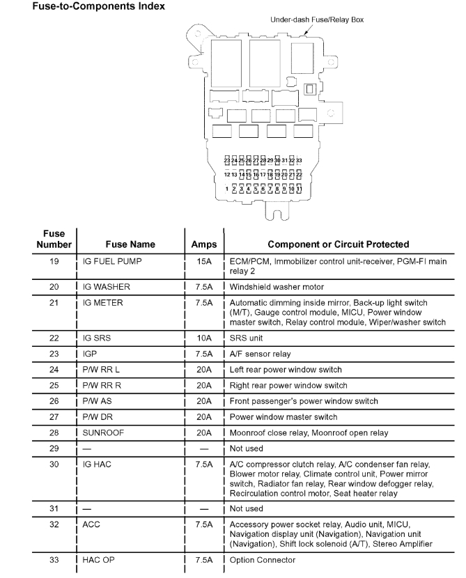

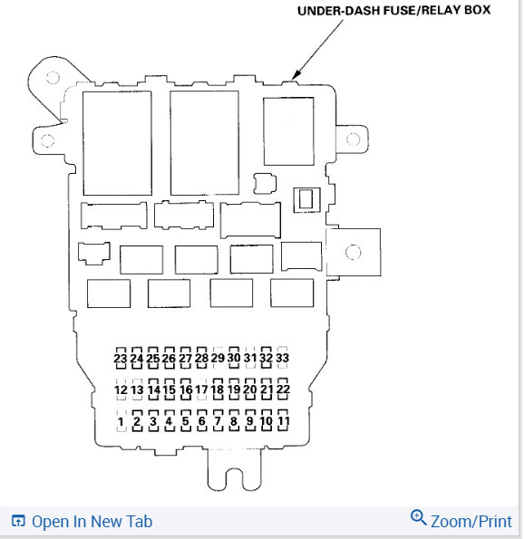

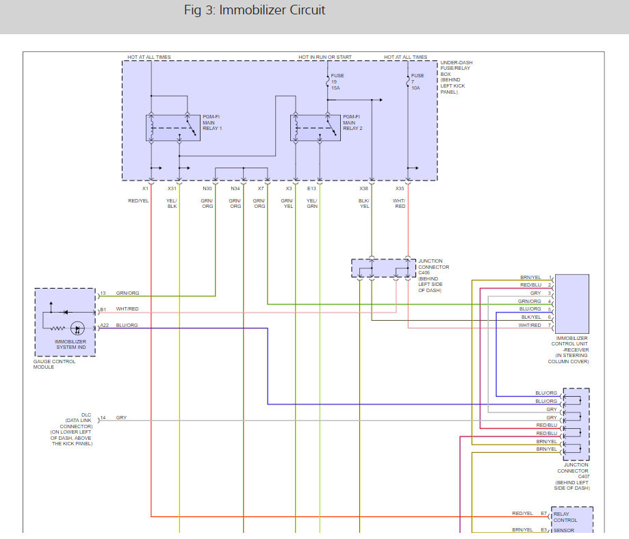

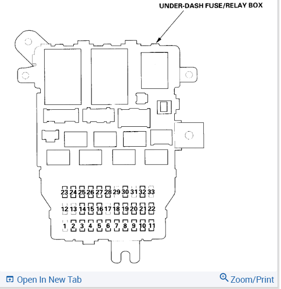

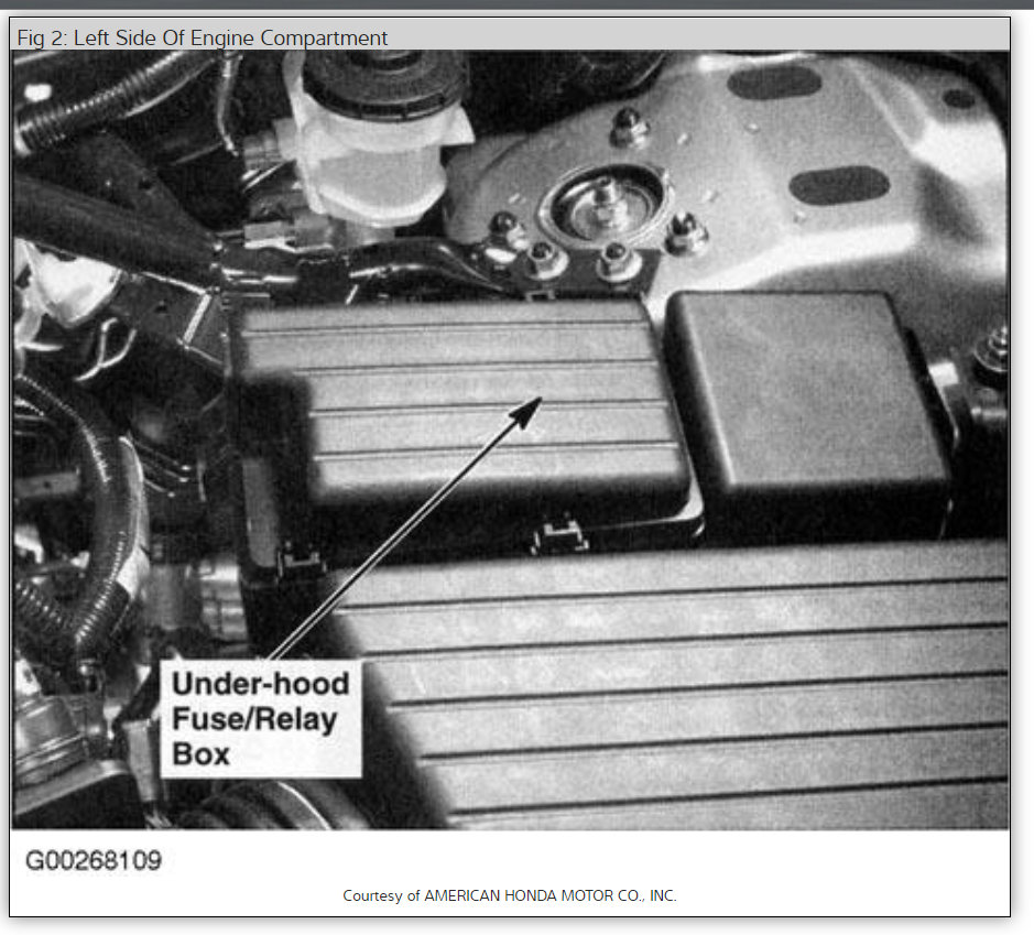

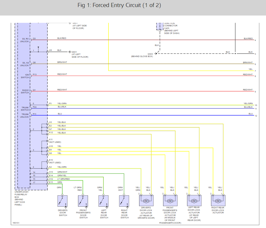

It sounds like a fuse is out. Here are the alarm wiring diagrams so you can see how the system works and a guide to help you check the fuses along with the fuse locations:
You can see the fuses that need to be checked by the wiring diagrams.
