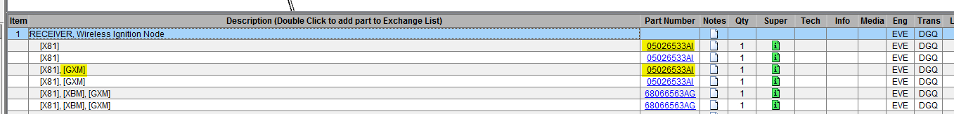

The part number in your picture ends in AI. Mine ends in AF. Is that the same? It's my understanding that they didn't reset and reconfigure the WIN. Am I correct in thinking this? Should any of my keys work after a WIN reset? I bought new fobs because my research shows that the old keys would not work.

Yes. The AI and AF are not a problem. The AI is just a later version of the AF part. In fact when this part was first made it was the same root part number (the numerical portion of the part number is the root part number) but the last two digits were AA. Then when they make a change or update/improvement to the part or software they change it to AB then AC, AD, etc.
