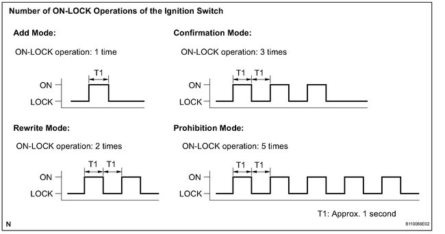

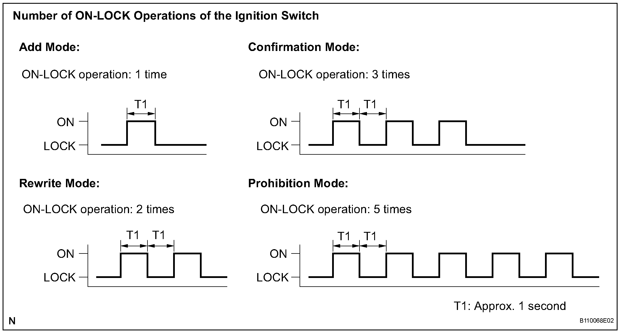

6. Turn the ignition switch from the ON to the LOCK position at approximately 1 second intervals according to the number of times given as the illustration.
HINT: If the number of ON-LOCK operations of the ignition switch is 0, 4 or 6 or more, there will no response (power door lock and unlock operation) to show which mode has been selected.

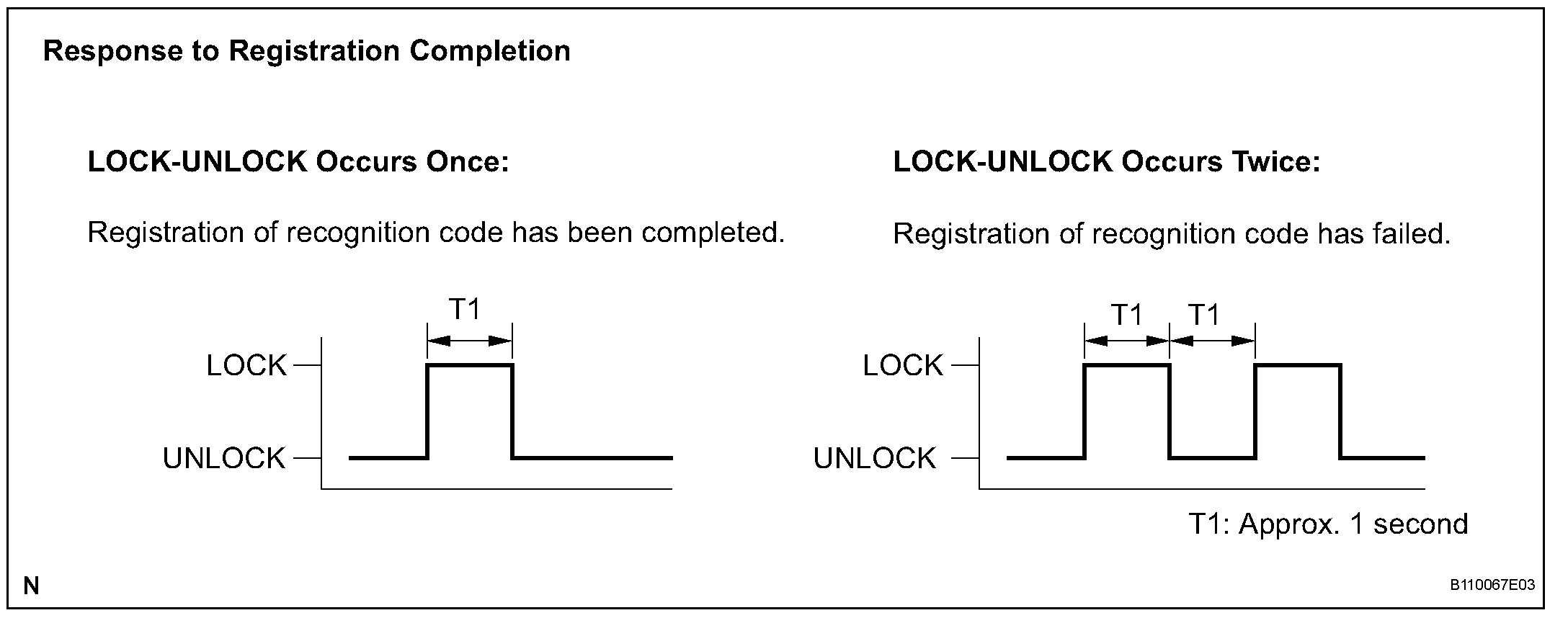

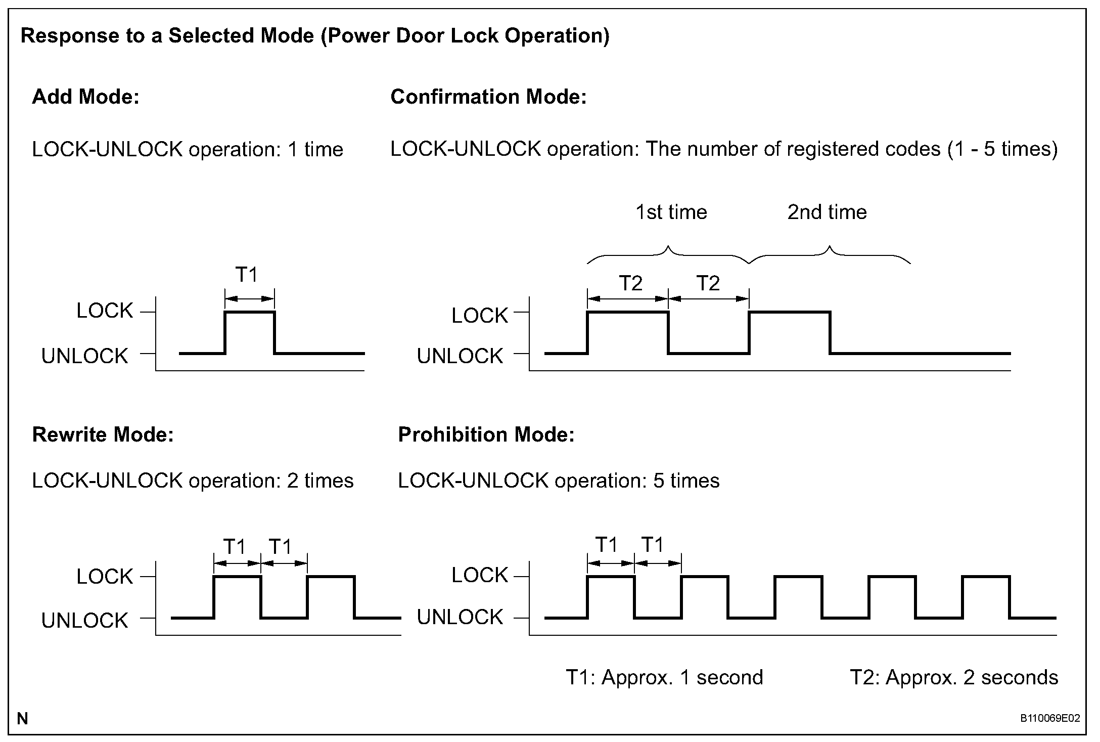

8. The body ECU automatically performs the power door LOCK-UNLOCK operation with in 3 seconds after the mode has been selected and informs the technician of the selected mode using the response patterns as given in the illustration.
HINT:
- When the confirmation mode or prohibition mode has been selected, the registration procedure will be completed.
- In the confirmation mode, when the LOCK-UNLOCK operation is performed twice, the number of registered recognition codes is 2.
- In the confirmation mode, when 0 codes are registered, the LOCK-UNLOCK operation is automatically performed 5 times.

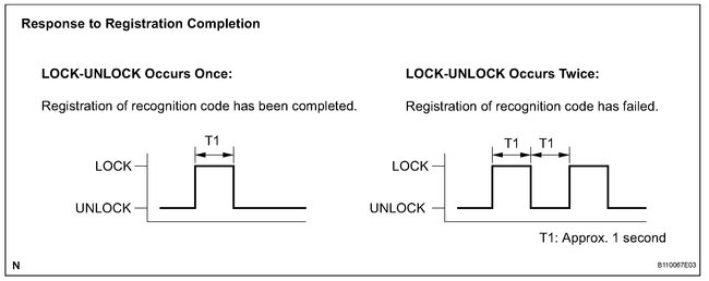

c. Registration of the door control transmitter.
1. If the add mode or rewrite mode has been selected, press LOCK and UNLOCK on the transmitter simultaneously.
2. Press either of the switches on the door control transmitter again.
HINT:
- Switches must be pressed for at least 1 second each time. The second operation must be performed with in 3 seconds after the first operation.
- A recognition code must be registered in the door control transmitter with in 40 seconds after a selected mode is responded to.
pic 3
3. The body ECU automatically performs the power door LOCK-UNLOCK operation with in 3 seconds after the switch on the door control transmitter is turned off, in order to indicate whether registration has been completed correctly or not.
HINT: If the LOCK-UNLOCK operation is performed twice, registration of the recognition code has failed. Perform registration procedures from the beginning once again.

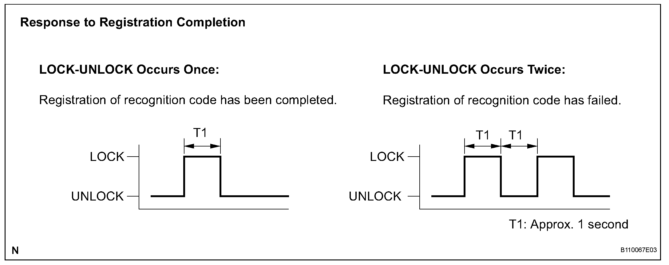

3. The body ECU automatically performs the power door LOCK-UNLOCK operation after the switch on the door control transmitter is turned off, in order to indicate whether registration has been completed correctly or not.
