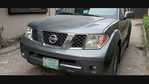

The remote still lock and open the doors but the horn that normally sound if you press the lock button to lock the doors. does not sound again while the light still flashes and secondly if one press the open button the light that normally flashes don't flash again to indicates that the door are open.
