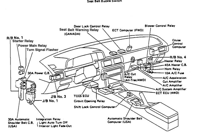

Hello my name is Dave.

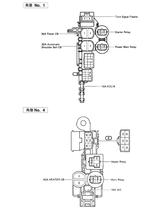

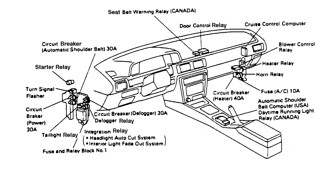

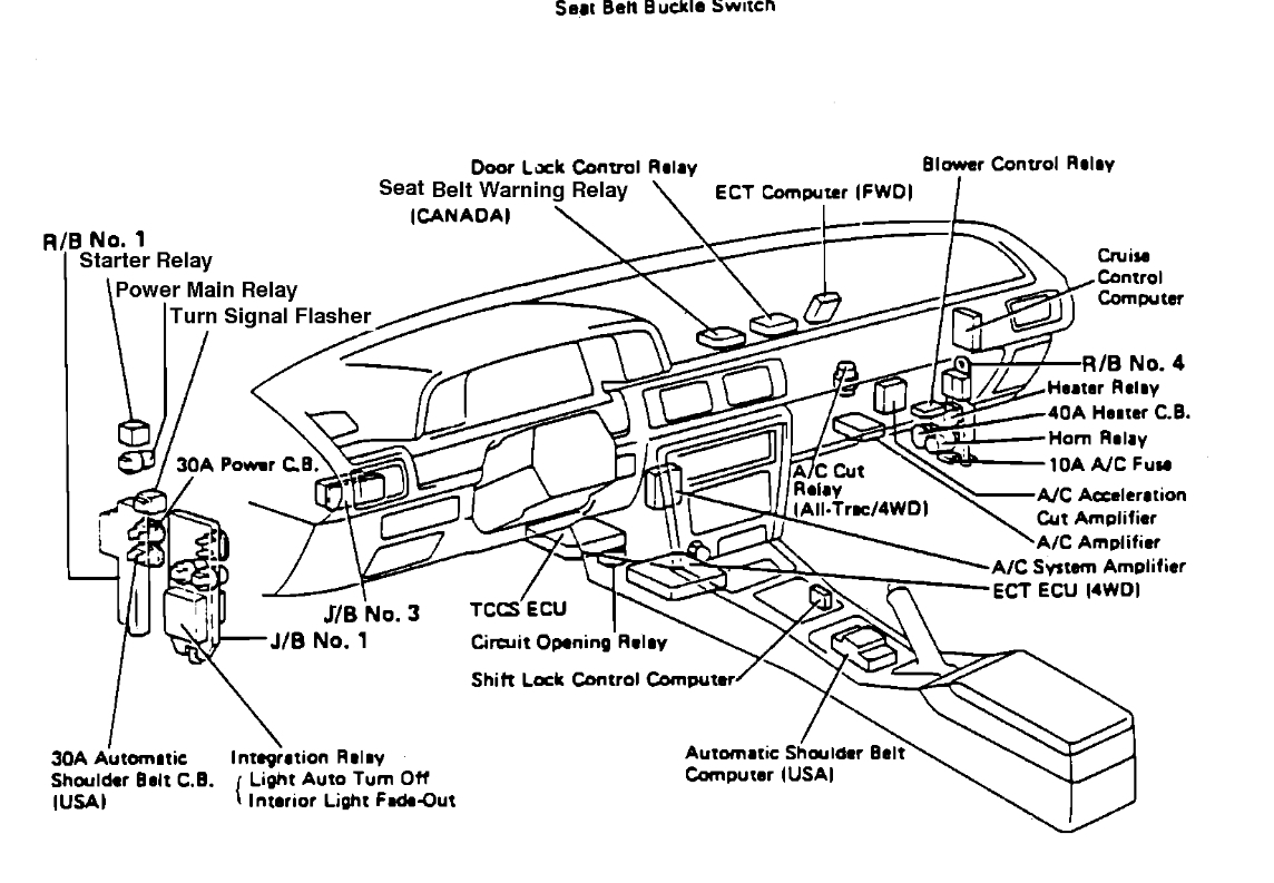

Your car has what they refer to as a circuit opening relay which is located on the ECU. however, I am interested to find out exactly what symptoms your car has as I have never had one of these go bad. Have you checked the ECU relay? I have attached a illustration showing the location of both of these relays. If you could let us know what symptoms you have we will be glad to help you further.

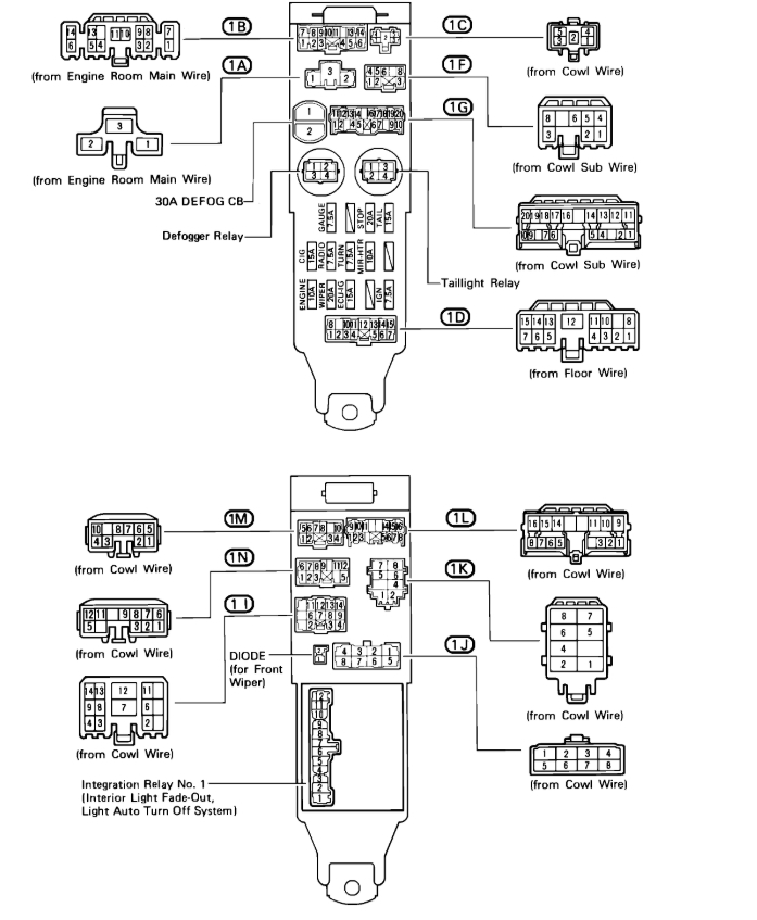

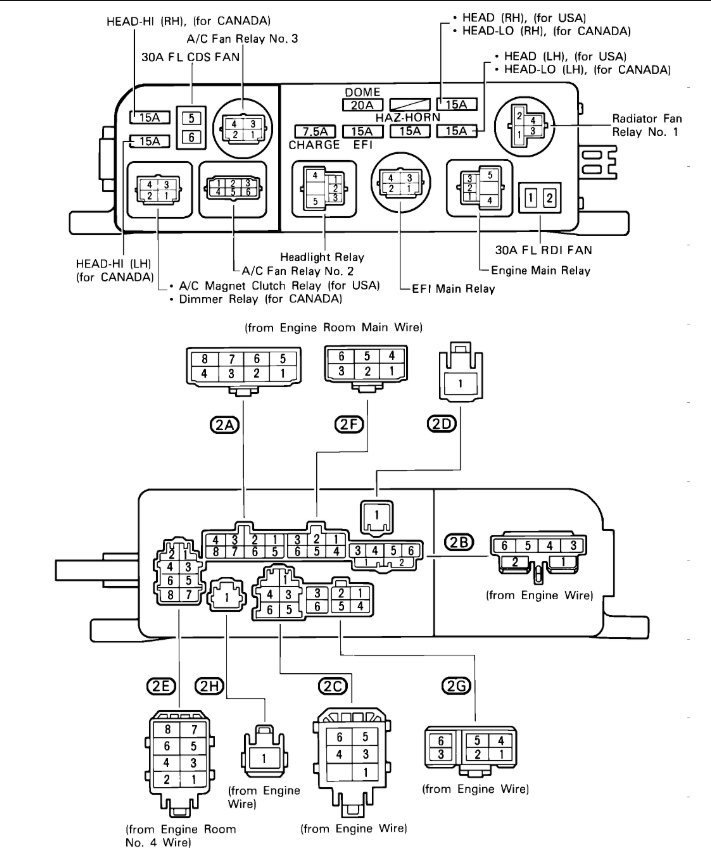

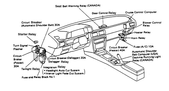

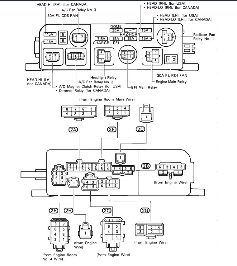

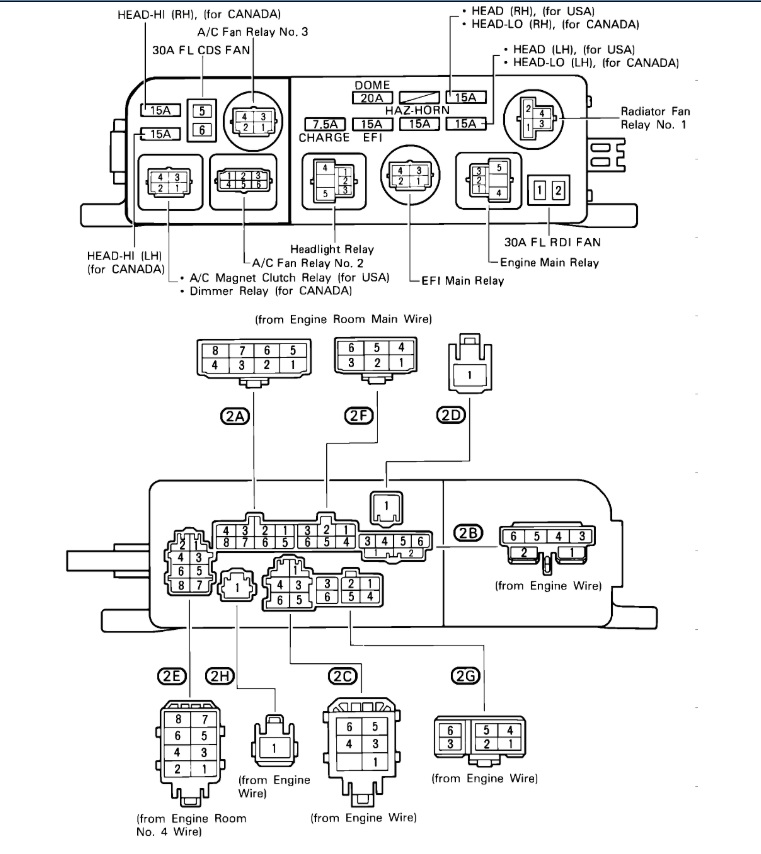

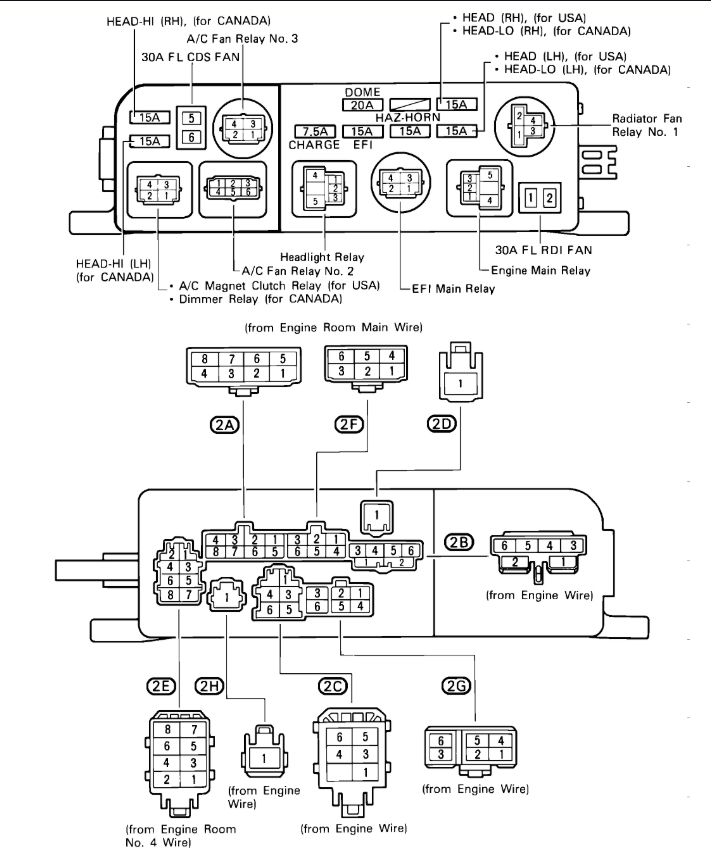

I just need a picture of the location of the fuse box all fuses that is related to the fuel pump that is all I need . Thanks
Mar 3, 2020 at 9:57 AM
Here is a guide to help you test the fuse and relays with the relay and fuse locations in the diagrams below:
