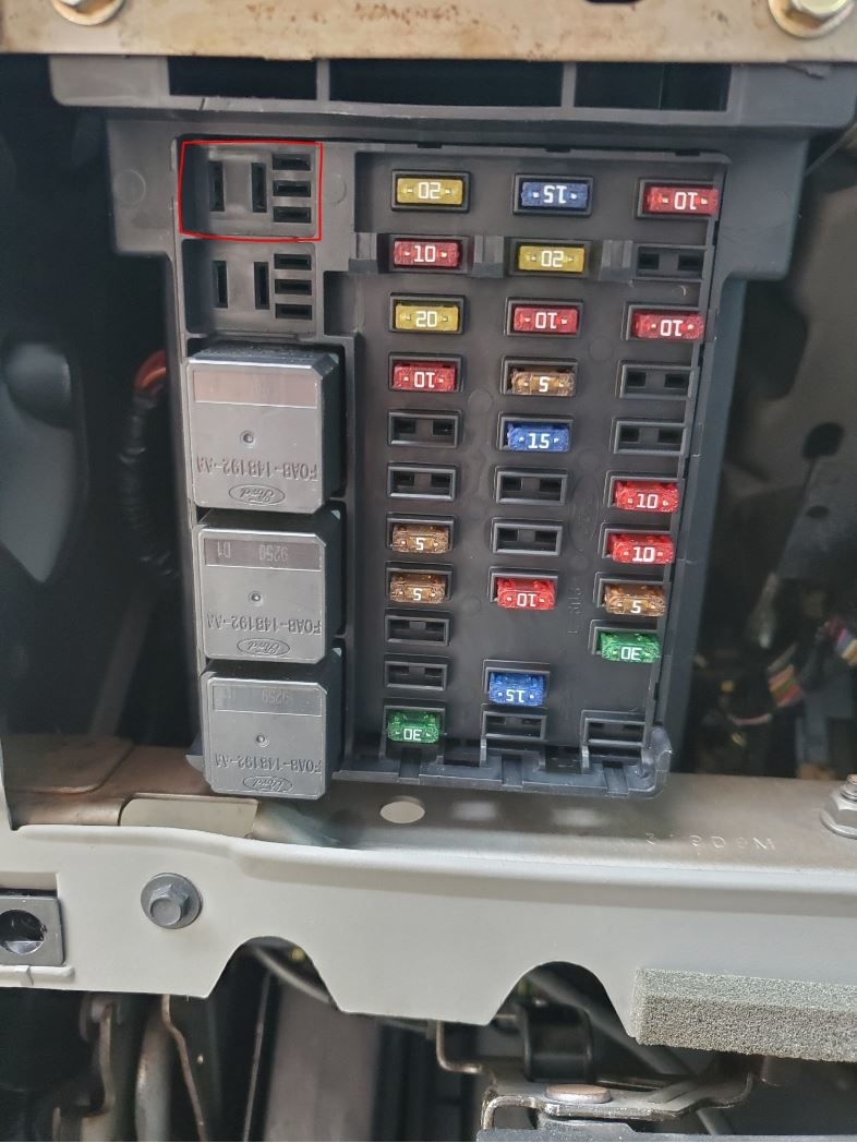

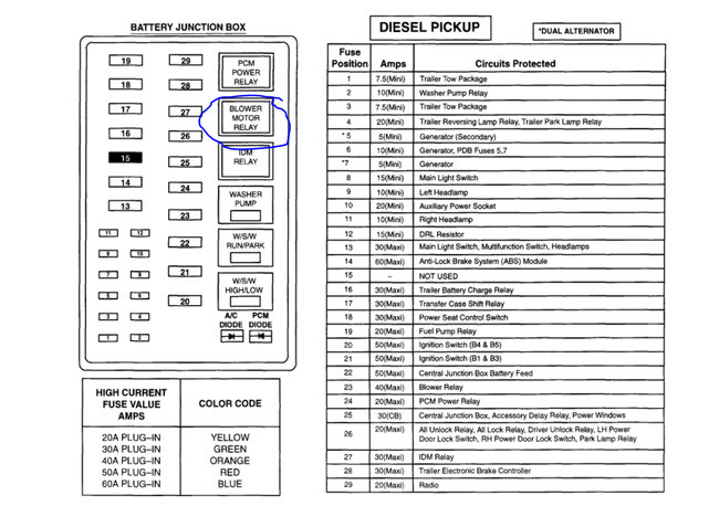

The relay that was buzzing (pictured below) is relay number 1 on the interior fuse panel inside the vehicle. This relay is labelled "interior lamp" and is not shown in the picture and I have removed it for testing.

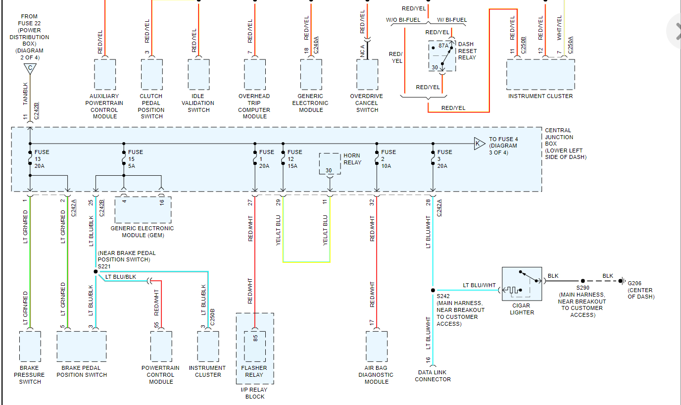

Good afternoon,

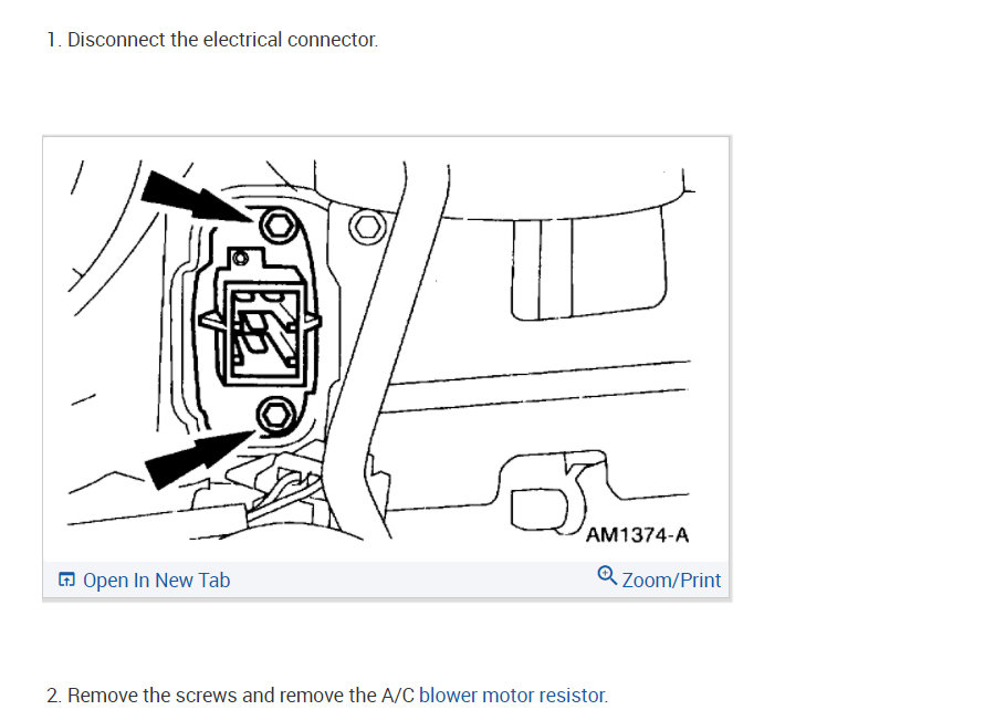

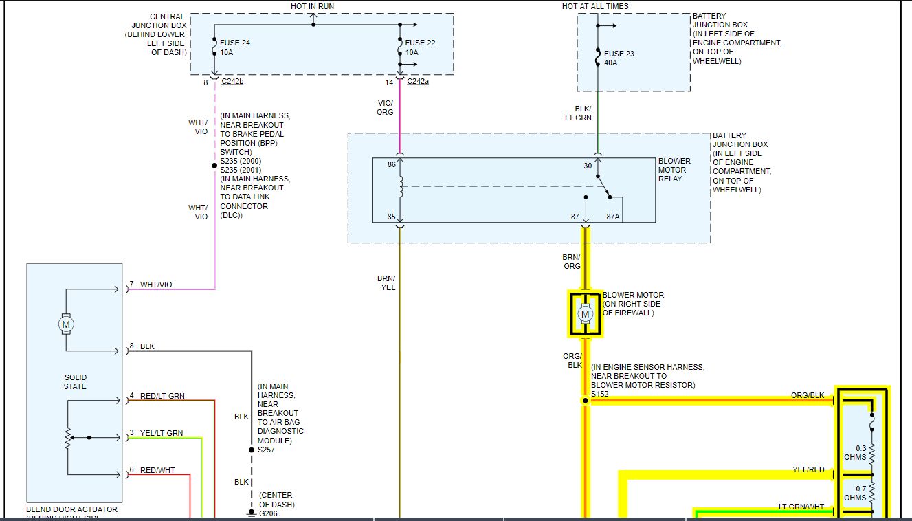

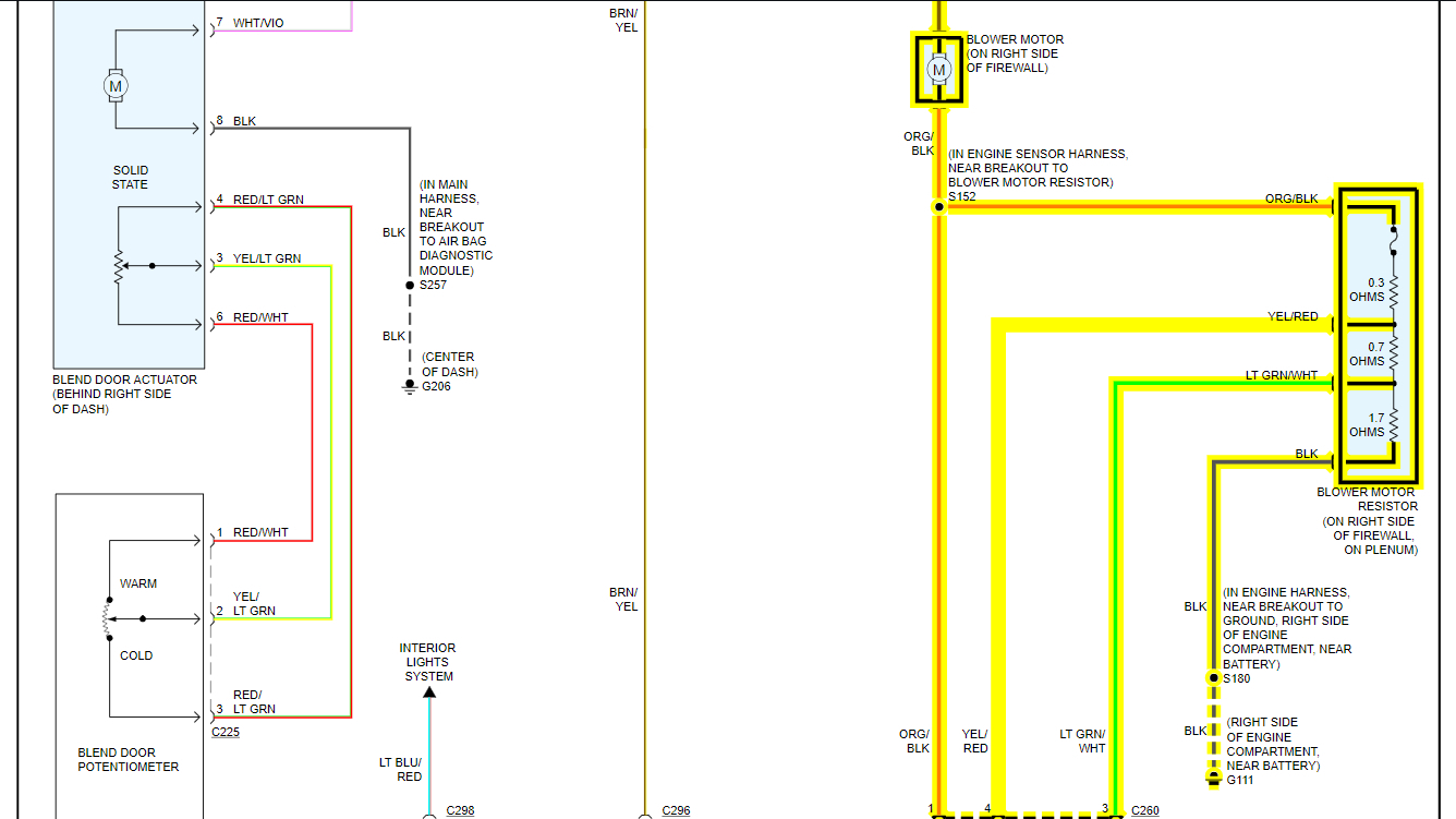

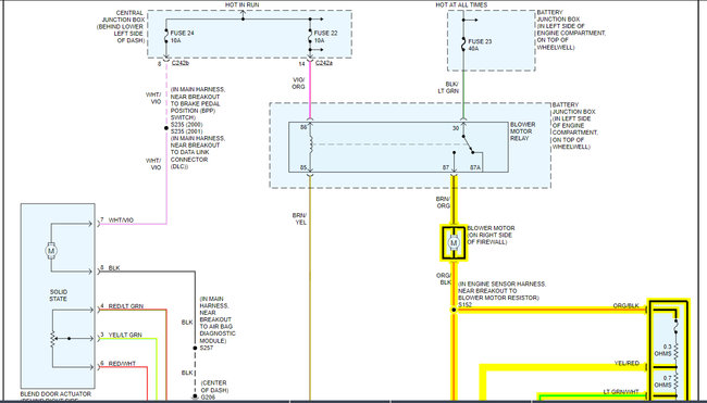

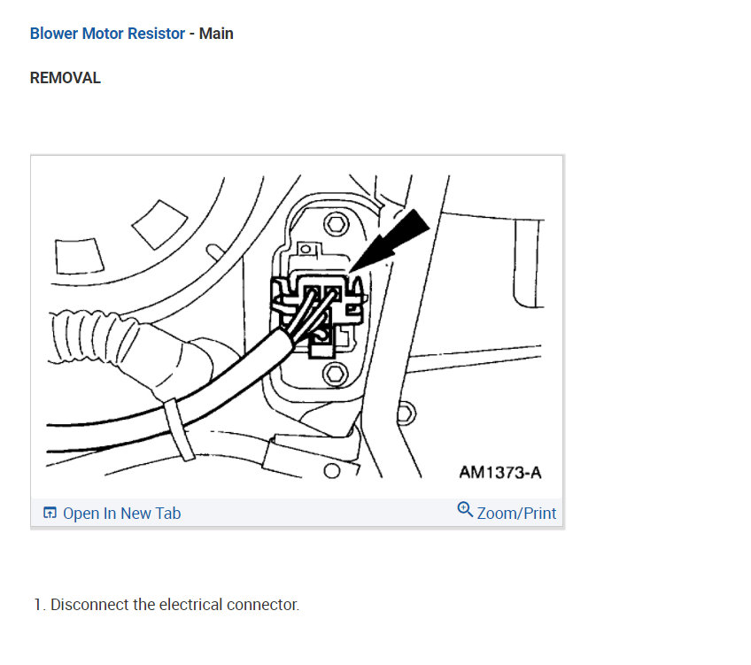

Go under the dash and disconnect the blower resistor and see if the issue stops.
The resistor may be shorted to power sending power all the time to the blower and the control head.

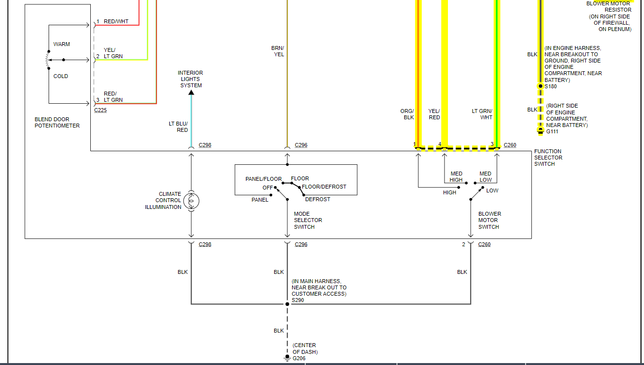

I attached the wiring diagram of the system. There is also a relay for the blower. Remove it as well.
Jun 21, 2021 at 2:15 PM

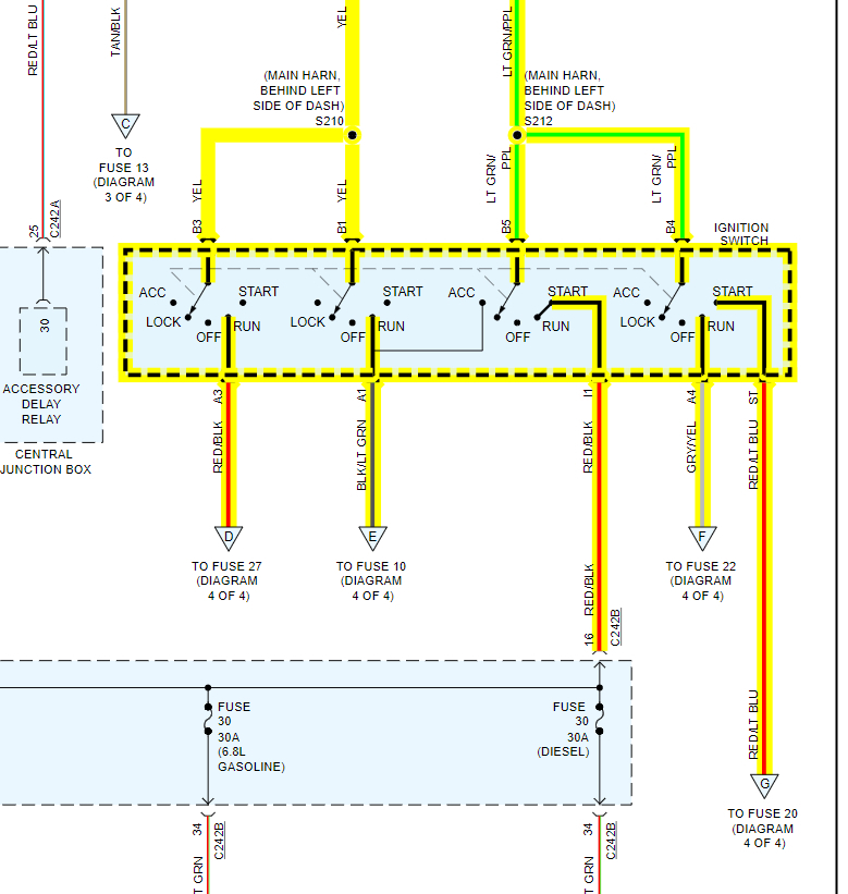

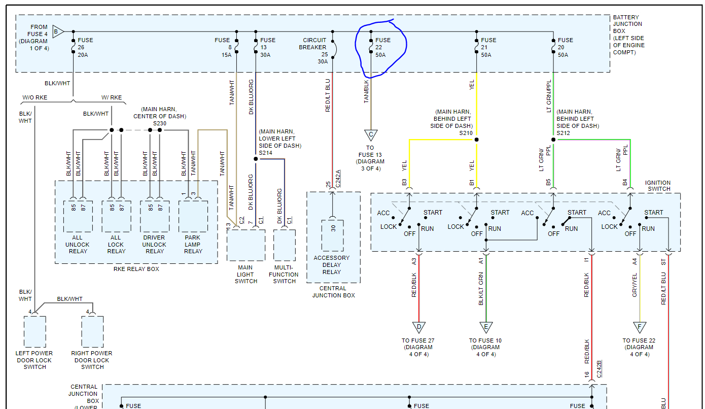

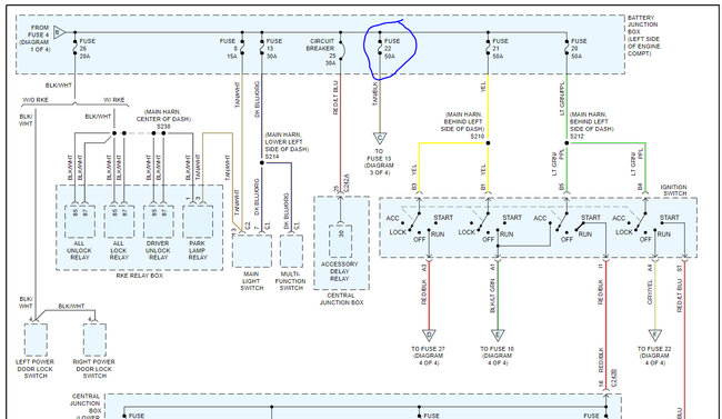

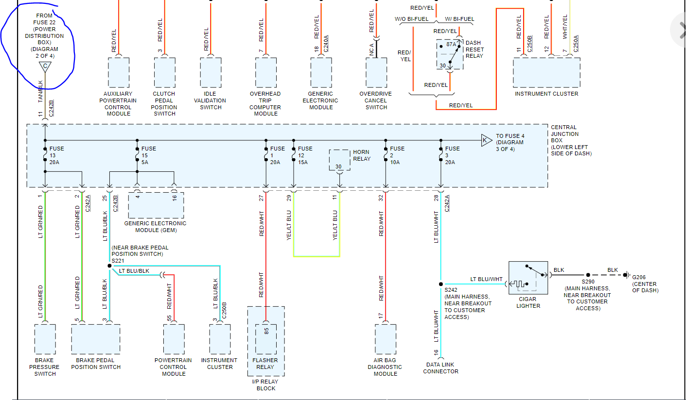

Roy, could you grab me the schematic for what feeds Fuse 22? This should only be hot when the key is on, and it is hot when the key is off. Can you help me trace this back? I have a feeling my issue might be in the CJB in the engine compartment.
Jun 22, 2021 at 9:06 AM
Okay, 22 feeds a lot of fuses. I attached the diagram for you to view.
If there is no power, the bus bar in the fuse block may be the issue. It would require removing it and either repairing it or replacing it.

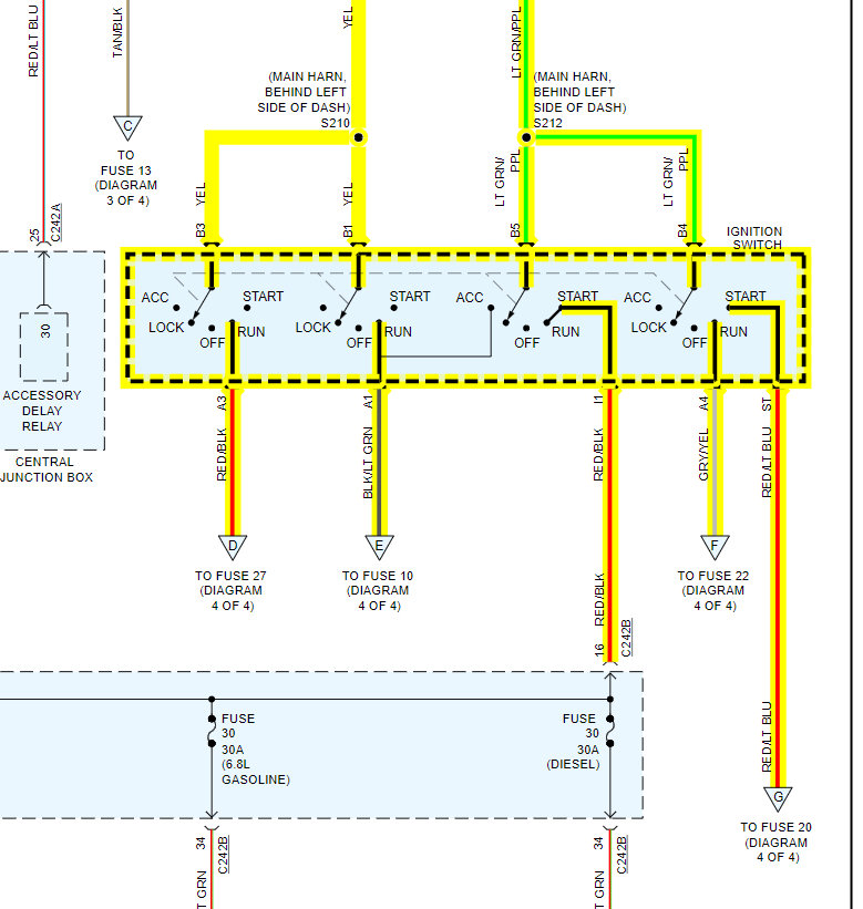

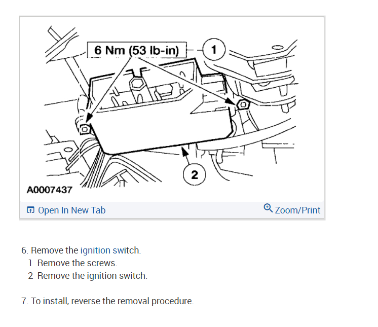

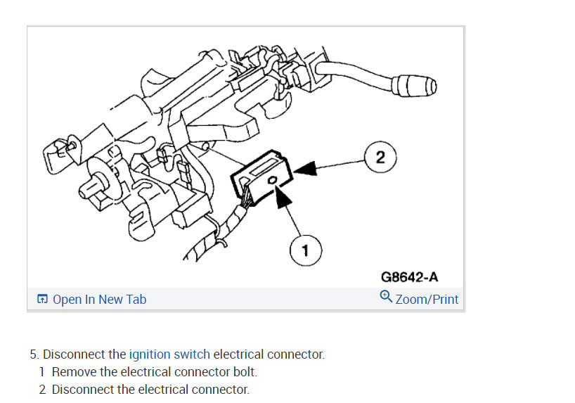

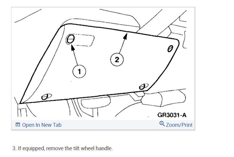

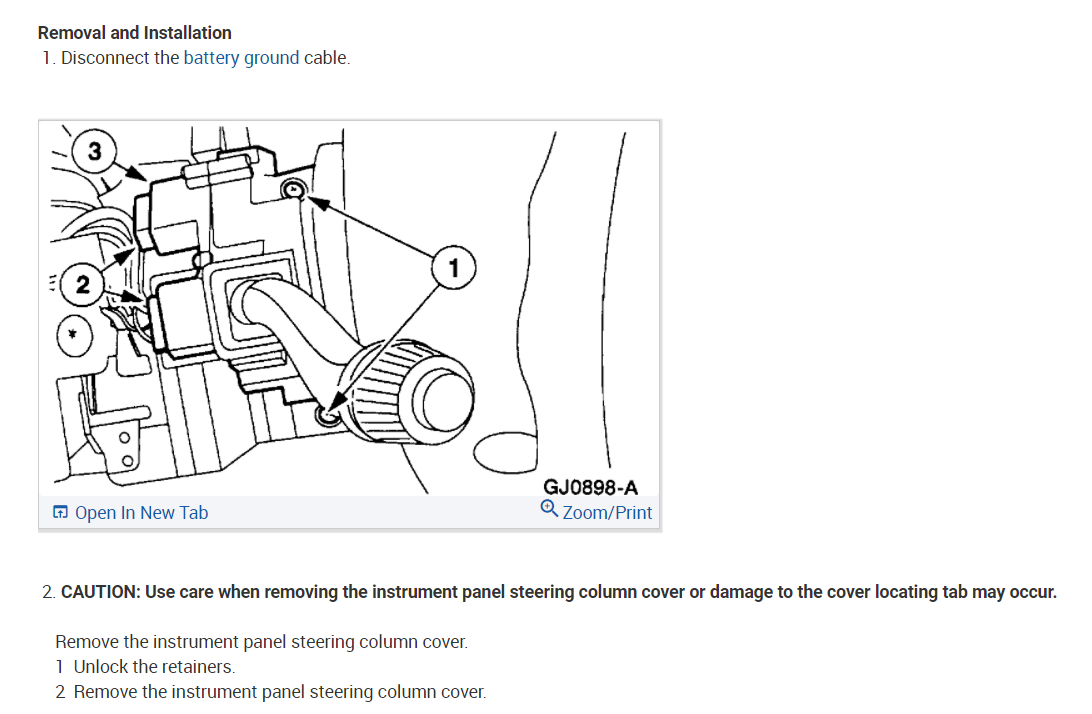

Actually I have the opposite problem. I have power to things that should have power only in "run" and "start" With the key "off", they should be dead. Instead I am getting power. I finally got back into Ford PTS and looked over the schematics. It appears to me that a probable cause could be the ignition switch. I don't have time tonight but I'm going to pin that out tomorrow and see if it has a short in one or more of the outputs for "run". Particularly pins A4 and B4.
Jun 22, 2021 at 6:18 PM

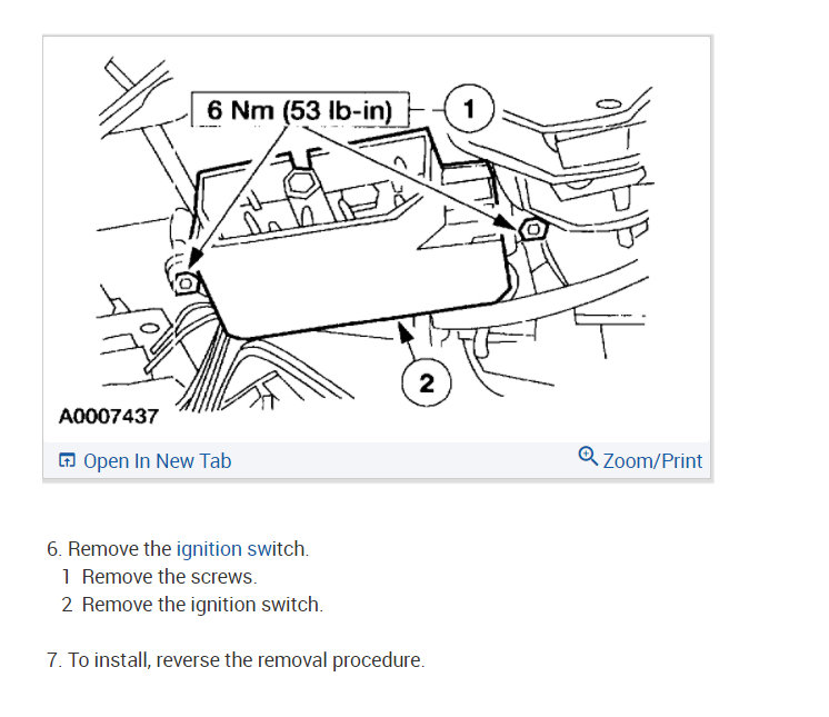

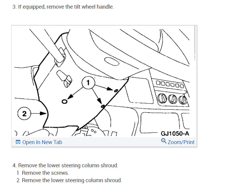

I attached the procedure for the switch below.
I also attached the diagram for the switch as well for you to check.
Let me know the results.
