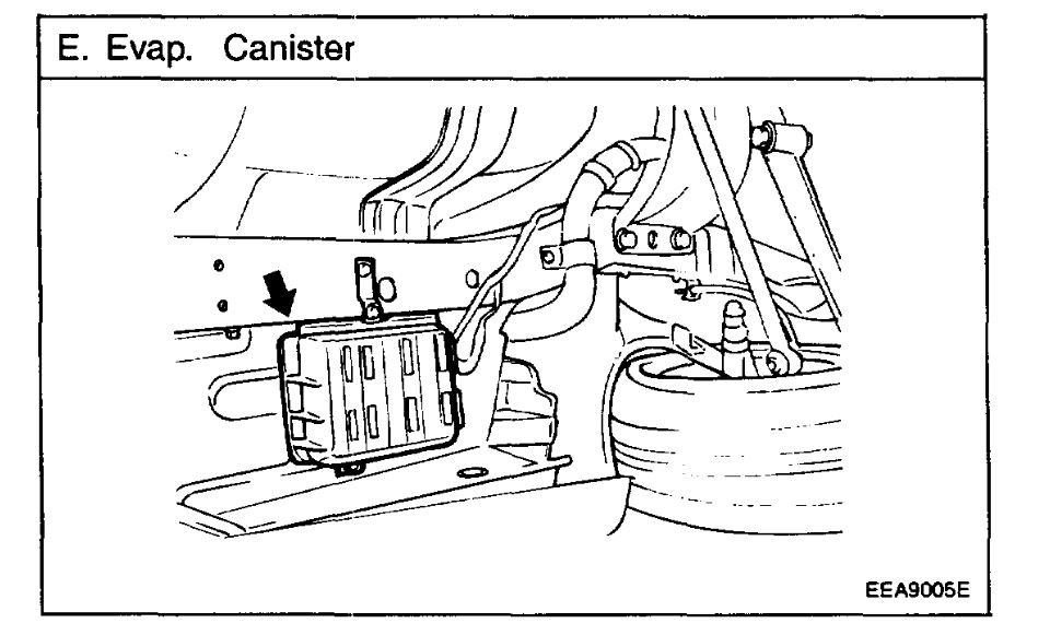

The issue I found for this is the canister back at the tank fills up with fuel after fueling it full. Then you try to start it the purge valve sucks raw fuel into the intake and floods the motor. Once you burn off all the excess fuel, it is good until the next time you fill up.

In the cars that I had this issue, I replaced the charcoal canister and the canister purge valve. Every car is different. I would have some verify this before assuming it is the issue. This is based on my experience repairing cars for over forty years.

That makes more sense than the TPS to me. So the charcoal canister is under the car?
May 6, 2018 at 6:46 PM
Correct. It is back by the fuel tank.
