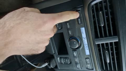

A/C does not blow cold no matter the settings. In this video I toggled the AC on and off twice.

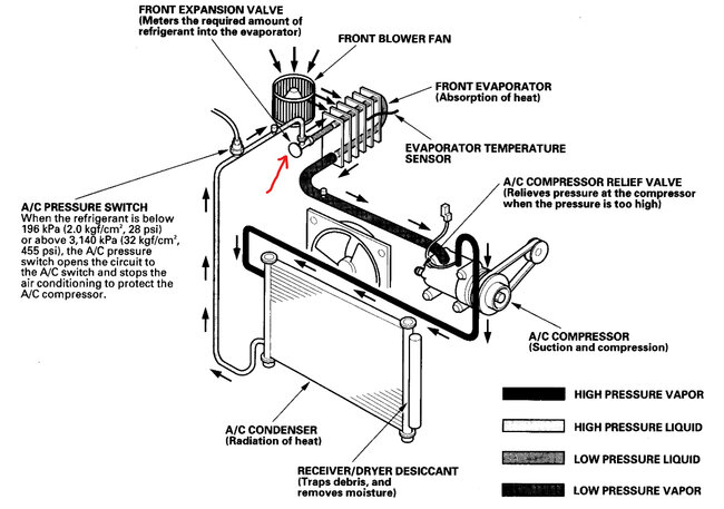

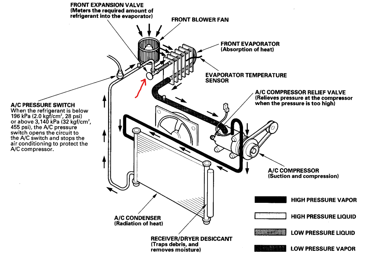

Wow, that is a good one, have not heard that before but I would have to say the expansion valve is stuck wide open which will make this kind of sounds. Can I ask if any AC work has been done lately? Also, have you tried added refrigerant? Here is the part that has failed, please go over this video and I have included the location and the instructions on how to change the expansion valve out. Thanks for the video, it helped.
https://www.youtube.com/watch?v=4EqdrBVb0sY&t
Here is the valve location. Have a nice thanksgiving, check out the images (below). Please let us know what happens.
