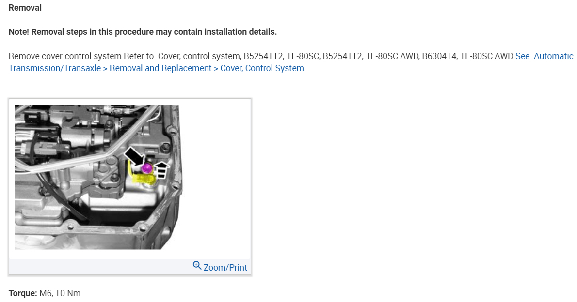

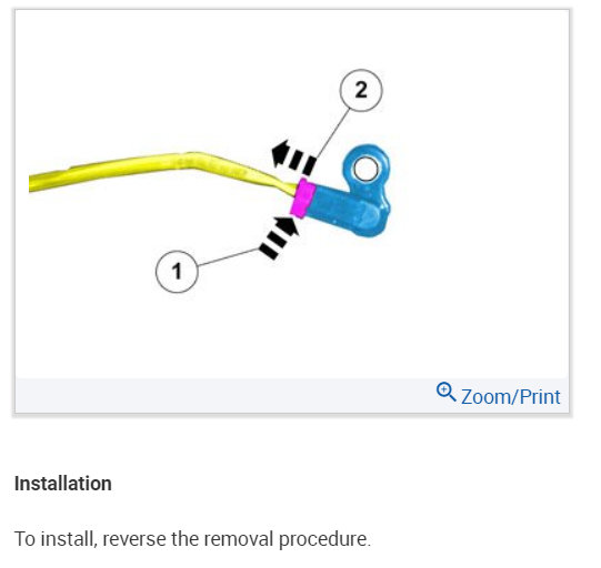

This sounds like you have a transmission turbine sensor that has gone out or is not reading correctly. Lets run the codes first to see what comes up.
Here is the location of the sensor (below).
