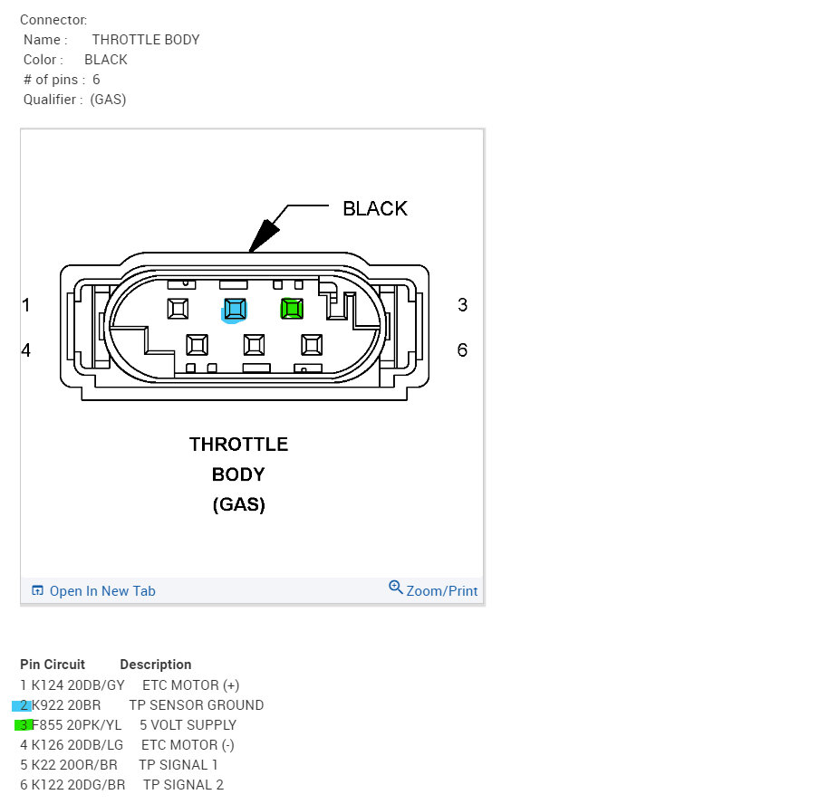

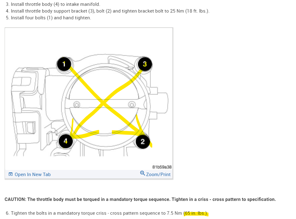

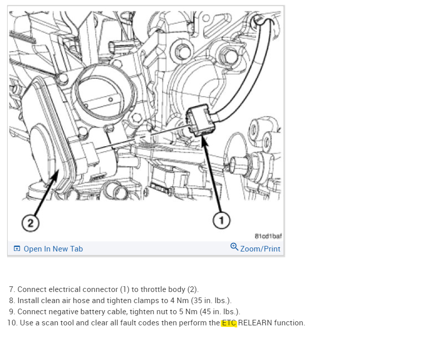

Hello, what codes are set in the engine computer? Also did you torque the throttle body correctly and do the ETC Relearn procedure with a scan tool?
If you have done the relearn procedure, you can check for the 5vRef from pin 3 to ground on pin 2 (diagram3).
