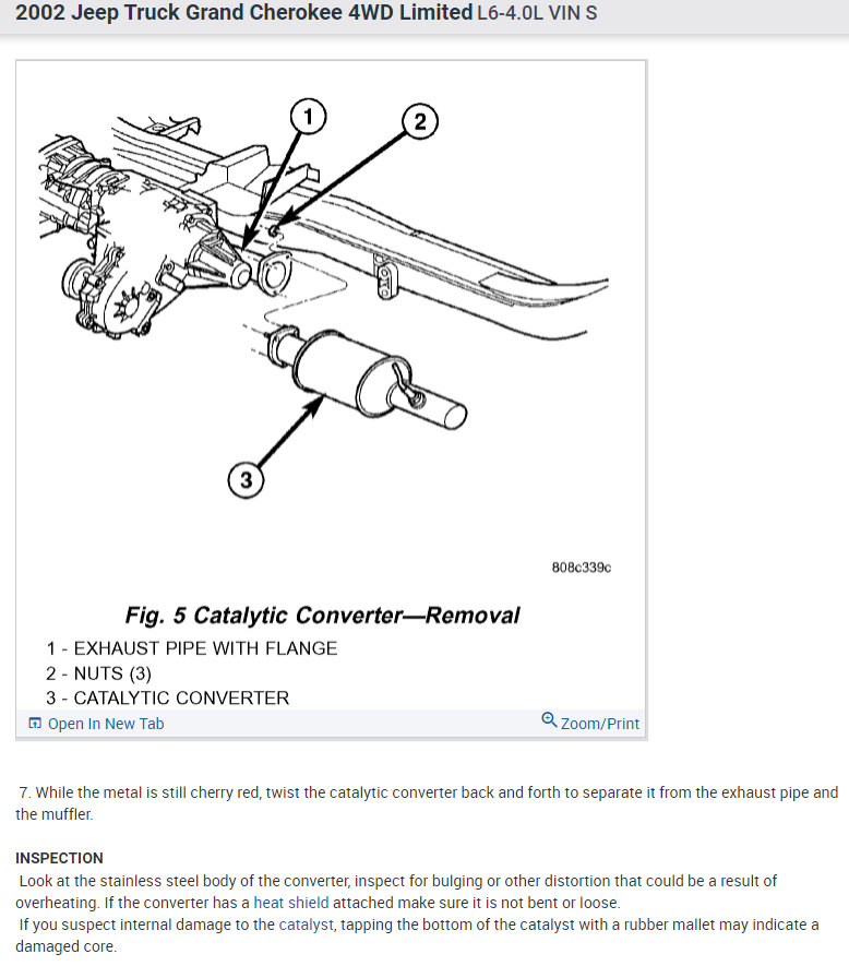

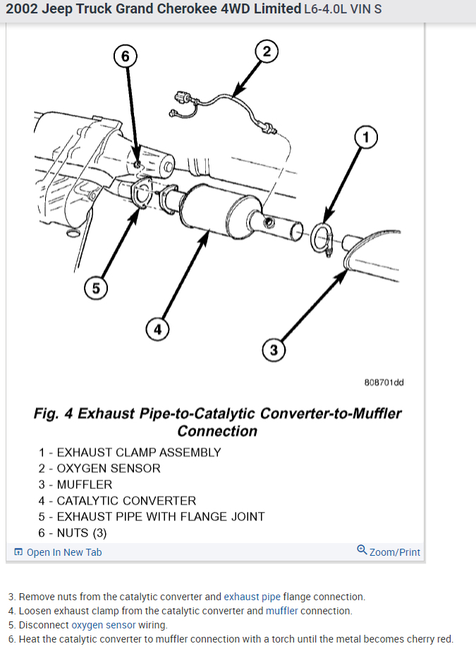

Typically you will have an overheated exhaust component if there is a restriction.
If the exhaust gases cannot escape properly it will build up pressure and heat inside the system.
Usually the restriction is just after the overheated component.
You can use a infrared heat gun to find the spot where there is a significant temperature change, as likely the restriction is right before that spot.
There is a good change you might have a clog/restriction right after that converter.
As you know the internals of the converters can come loose and restrict the air flow.
https://www.2carpros.com/articles/bad-catalytic-converter-symptoms
You might have to take off that pipe to have a look.
