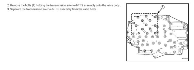

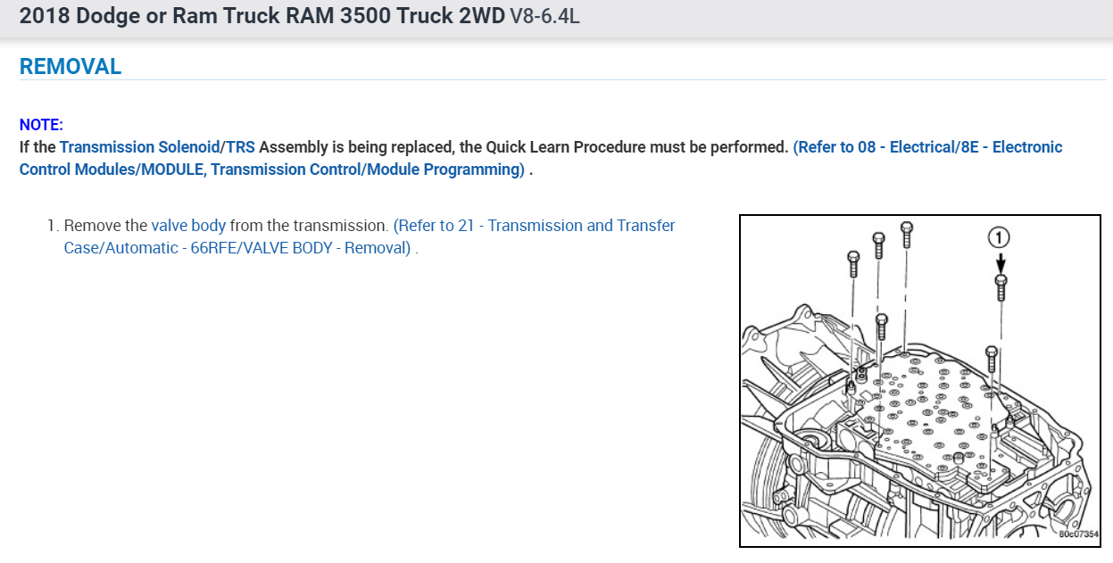

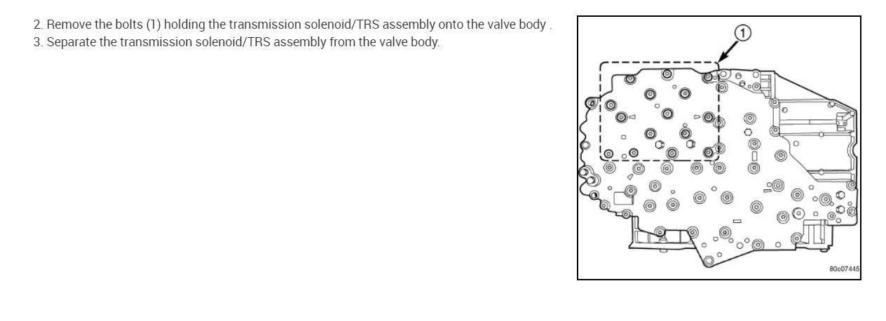

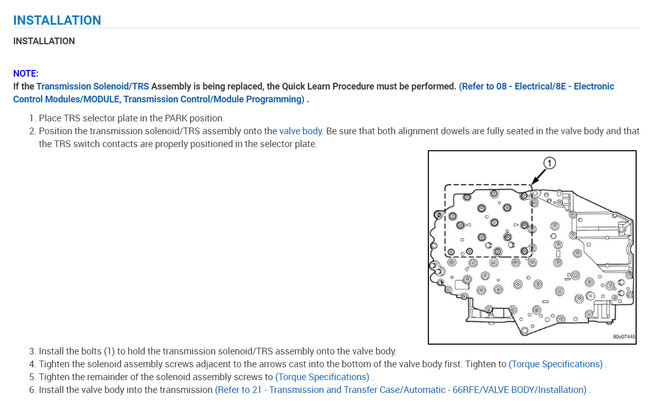

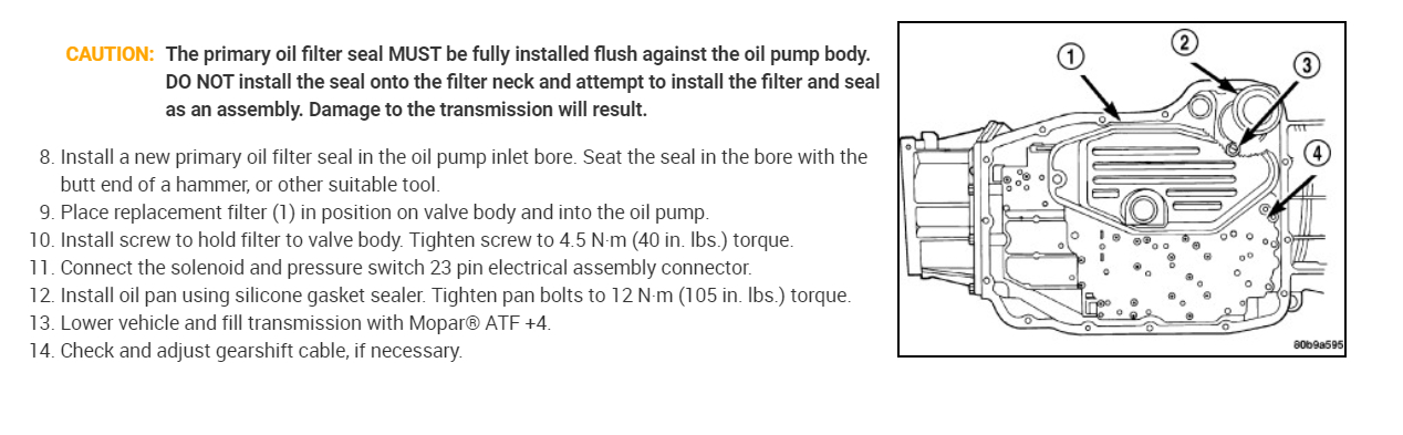

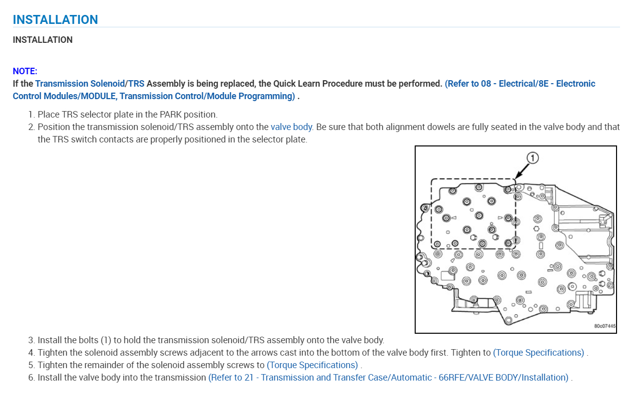

P0708 code - a malfunction with the transmission range sensor. This is a common problem here is the location of the sensor so you can change it out (below). Here is information on how to help the new sensor relearn which will help the shifting pattern.
