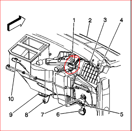

My fresh air/recirculating module is stuck halfway open.
Where is it located?

The re-circulation actuator is located on the top center of the HVAC unit. I have attached a picture of what it looks like (circled in red), and a link on how to replace. Hope this helps and feel free to ask any questions if needed. Thanks for using 2CarPros.

The directions are not for the correct module replacement.
