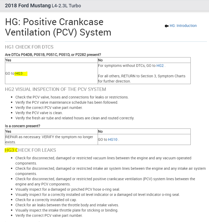

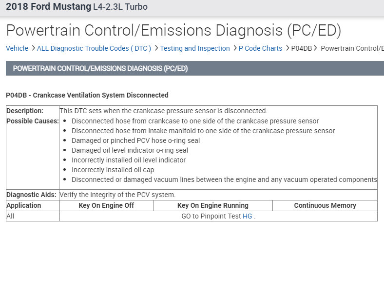

I have the car listed above eco boost, with only a cold air intake installed. I was driving home from work and the check engine light came on. So, I plugged in my OBD reader and the code P04DB appeared, and it says Crankcase Ventilation System Disconnected. Any idea what I can change or mess with to fix?
