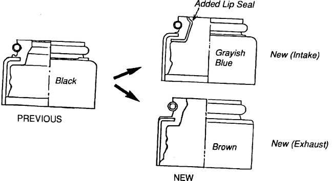

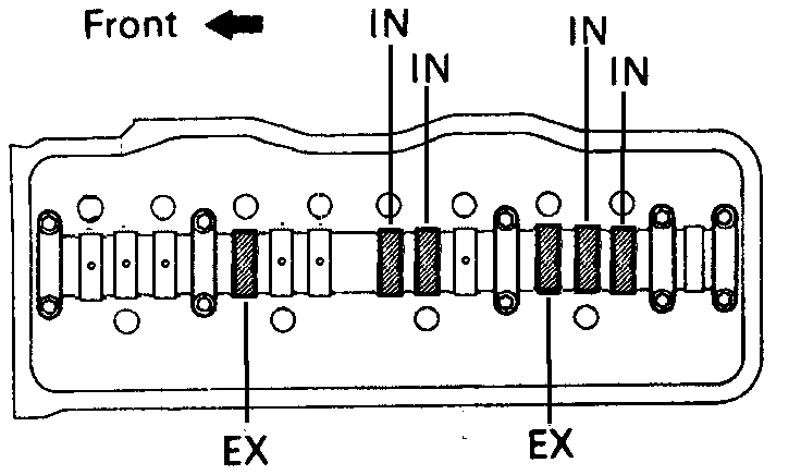

see pic 1

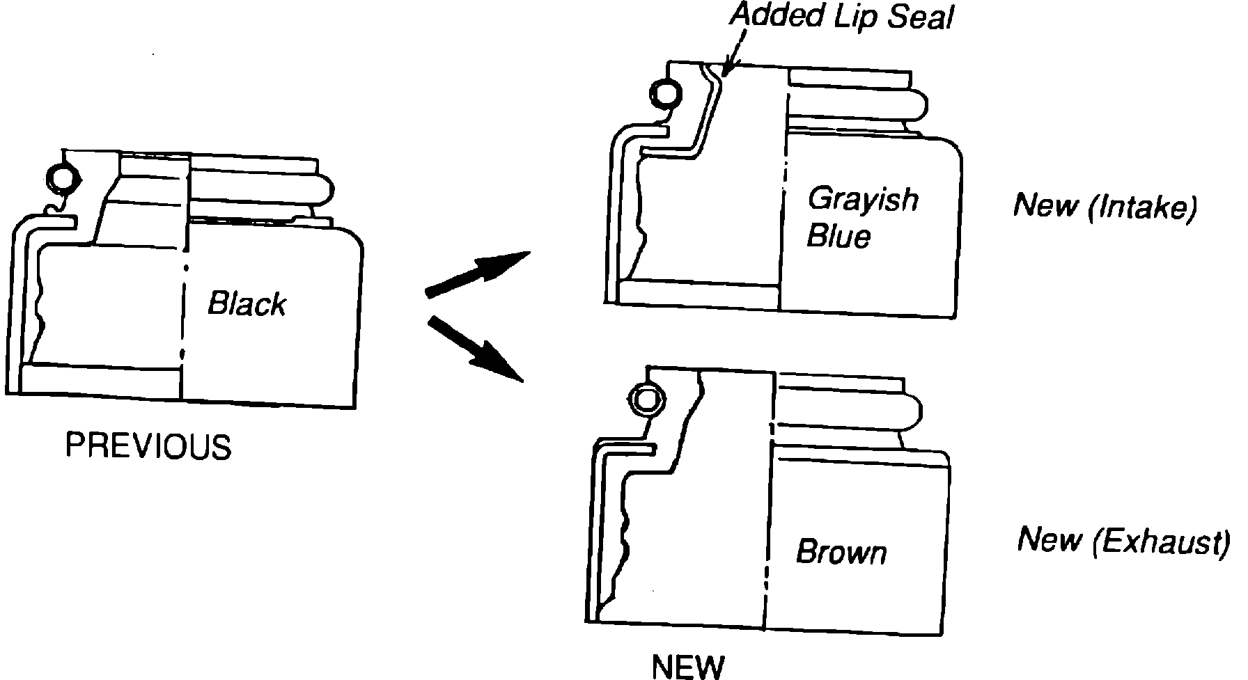

To reduce oil leakage the design of the valve stem oil seal has been changed. New valve stem seals can be identified by their color as shown.

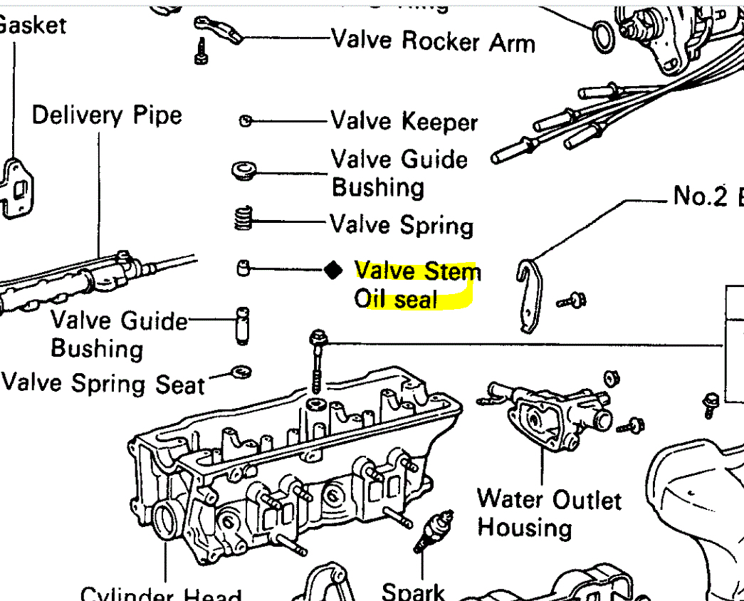

If you look at pic 2, it shows where this seal is located.

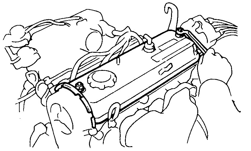

pic 3

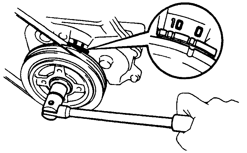

3. Turn the crank pulley and line up it's groove with the "0" mark on the No.1 timing belt cover as shown.
4. Check that the No.1 cylinder rocker arms are loose and No.4 cylinder rocker arms are tight. If not, turn the crank one complete revolution and line up the marks again as above.

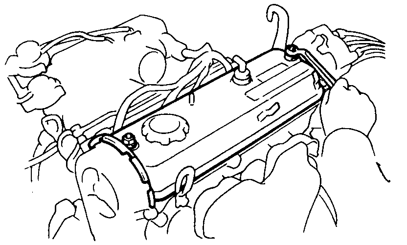

pic 4

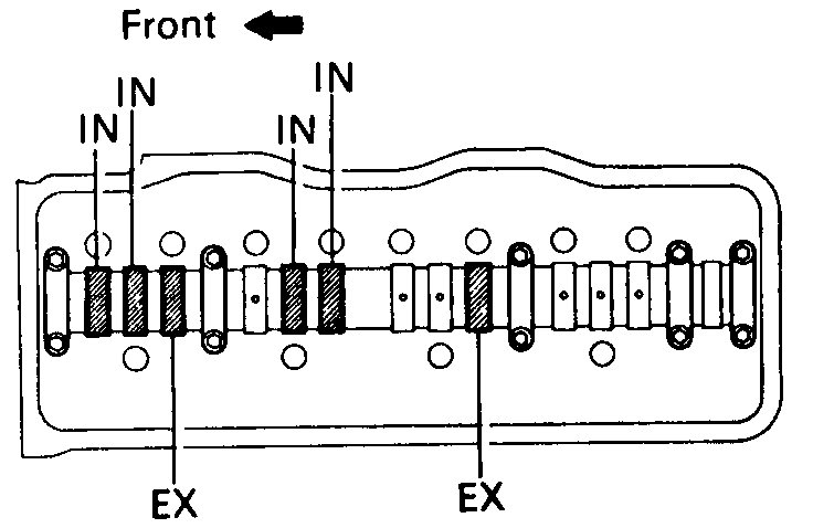

5. Measure only the valves shown above.

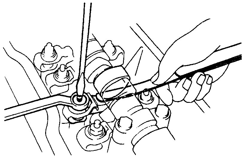

pic 5
6. Using a feeler gauge, measure the gap between the cam and rocker arm.
7. Loosen the lock nut and turn the adjusting screw to set clearance.
Clearance:
Hot: 0.20 mm (0.008 in.)
Cold: 0.18 mm (0.007 in.)
Hold the adjusting screw in position and tighten the lock nut.
8. Recheck clearance, feeler gauge should move with a very slight drag.

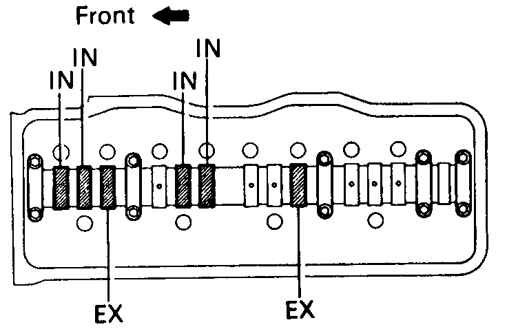

pic 6
9. Turn crank one full revolution and adjust remaining valves.

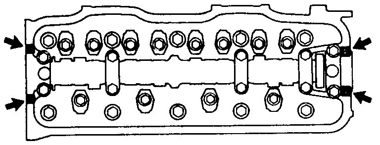

11. Apply seal packing No. 08826-00080 or equivalent to the cylinder head as shown above and install valve cover as soon as possible.
