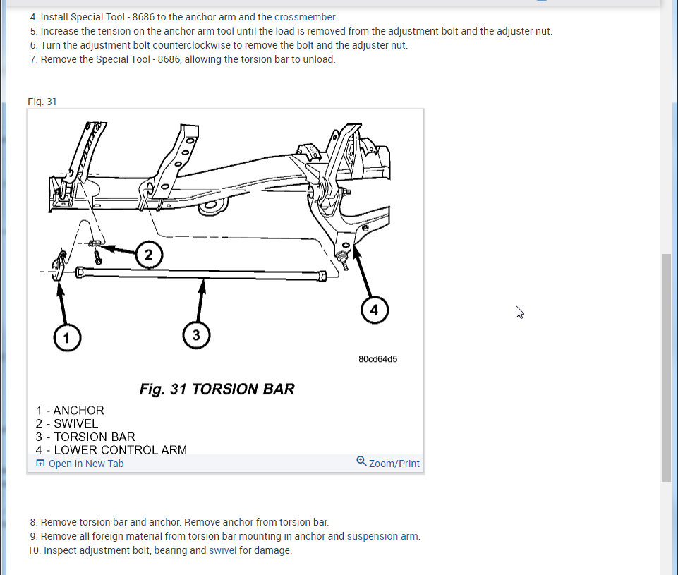

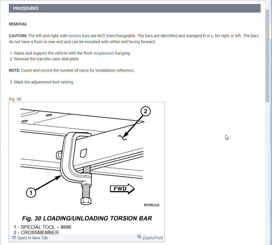

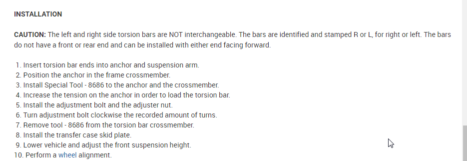

replaced lower and upper control arm shock wheel hub and sway bar link on right front. finished it was to low about 3 inches lower than left side. jacked it back up torsion bar and key wont line up and when we get it to line up it's too loose. need help in figuring this out. It's my only driver and been down 4 weeks. thanks
