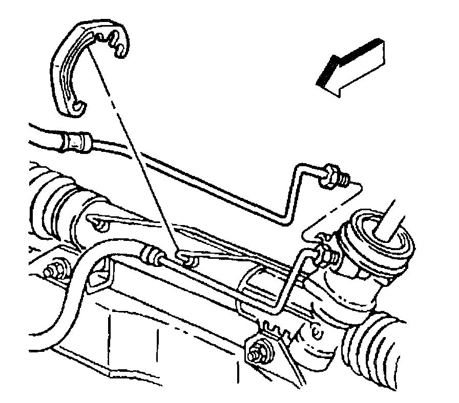

1. Place a drain pan under the vehicle.
pic 1

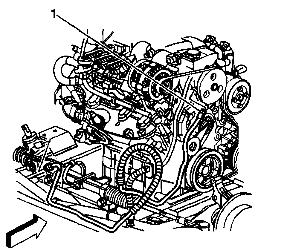

2. Remove the power steering pressure line from the power steering pump.
3. Remove the power steering pressure line from the power steering lines retaining bracket on the engine.
pic 2
4. The power steering pressure line is the lower line at the power steering gear.

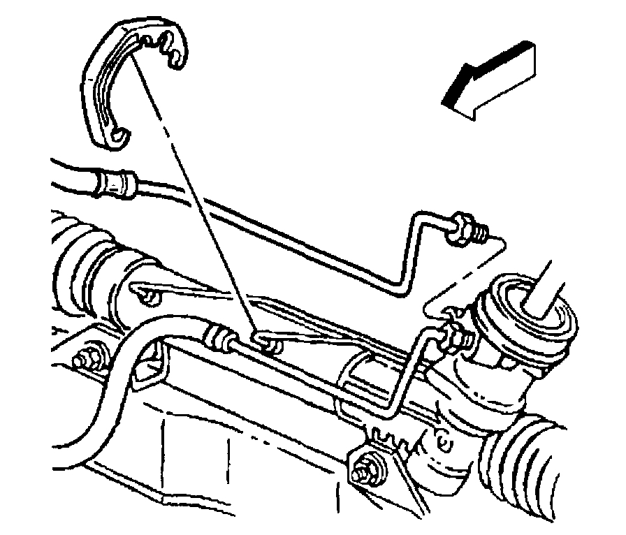

5. Raise and suitably support the vehicle. Refer to Vehicle Lifting.
pic 3
6. Remove the power steering pressure line (1) from the clamps on the power steering gear.
7. Remove the power steering pressure line (1) from the vehicle.

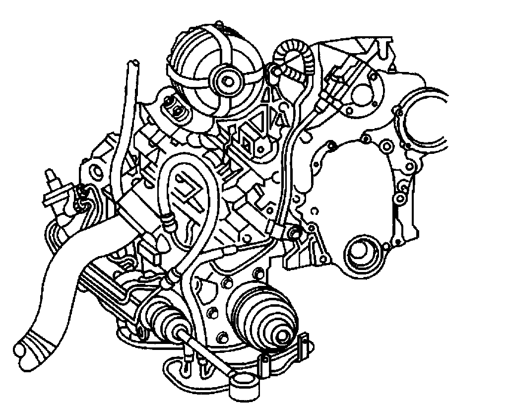

1. Install the power steering pressure line (1) to the vehicle.
pic 4
2. Install the power steering pressure line (1) to the clamps on the power steering gear.
