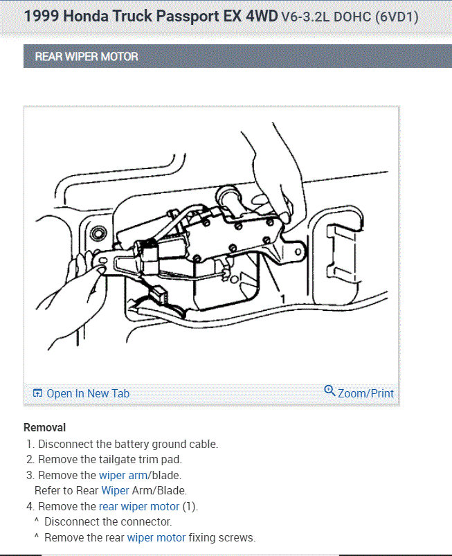

How can i remove the wiper motor to replace it?
