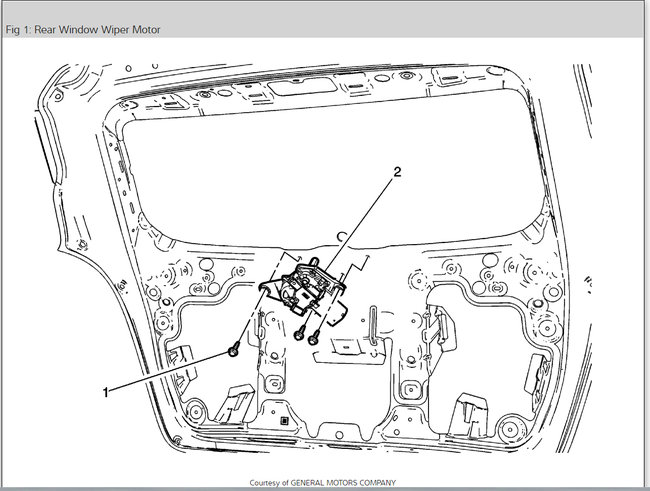

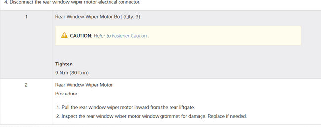

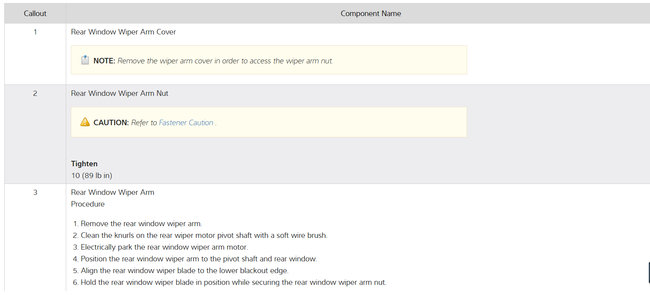

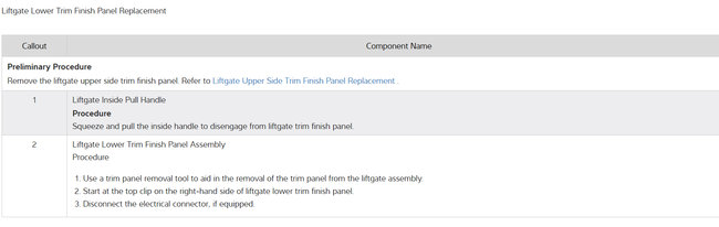

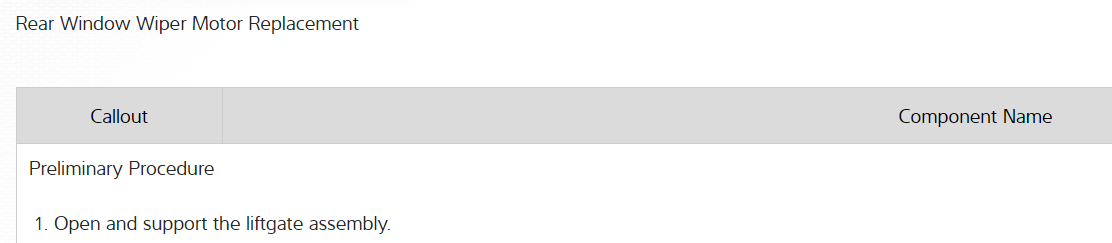

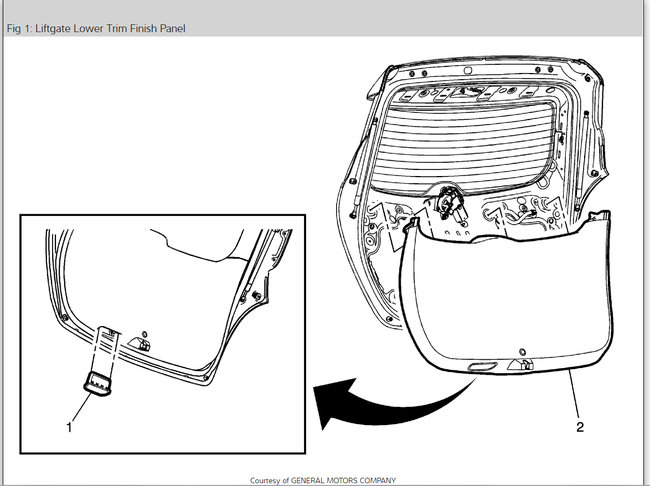

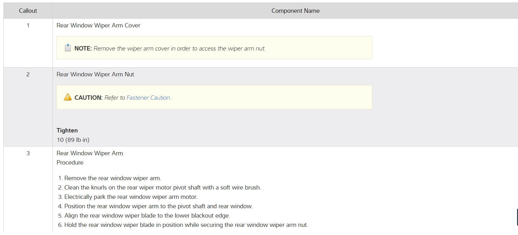

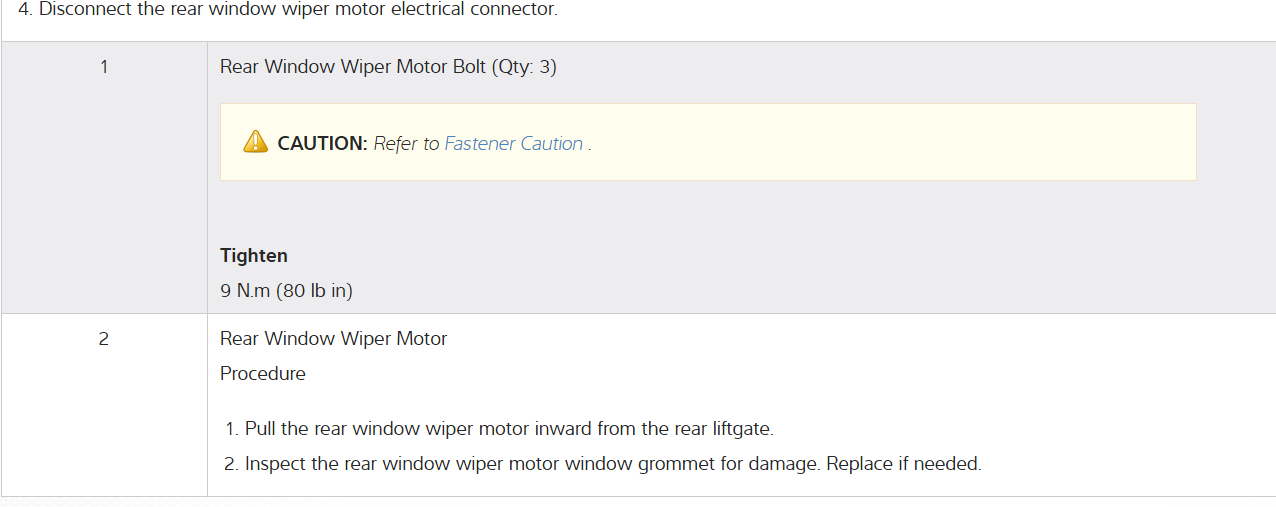

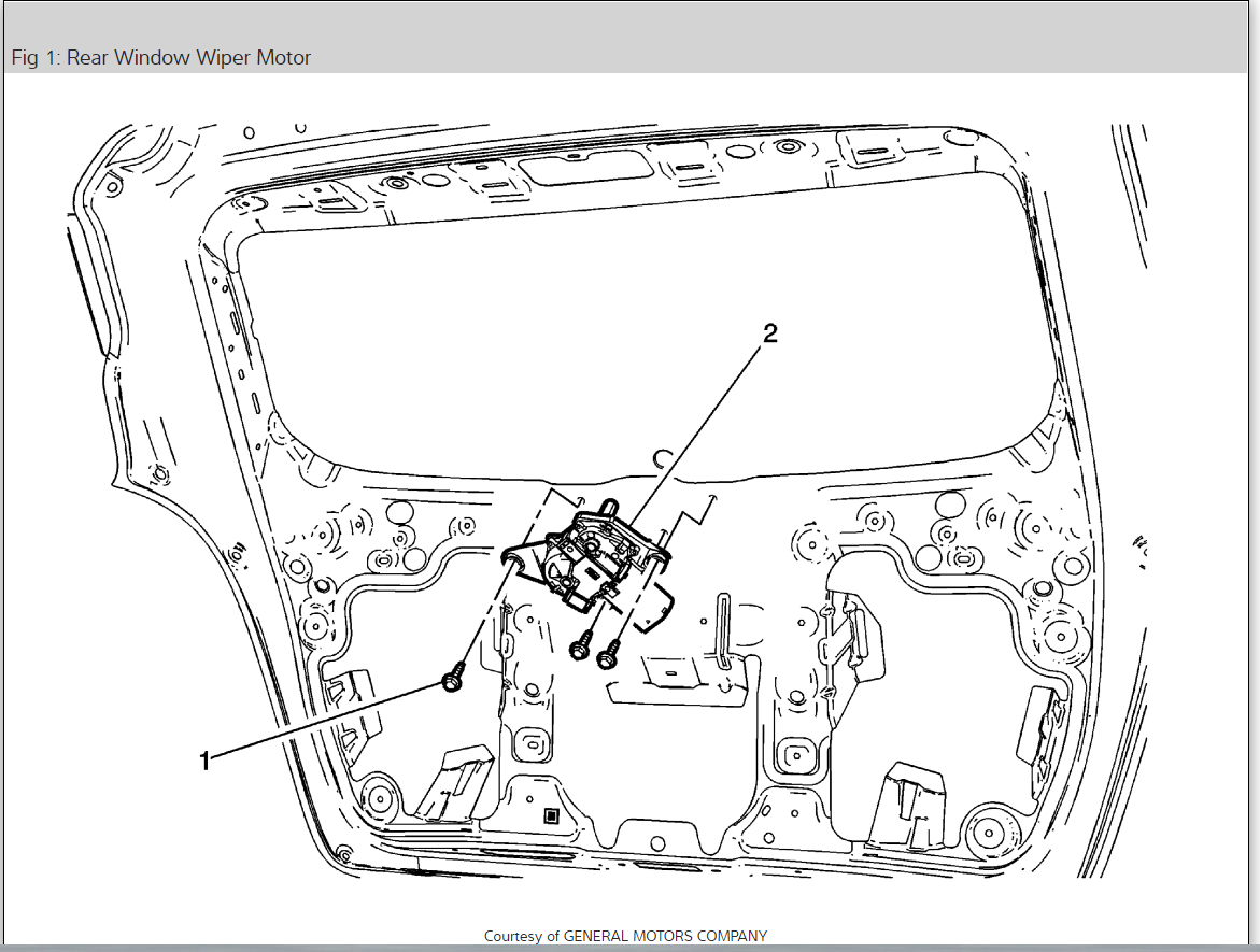

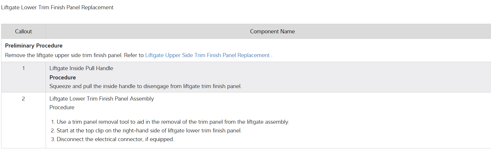

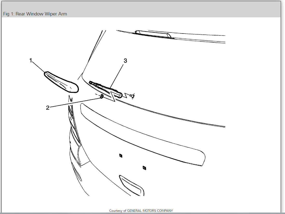

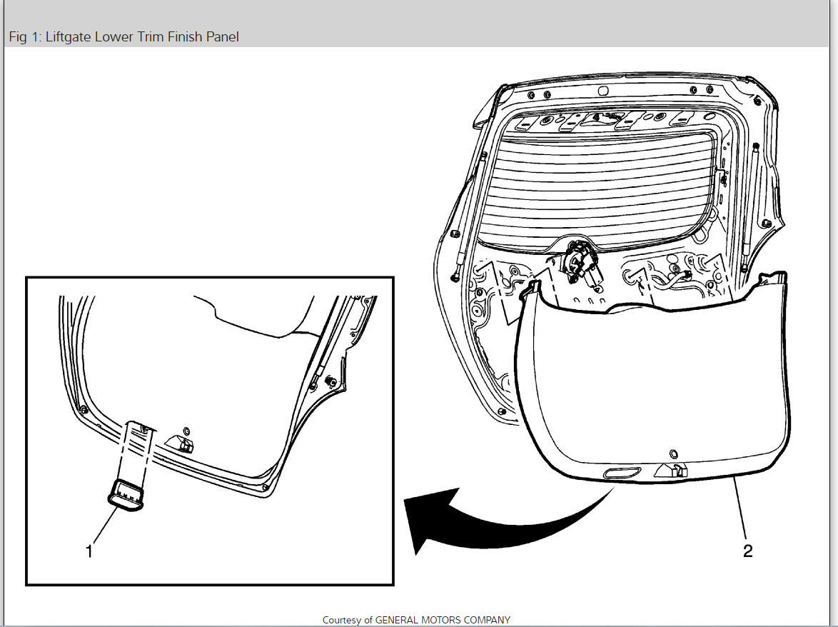

This sounds to me like your wiper are may have been bent. If not then it sounds like your wiper motor may be going out. Down below I have included step by step instructions on how to replace it.
Alex,
