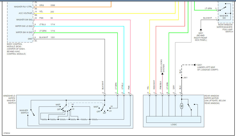

It sounds like you might have an open wire in in the rear wiper motor circuit. Here is a tutorial showing how to test electrical wiring:

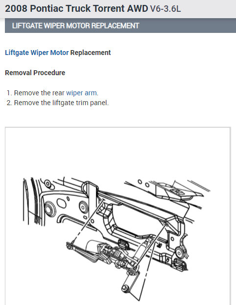

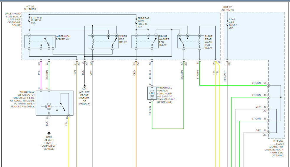

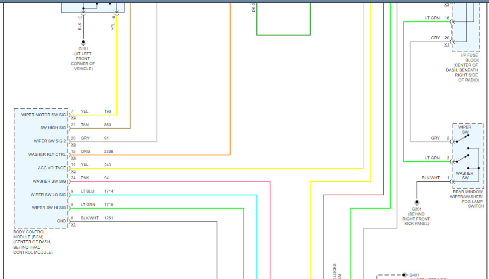

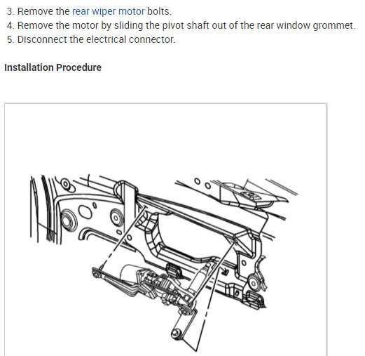

I've attached picture steps below on how to replace the rear wiper motor on your Torrent. I've also attached the rear wiper motor wiring diagram below and cut it into 3 pieces so you can view larger. Hope this helps and thanks for using 2CarPros.
