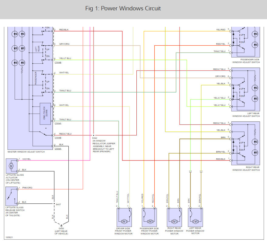

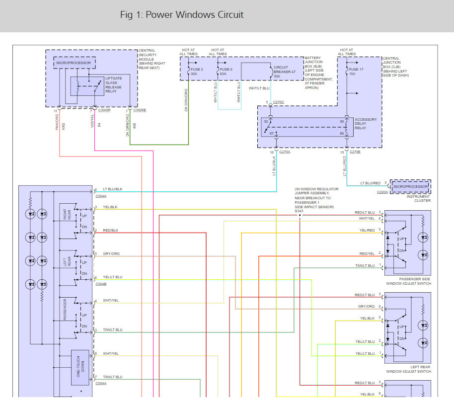

The rear windows will not go down when pressing the master button or each of the back buttons, the front windows operate normally. Any ideas?
Aug 4, 2018 at 6:05 PM
CERTIFIED EXPERT
53,854 POSTS
Hey Doug, it sounds like the master switch has gone bad which is where the power runs through of the rear switches. Here is a guide to help you test and replace the master switch and wiring diagrams so you can see how the system works:
