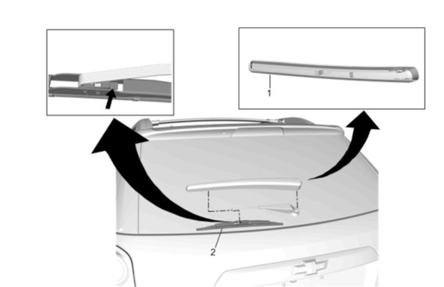

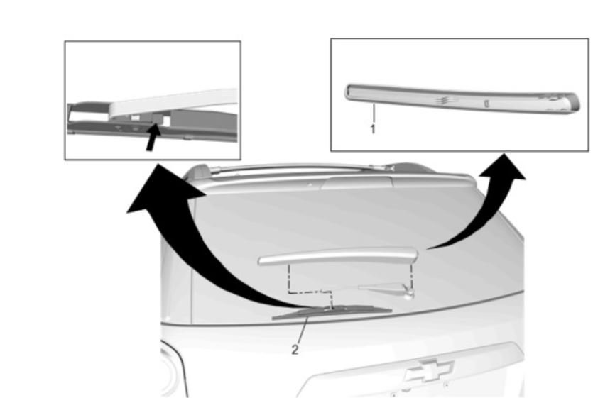

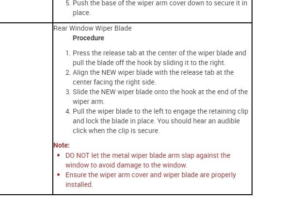

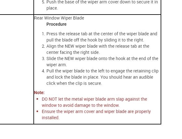

Good afternoon,
Procedure attached along with a picture. It is a little tricky but is actually easy once you find the release clip. Check out the diagrams (Below). Please let us know if you need anything else to get the problem fixed.
