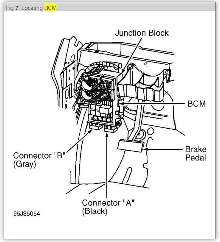

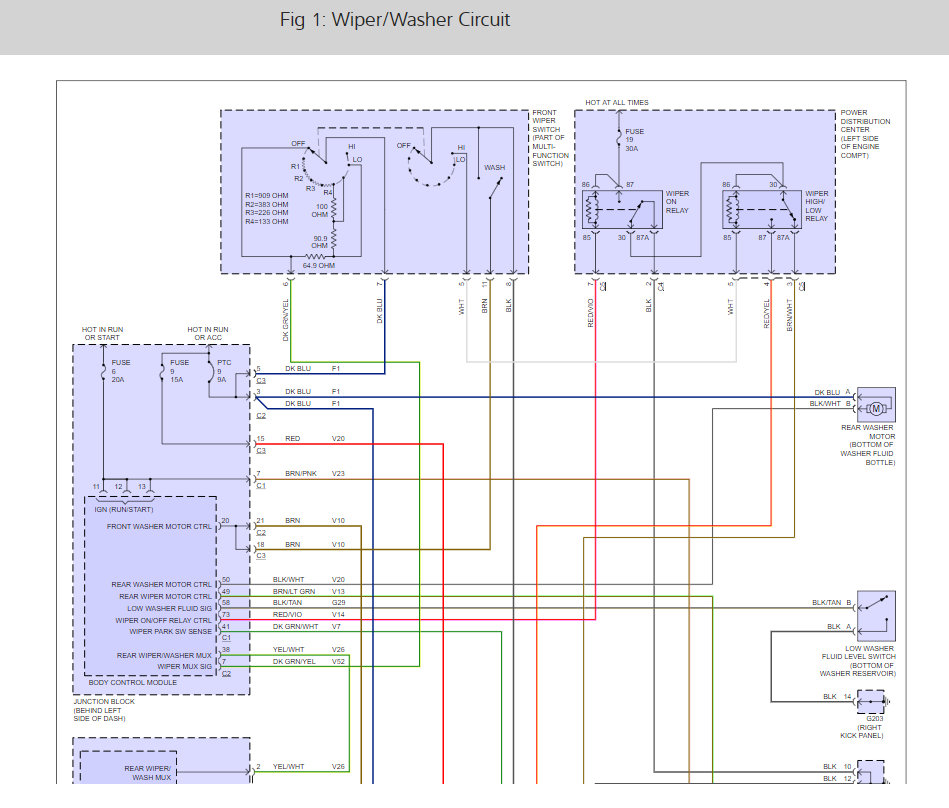

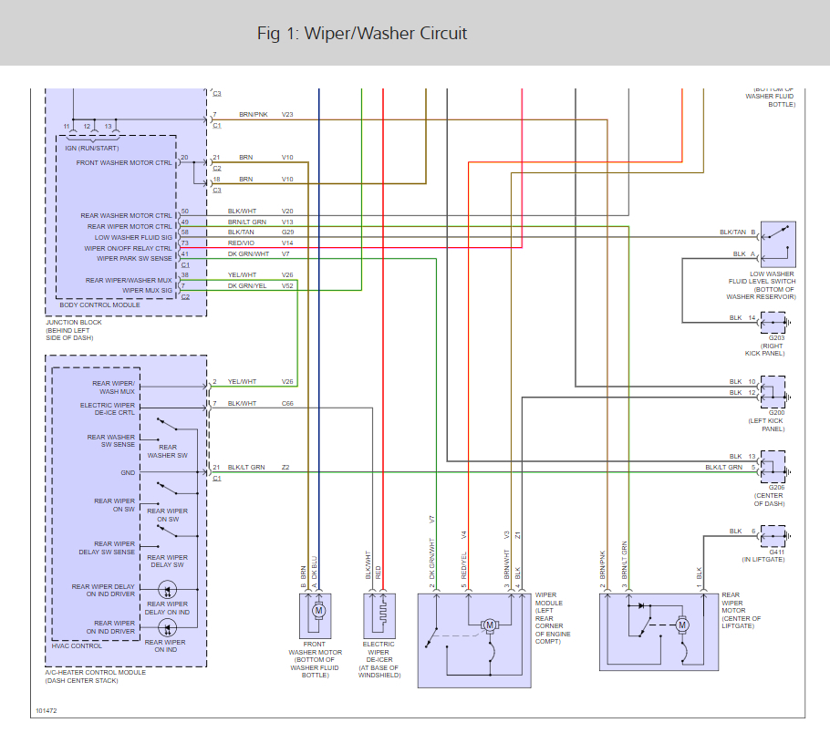

It sounds like the BCM is out. I would try to find a used one and plug it in. Here is the wiper wiring diagrams so you can see how the system works and the location of the BCM so you can get it changed out.
