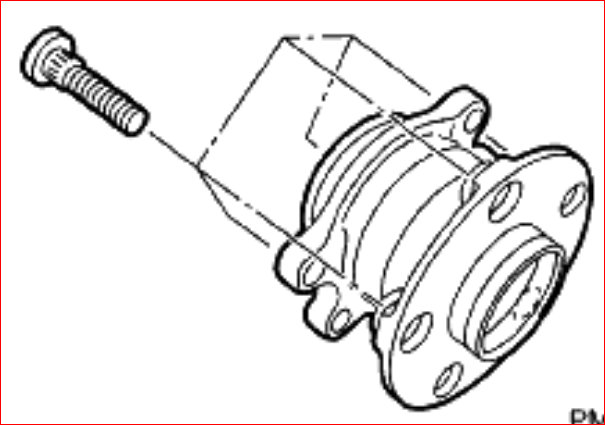

Hello, I am Danny.
Yes, the rear hub/bearing is a sealed unit. I have attached a picture of what it looks like. Unfortunately the wear and cannot be greased, just replaced. Hope this helps and feel free to ask any other questions if needed. Thanks for using 2CarPros.
