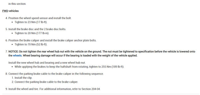

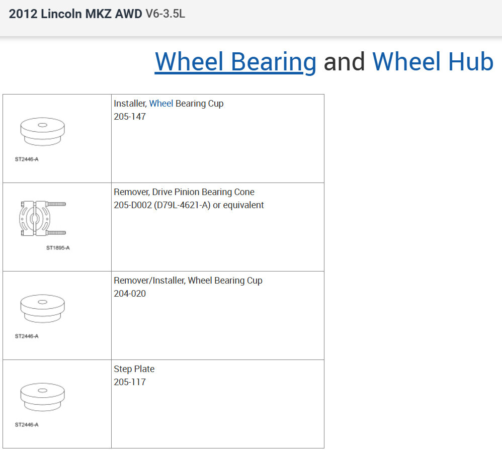

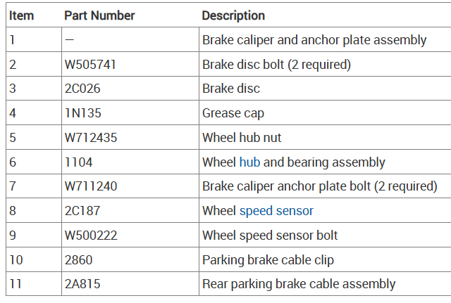

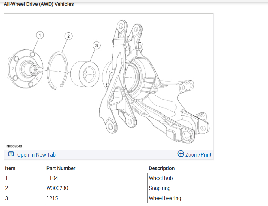

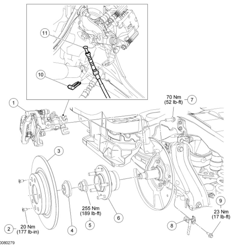

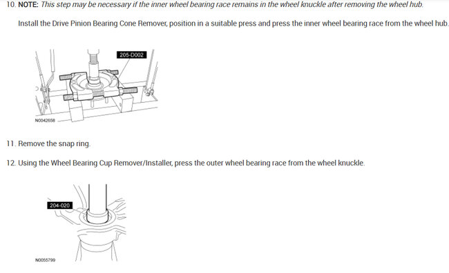

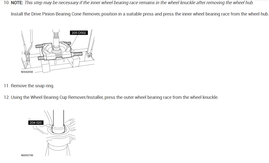

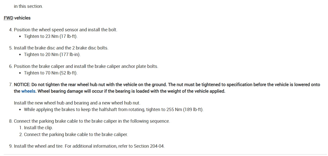

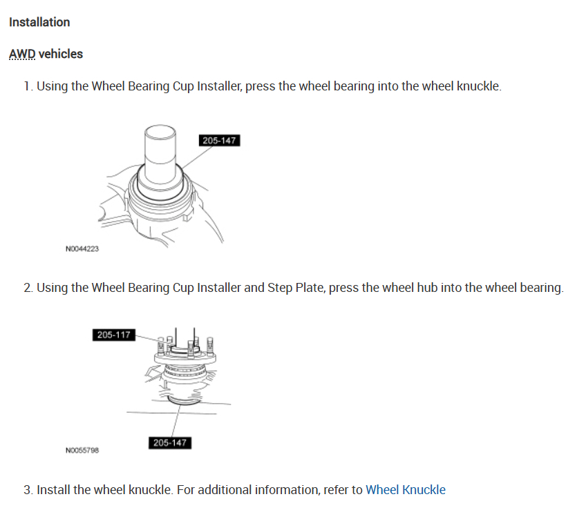

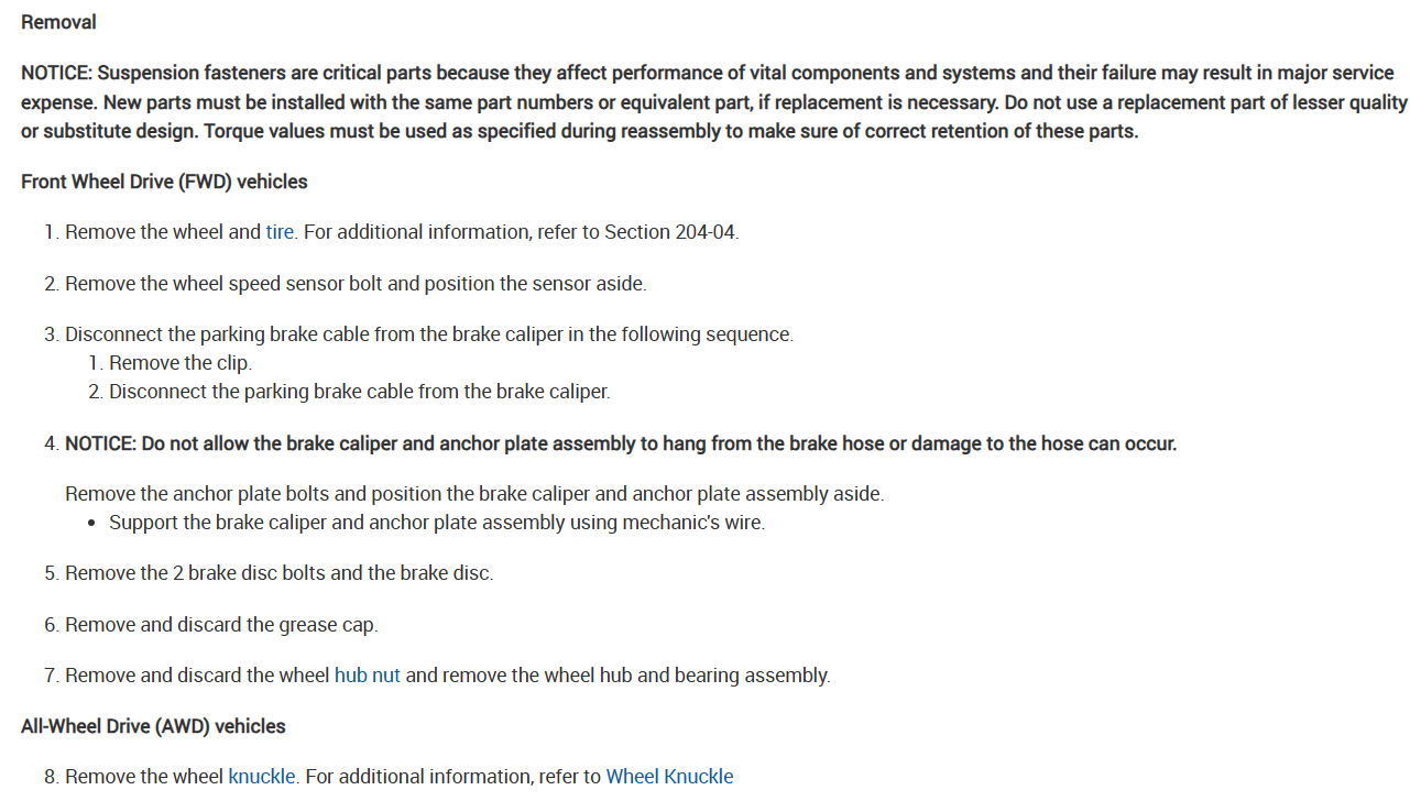

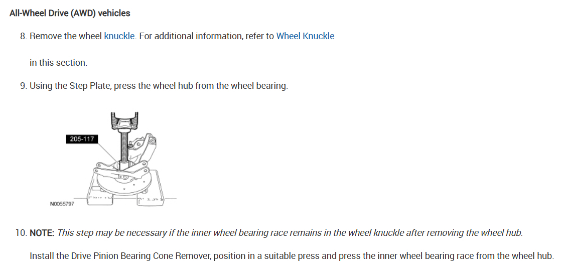

Bummer, yep you need to pressure the bearing out. This video will help, and I have included how the job is done for your car. The car is different, but the procedure is the same.
https://www.youtube.com/watch?v=_FzmmBoa4Tg
Check out the images (below). Please upload pictures or videos in your response of any problems so we can see what to help you with.
