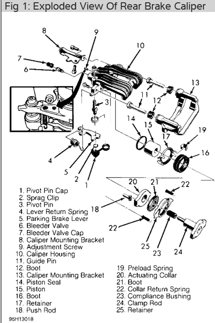

Rear wheel brake and rotor assembly image please.

there are no pictures of brake rotor in our manual only the caliper which has the parking brake in it. See picture.
