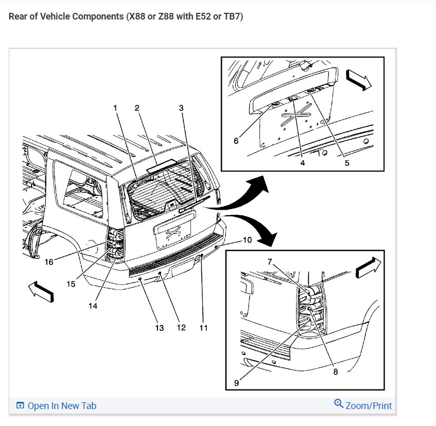

My rear-view camera does not work. when you put it into reverse, but no picture. I remember before it stopped working, it would cut in and out like it was losing connection type thing.
Nov 27, 2022 at 10:04 PM

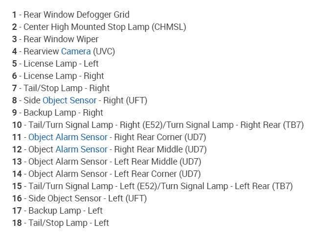

I have seen the camera go out on these cars which is common. Here is how to change the camera out to fix it. The rearview camera is not serviced separately from the rear liftgate applique. Check out the images (below). Please let us know if you need anything else to get the problem fixed.
