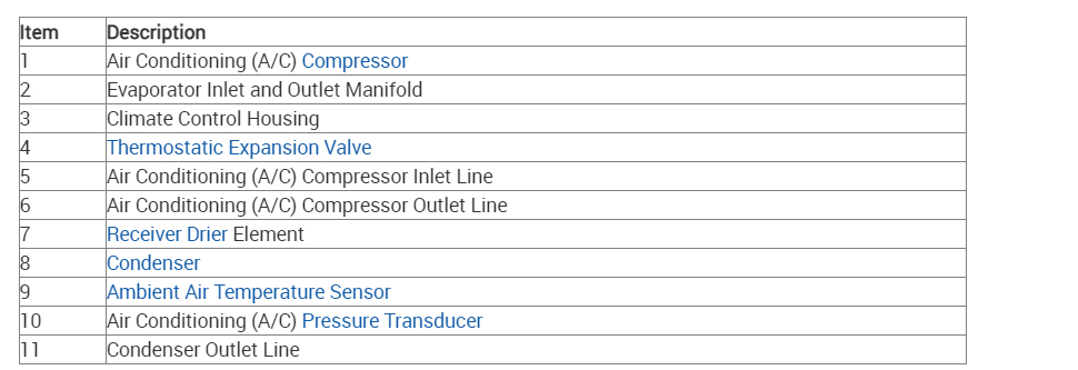

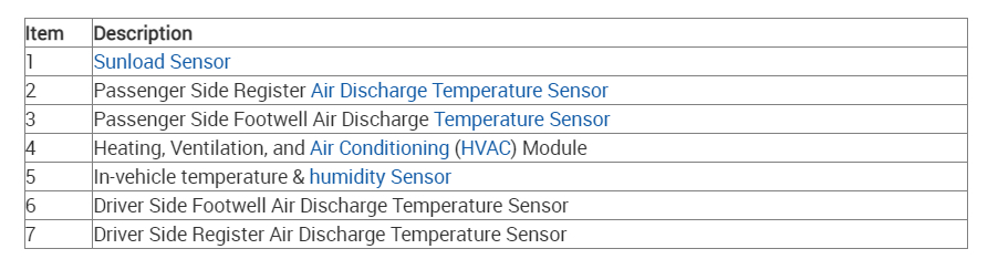

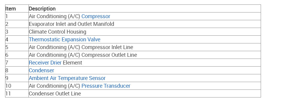

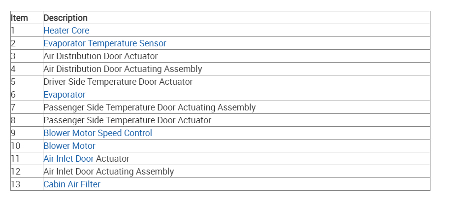

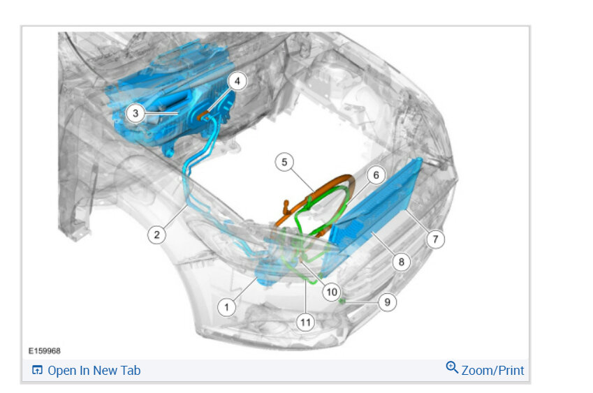

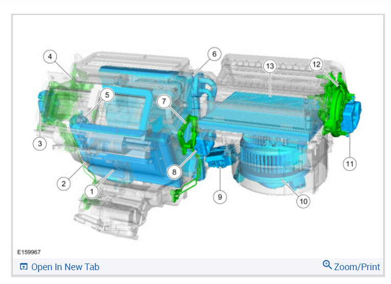

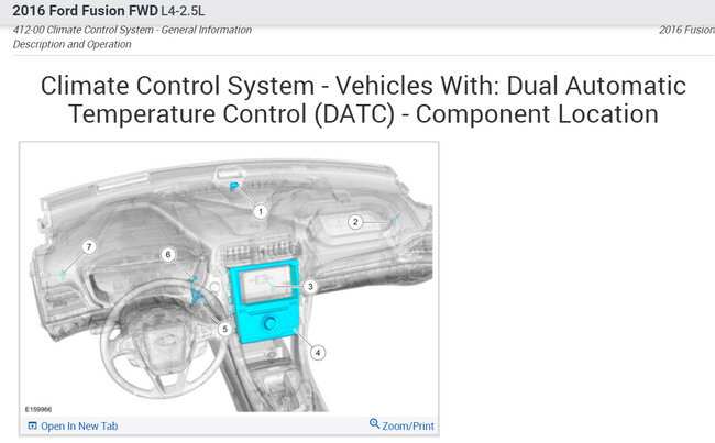

It sounds like an actuator is not working but I am not sure what you mean by rear vents? Here is a breakdown of the system so you can see how it works and what the actuators do. Check out the images (below). Let us know what happens and please upload pictures or videos of the problem so we can see what's going on.

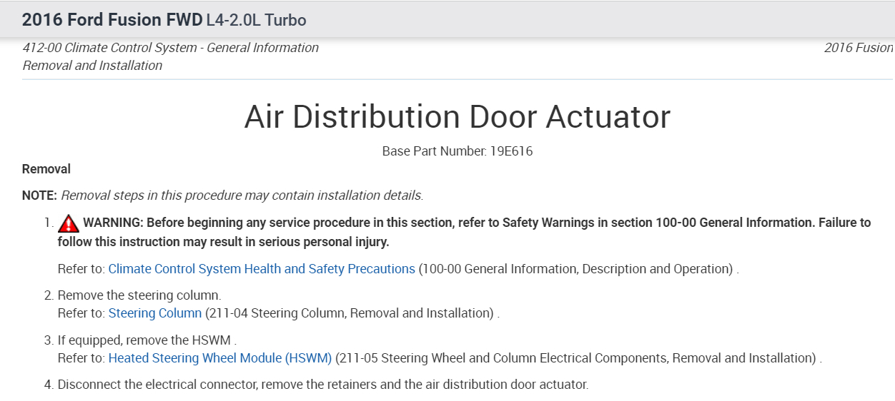

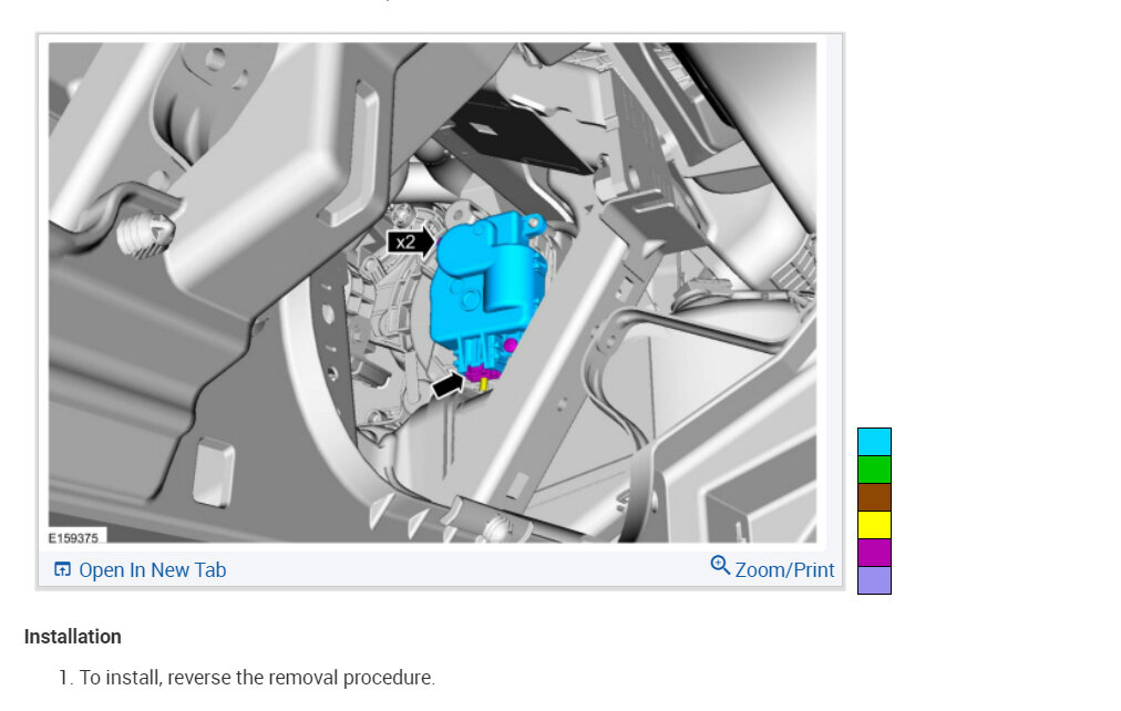

Okay, this would be a problem with the Air Distribution Door Actuator, here is its location and how to change it out. Check out the images (below). Please let us know what happens.
