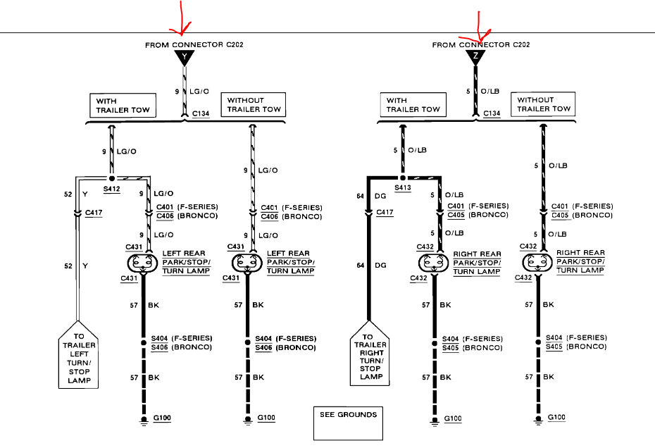

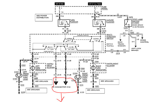

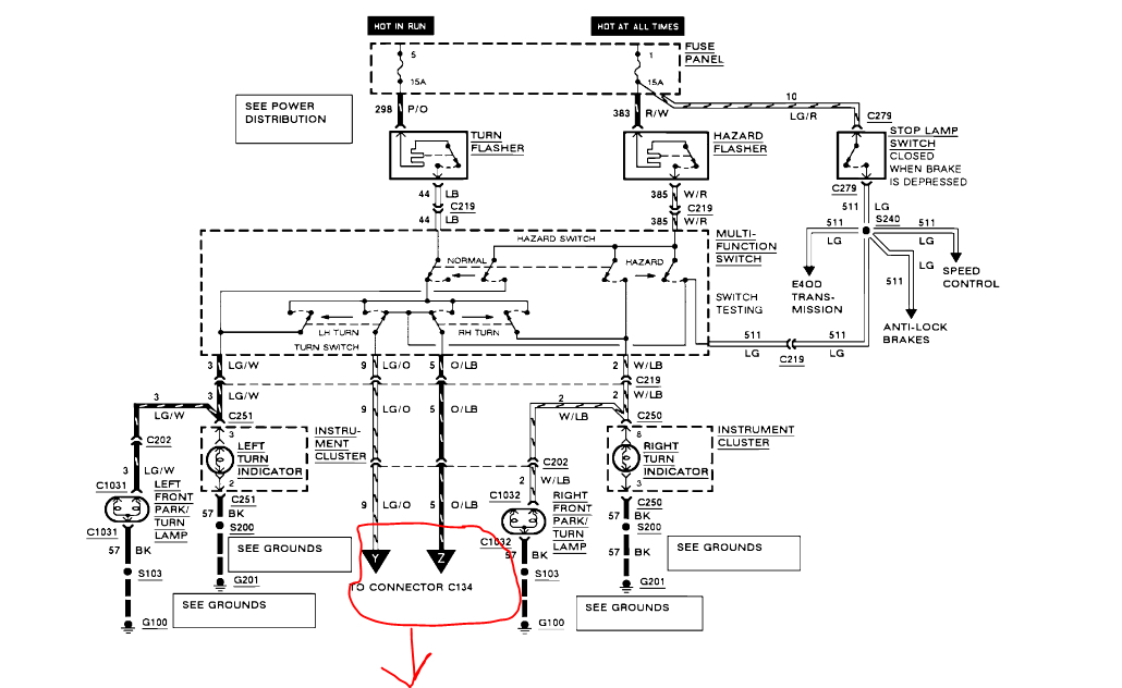

Do the brake lights work? As far as the signals and hazards are concerned, there is a good chance one of two connectors is failing. The connectors take signal power to the rear light assemblies.

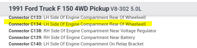

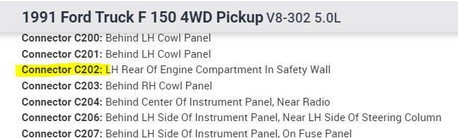

The connectors, C202 and C134 are located under the hood. See the descriptions below. I'm saying these connections because they are the only power supply for the signal lights. If the front ones work, the switch and power supply is present but not making its way to the rear.
Also, all taillights share a common ground, so if the parking lights and brake lights work, the ground should be good.
Take a look and let me know what you find. Also, let me know if the brake lights and parking lights both work.
See pics below.
