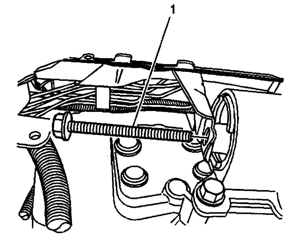

(SEE IMAGE 1)
1. Raise the vehicle.
2. Remove the left front wheel.

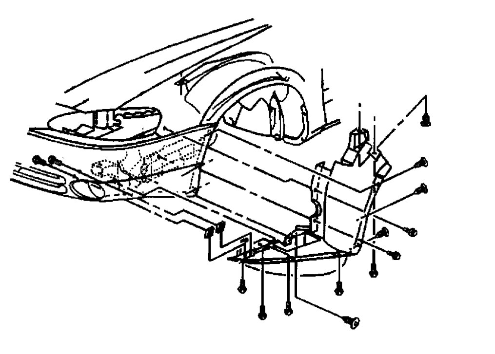

3. Remove the front fender liner.
4. Remove the mount thru bolt (1). (SEE IMAGE 2)
5. Remove the mount bolts.
6. Remove the mount.
