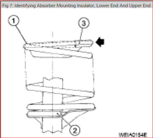

One thing you might want to have checked is the rubber Insulator. This goes in place between the strut body and coil spring. It acts as an Insulator between the two. If it is missing/worn that could be the source of the squeak/rattle. There should be one on top and the bottom. I have attached a picture of the assembly. Hope this helps and thanks for using 2CarPros.

There are only shocks on the rear, not struts, and the shock does not go through the coil spring.

My mistake. Have you had the shop that installed the shocks and sway bar links take a look to see where the noise is coming from? It is possible something was not properly tightened. You should also have them check where the shock mounting points to see if they are worn/loose/cracked. If your vehicle is put up on a hoist they can walk around all the rear suspension components and check for rattles and any other defective/loose components. Hope this helps and thanks again for using 2CarPros.
