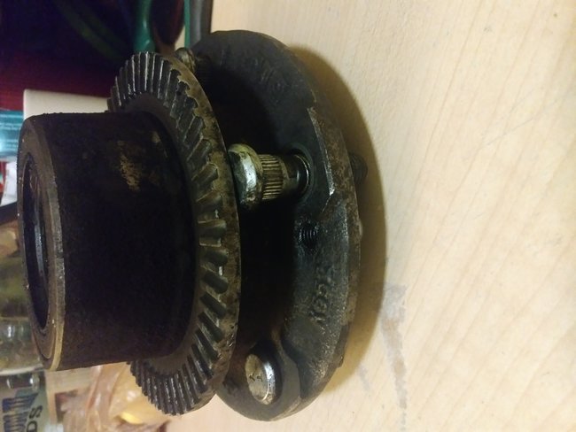

CLIFF THOMPSON
  • 4 POSTS
It appears to have a big round gear is some sort preventing the old lugs from coming out to me it looks like it is for the rear brakes.

CLIFF THOMPSON
  • 4 POSTS
Here is what it looks like.

HARRY P
  • 2,292 POSTS
Wow, that is ridiculous. I believe you will need a tool for that. I think AutoZone has it in their loan-a-tool program. It should be a tool set with the job of taking the hub apart in order to install new bearings.
Sometimes, if you go in there when they are not busy, they can help you take care of stuff like that right there.

CARADIODOC
  • 34,306 POSTS
Hi HEYMAN1104. It looks to me like they pulled the stunt GM is famous for. They want you to buy the whole assembly to get the part you need. The tool I think you referred to is for pulling the hub out of the bearing, but this pressed-on type of bearing can only be removed by destroying it. Normally there is never a reason to remove it except because it is noisy. This is the first one I have seen where a stud cannot be replaced separately.
The exception would be if that tone ring can be pushed back, out of the way, but when it is reinstalled, that air gap is critical for proper operation of the anti-lock brake system, especially at lower speeds. From what I can see in the photo, the tone ring is cast as part of the hub, so the only way to replace a stud is to destroy and replace the bearing. The better way is to just buy a new bearing assembly and pop it on.

HARRY P
  • 2,292 POSTS
You are probably right about that. You can get hubs pretty cheaply on Amazon. I got one for my 4x4 Blazer for $30.00. That is on tomorrow's to do list, along with the multi-function switch. Hubs are somewhere around $80.00 at AutoZone.
