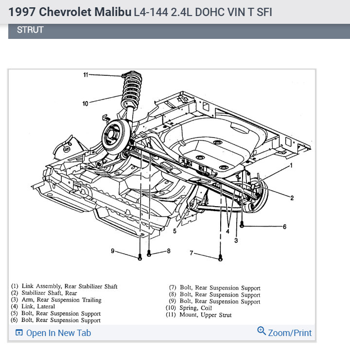

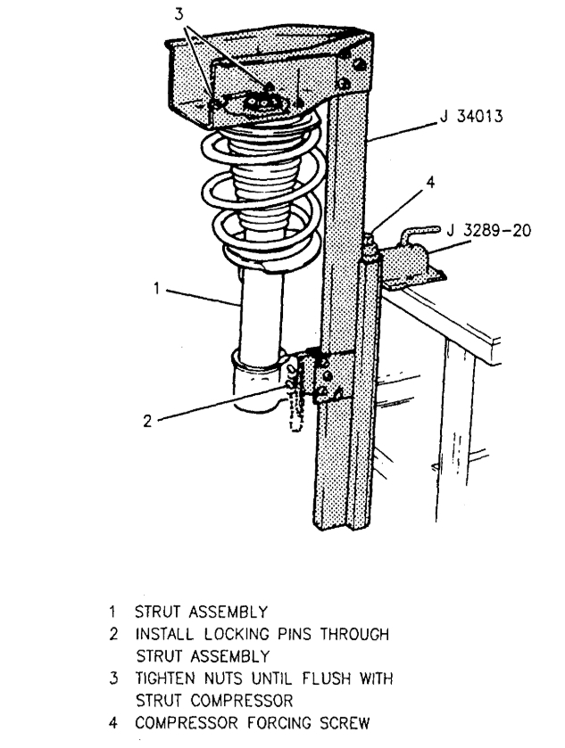

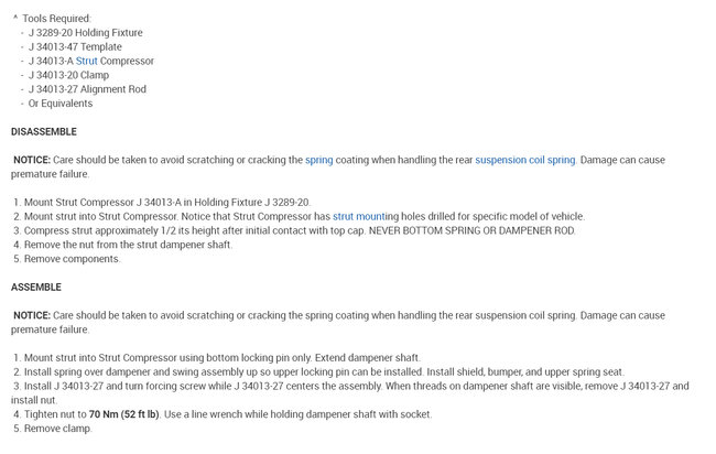

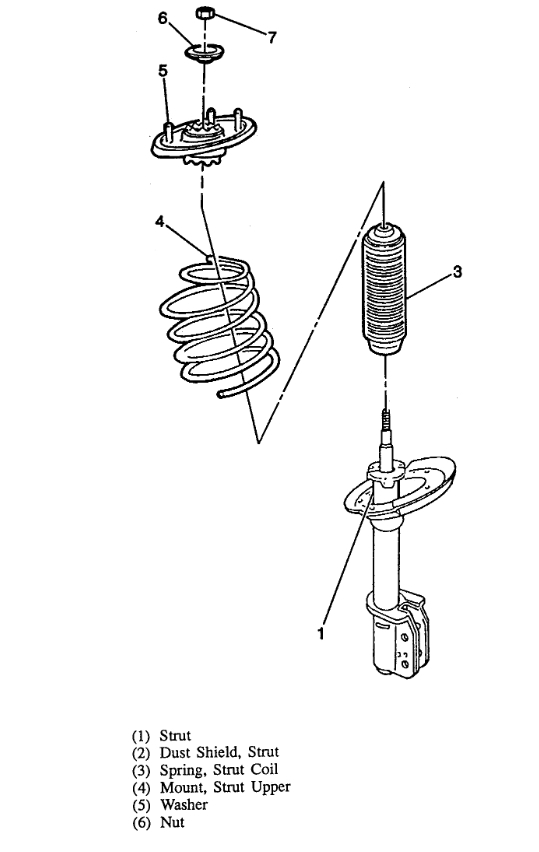

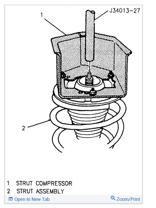

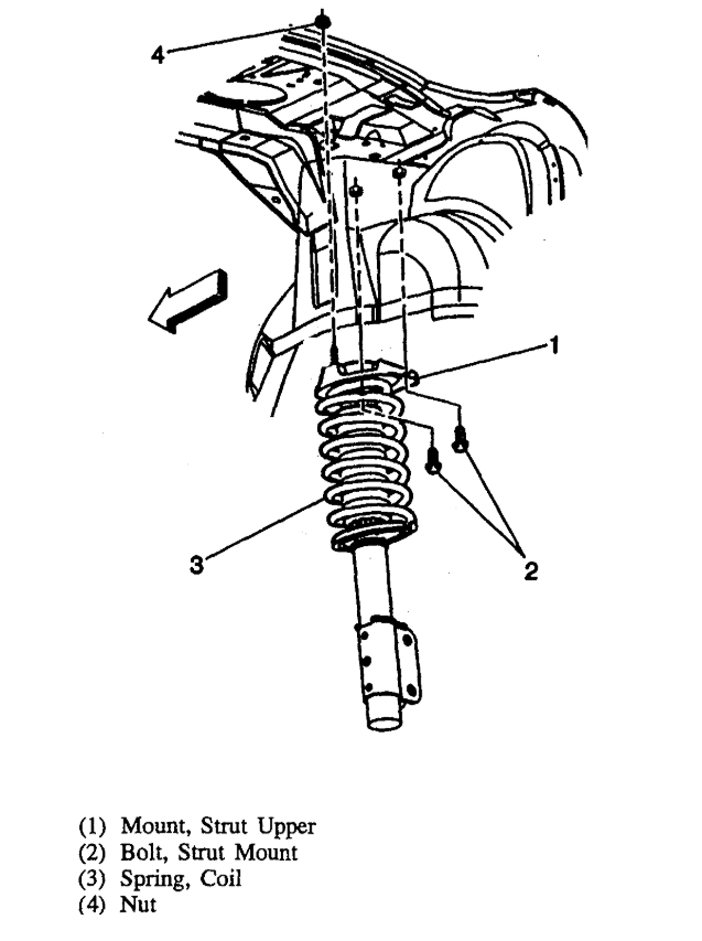

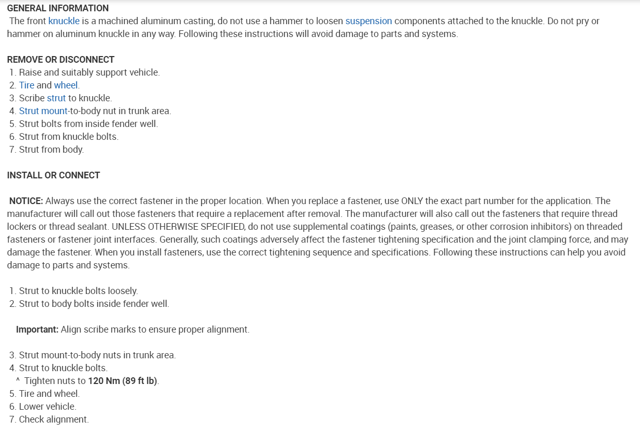

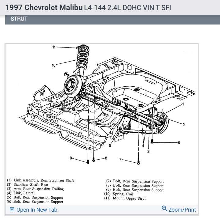

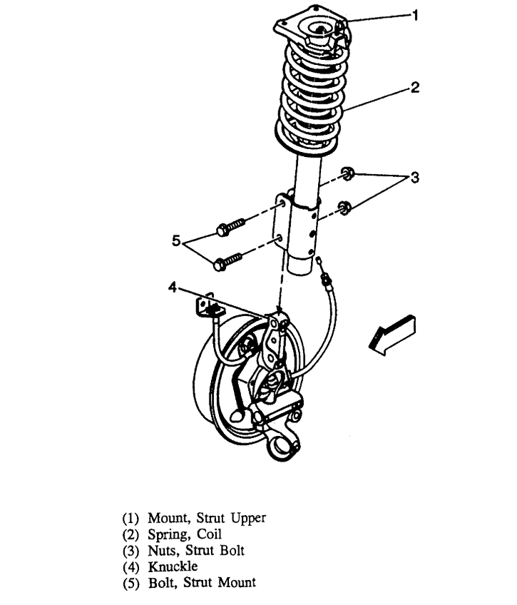

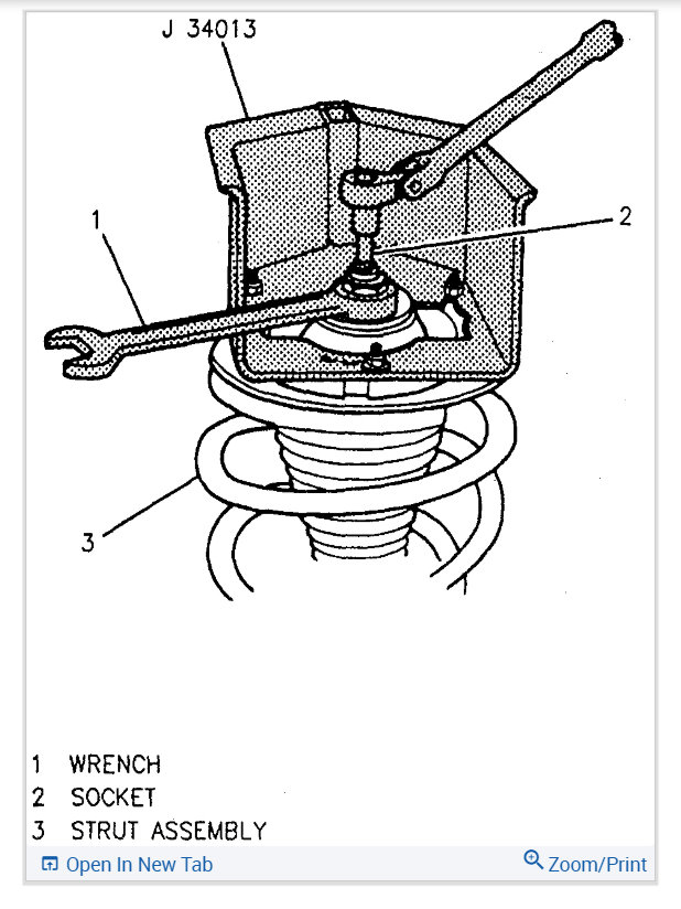

They do not offer fully loaded struts for the rear of this car. you will need to separate this coil from the strut your self. here is how in the diagrams below. Check out the diagrams (below). Please let us know if you need anything else to get the problem fixed.

Ken on a 1997 Malibu struts , will the front 3 1/4 bottom hub bracket be the same as the rear struts?
Mar 3, 2020 at 6:13 AM
STEVE W.
CERTIFIED EXPERT
15,113 POSTS
The brackets are different front to rear. The early rear strut unit holes are 3.25 apart. The fronts are 3.5 and located in different areas on the bracket as well. The front and rear struts also have different spring seats and damping calibration. Plus the rear struts extend through the mount bracket where the fronts are even with it to provide room for the axle and CV joint.
