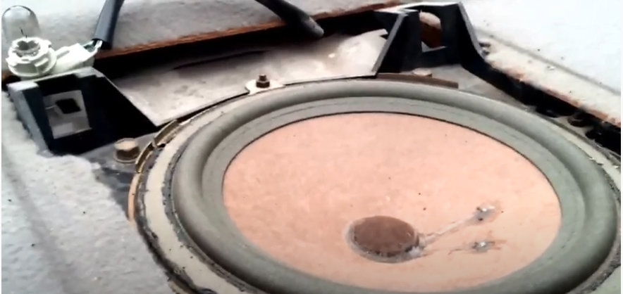

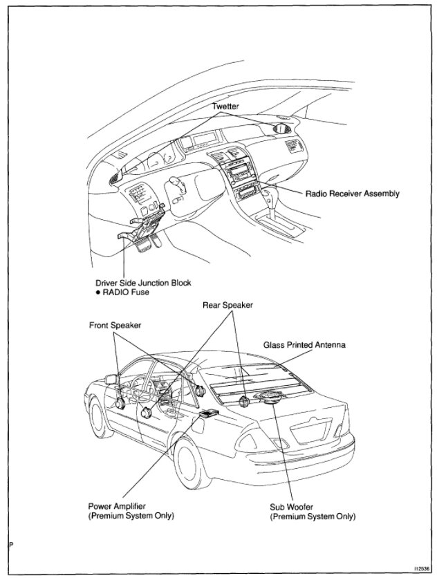

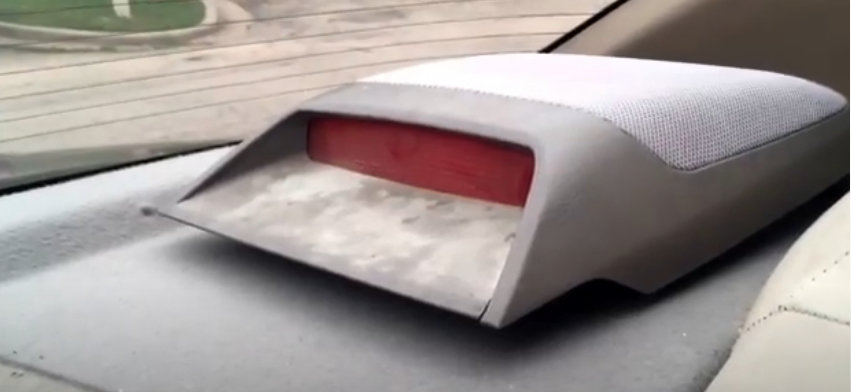

You have to lift the center mount brake light cover and it will unbolt and lift out. You should be able to see the sub woofer from inside the trunk which if you need to, you can push it up from under there once the bolts are removed.
Let us know what questions you have. Thanks
