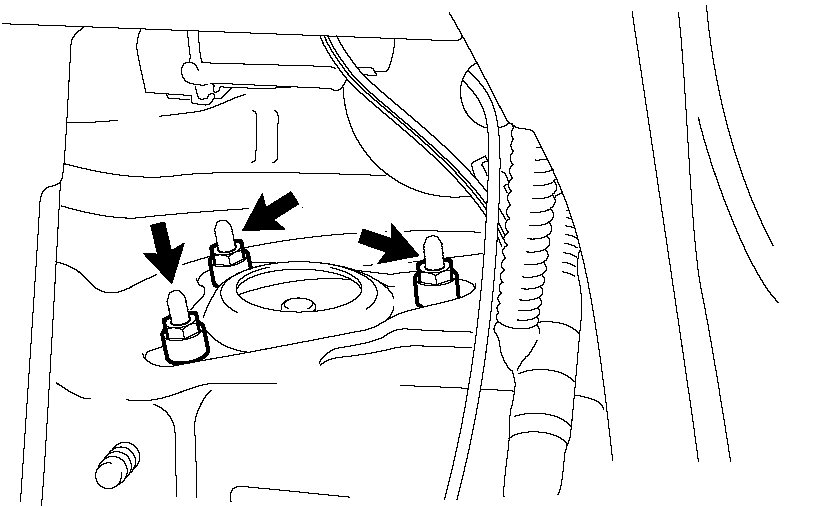

See pic 1

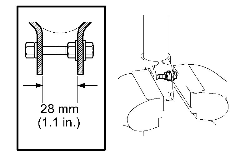

pic 2

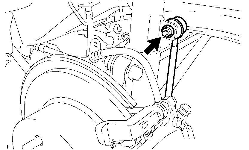

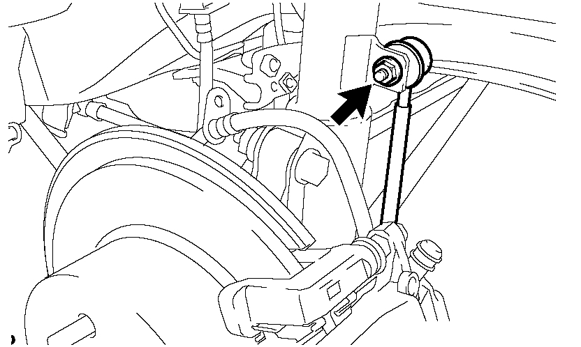

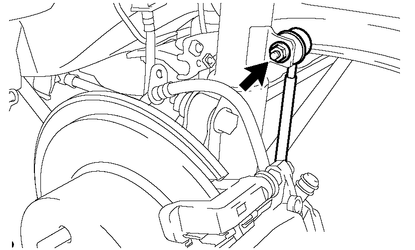

18. SEPARATE REAR STABILIZER LINK ASSEMBLY LH
(a) Remove the nut and separate the rear stabilizer link assembly from the front shock absorber LH.
HINT: If the ball joint turns together with the nut, use a hexagon wrench (5 mm) to hold the stud.

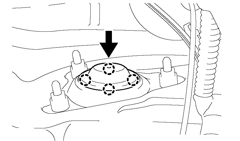

pic 3

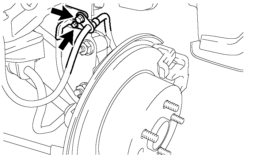

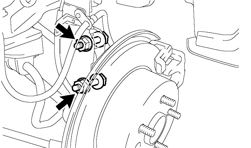

19. SEPARATE REAR SPEED SENSOR
(a) Remove the 2 bolts, and disconnect the rear brake flexible hose and rear speed sensor from the rear shock absorber with coil spring and rear axle carrier.
NOTICE: Be sure to remove the rear speed sensor from the rear shock absorber with coil spring.

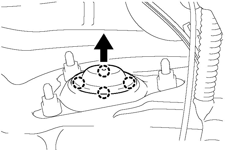

pic 4

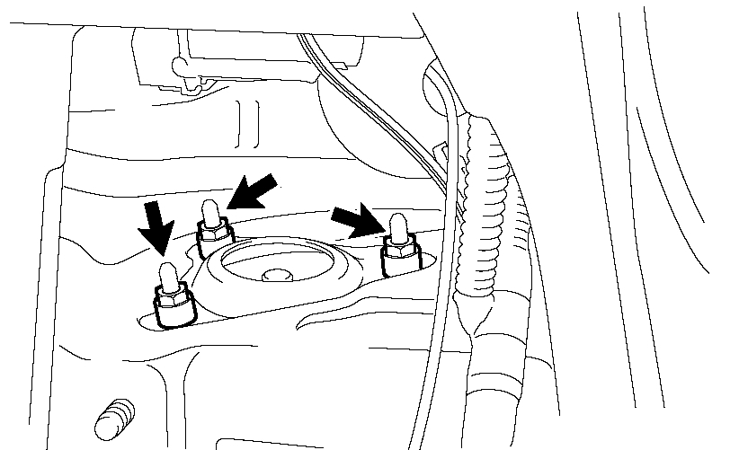

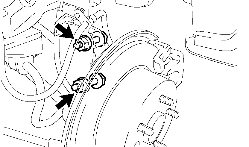

20. REMOVE REAR SUSPENSION SUPPORT NO. 1 COVER
(a) Remove the 4 claws and the rear suspension support No. 1 cover.

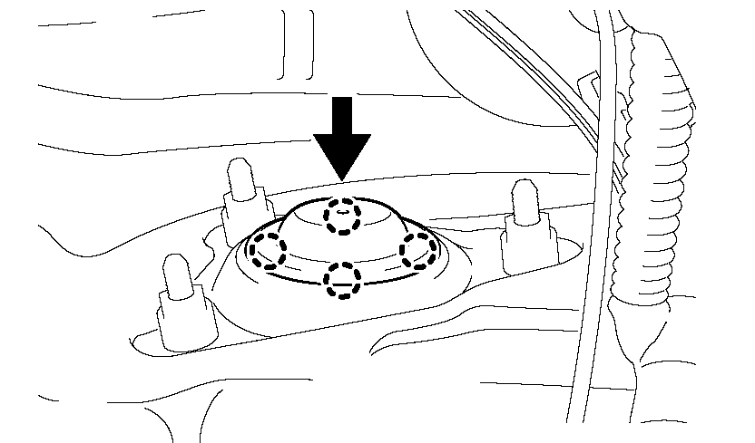

pic 5

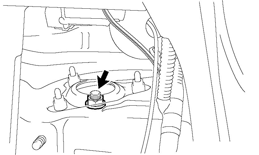

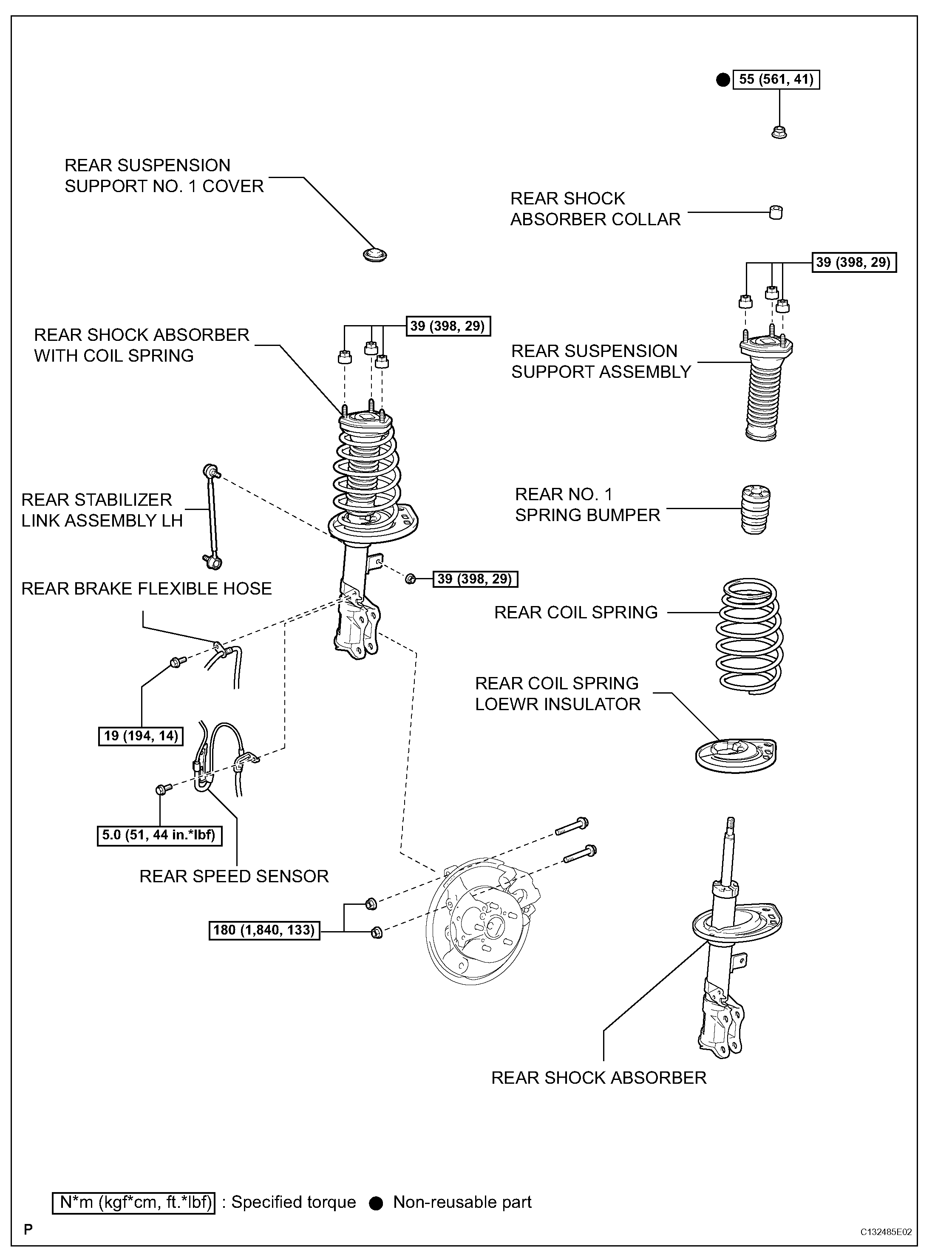

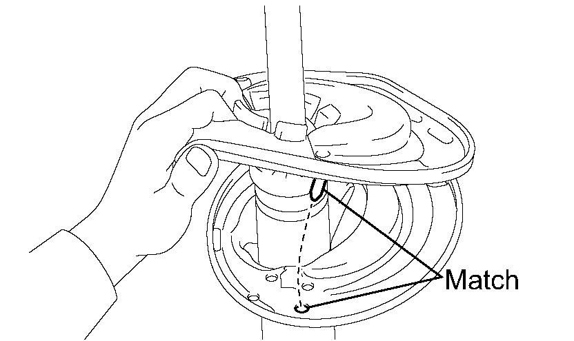

21. REMOVE REAR SHOCK ABSORBER WITH COIL SPRING
(a) Loosen the lock nut of the rear shock absorber with coil spring.
NOTICE:
^ Do not remove the lock nut.
^ Only loosen the nut when disassembling the rear shock absorber with coil spring.

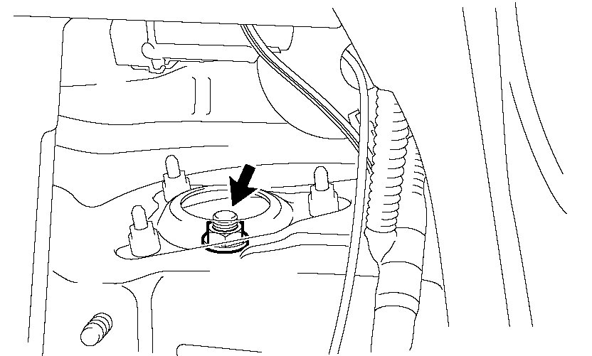

pic 6

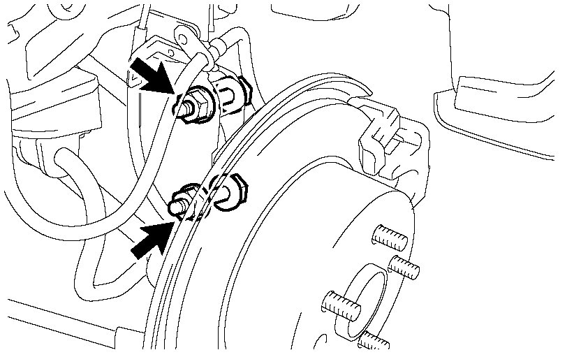

(b) Remove the 2 nuts and 2 bolts on the lower side of the rear shock absorber with coil spring.
NOTICE:
^ When removing the nuts, keep the bolts from rotating.
^ Keep one bolt inserted to secure the hub and disc rotor.
pic 7

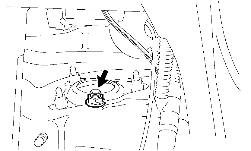

(c) Remove the 3 nuts on the upper side of the rear shock absorber with coil spring.
(d) Lower the rear axle carrier, and remove the 2 bolts on the lower side of the rear shock absorber with coil spring.
NOTICE: Make sure that the rear speed sensor is disconnected from the rear shock absorber with coil spring.

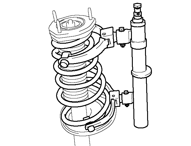

1. FIX REAR SHOCK ABSORBER WITH COIL SPRING
(a) As shown in the illustration, secure the rear shock absorber with coil spring in a vise using aluminum plates by closing the vise onto the double nutted bolt affixed to the bracket at the bottom of the absorber.

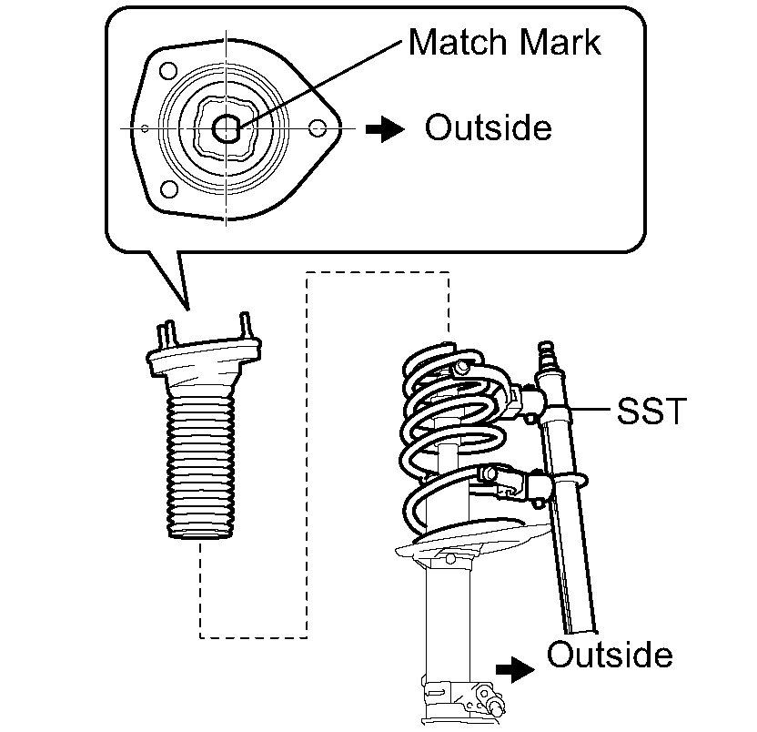

2. REMOVE REAR SHOCK ABSORBER
(a) Using SST, compress the rear coil spring.
SST 09727-30021 (09727-00010, 09727-00021, 09727-00031)
NOTICE: Do not use an impact wrench.
HINT: If the front coil spring is compressed at an angle, using 2 SST will make the work easier.
(b) Remove the nut, rear shock absorber collar and rear suspension support assembly.
(c) Remove the rear coil spring, rear No. 1 spring bumper, and rear coil spring lower insulator.

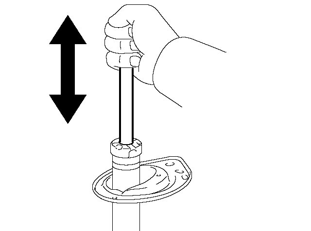

1. INSPECT REAR SHOCK ABSORBER
(a) Compress and extend the shock absorber rod 4 or more times.
Standard: There is no abnormal resistance or sound and operation resistance is normal.
HINT: If there is any abnormality, replace the rear shock absorber with a new one.

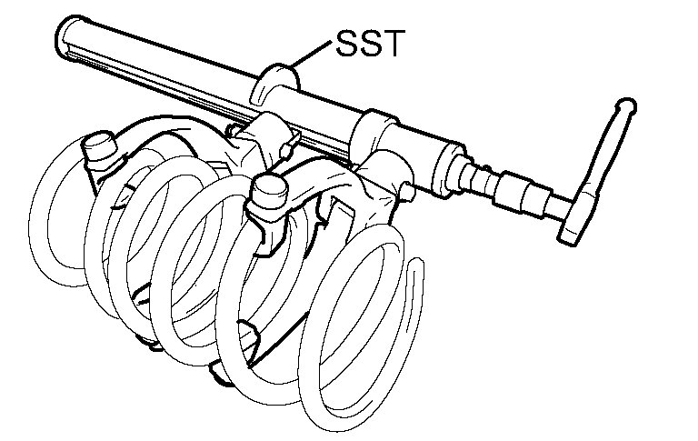

(c) Using SST, compress the rear coil spring.

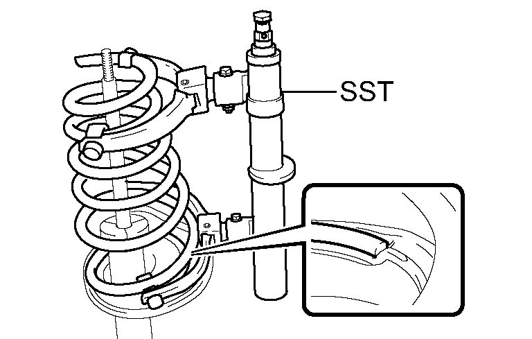

(d) Install the rear coil spring to the rear shock absorber.
NOTICE: The smaller diameter end must face upward.
HINT:
^ Fit the lower end of the rear coil spring into the gap of the lower seat.
^ If the front coil spring is compressed at an angle, using 2 SST will make the work easier.

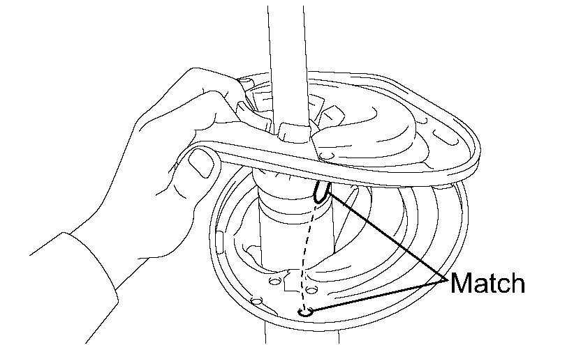

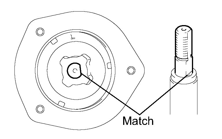

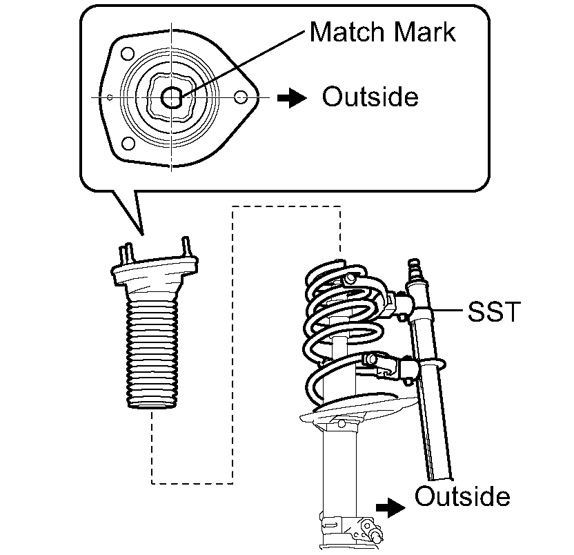

(e) Install the rear suspension support assembly.
NOTICE: Align the notches of the piston rod and the rear suspension support assembly as shown in the illustration before installing the rear suspension support assembly.
pic 15
(f) Align the notches of the shock absorber with the notch of the rear suspension support assembly so that the notches face the outside of the vehicle.

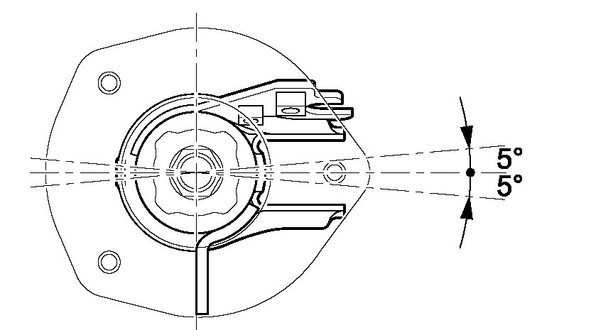

pic 16
(i) Release the spring while adjusting the rear suspension support assembly to the position shown in the illustration, and remove the SST from the rear coil spring.
HINT: When lining up the rear suspension support assembly's stud bolts at the middle point between the two sides of the bracket, the maximum permissible degree of error is ± 5°.

1. INSTALL REAR SHOCK ABSORBER WITH COIL SPRING
(a) Install the rear shock absorber with coil spring to the rear axle carrier assembly and insert the 2 bolts from the rear of the vehicle.

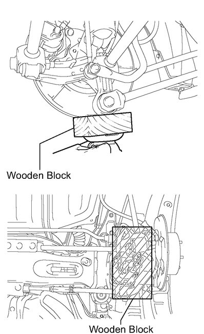

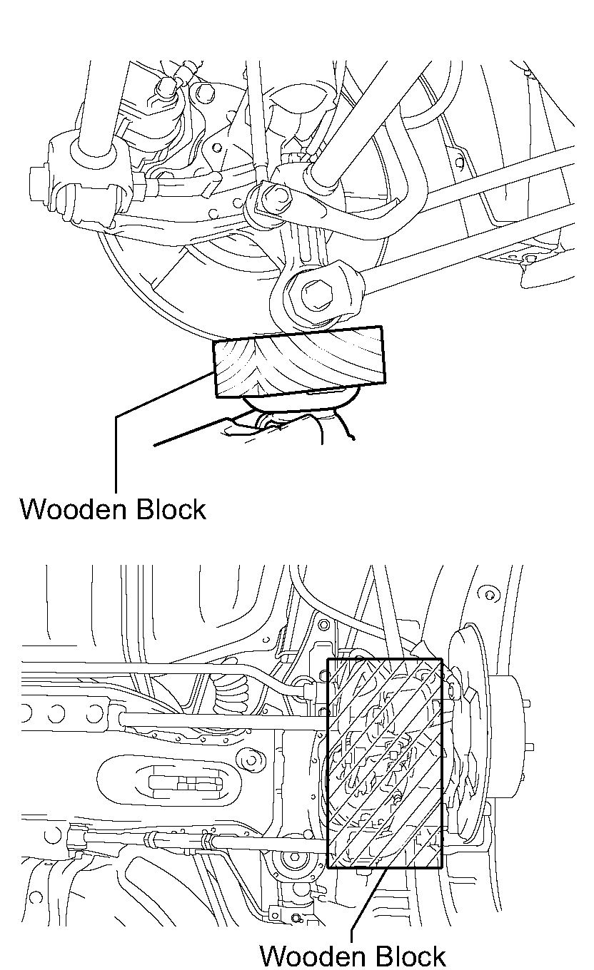

pic 17
(b) Slowly jack up the vehicle using a wooden block and install the rear shock absorber with coil spring (upper side) to the vehicle.
pic 18
(c) Install the 3 nuts to the upper side of the rear shock absorber with coil spring.
Torque: 39 Nm (398 kgf-cm, 29 ft. lbs.)
pic 19
(d) Install the 2 nuts and 2 bolts to the lower side of the rear shock absorber with coil spring.
Torque: 180 Nm (1,840 kgf-cm, 133 ft. lbs.)
NOTICE: When installing the nuts, keep the bolts from rotating.
pic 20
(e) Fully tighten the lock nut.
Torque: 55 Nm (561 kgf-cm, 41 ft. lbs.)

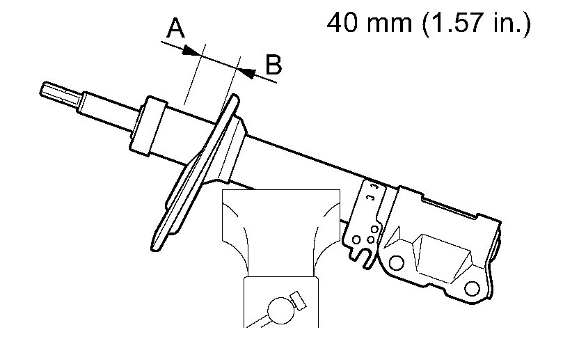

pic 24
1. DISPOSE OF REAR SHOCK ABSORBER
(a) Fully extend the shock absorber piston rod.
(b) Using a drill, make a hole in the cylinder between A and B as shown in the illustration to discharge the gas inside.
CAUTION:
^ Be careful when drilling because shards of metal may fly about. Always use the proper safety equipment.
