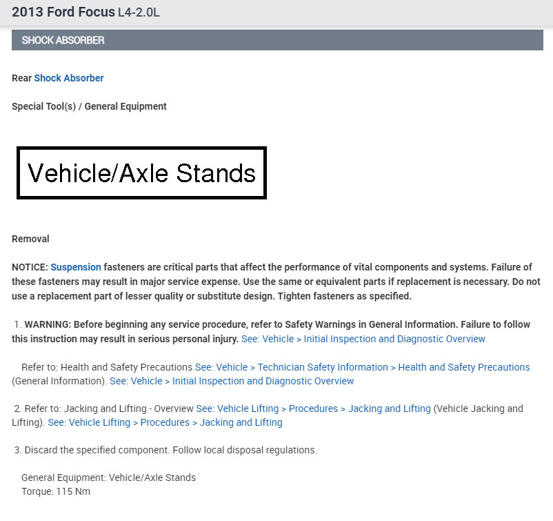

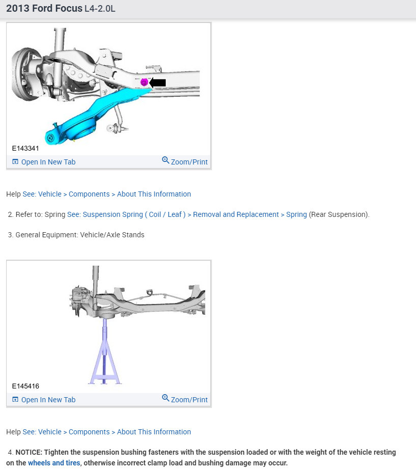

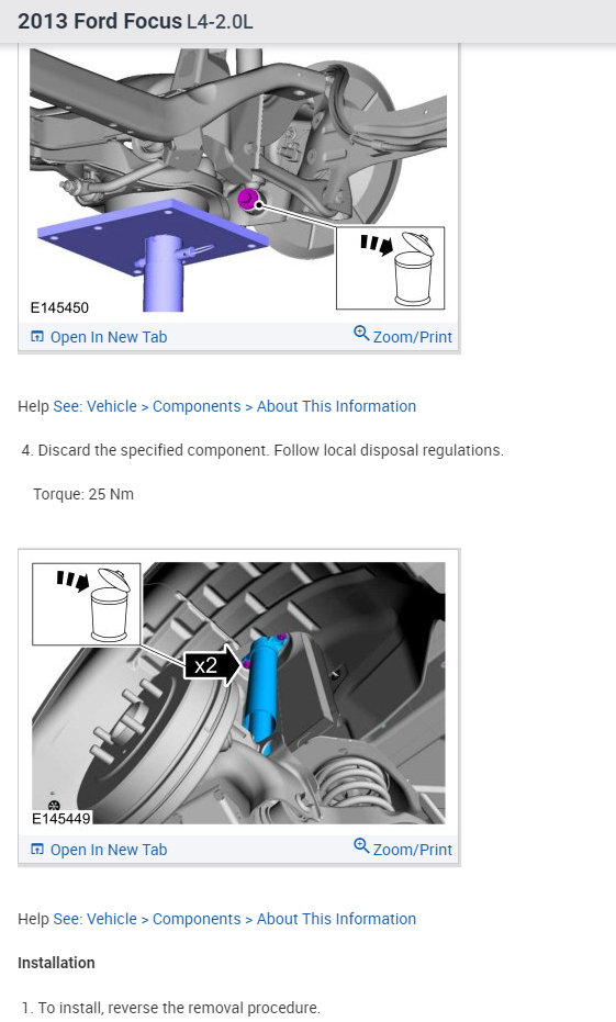

The car listed above is an SE model. The mechanic put the car on a lift and used a flashlight to show me the shocks. i thought you needed to remove the tire to get to the shocks. also need to replace lower control arm bushing. Thank you
