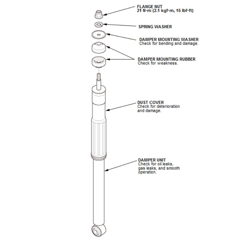

I have a 2015 Fit. The rear shocks are loose at the top mount area. Especially on the right rear side is very loose. Also, the plastic shroud that covers the shock's shiny chrome shaft is broken and crumbled apart. I know I need to change the rear shocks. Therefore, I need the exploded view diagram of the shock assembly and ALL of its associated parts, bushings, etc.so I can do the job right and order everything I need before I do the job. The maintenance manual procedures to remove and install the rear shocks will help as well so I can remove, replace, and torque everything back as it should. Thanks.
Dec 8, 2025 at 11:12 PM

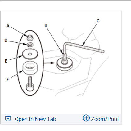

It looks pretty straight forward, so assume the metal pocket that holds the upper part of the shock has rusted out? You will need to fab a new piece and weld it in. Here are the shock stats as requested, Check out the images (below). Please upload an image or a short video in your response, so I can see what's going on.

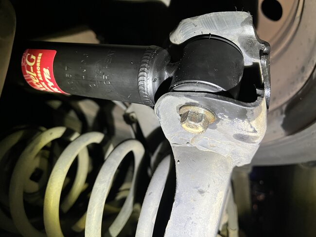

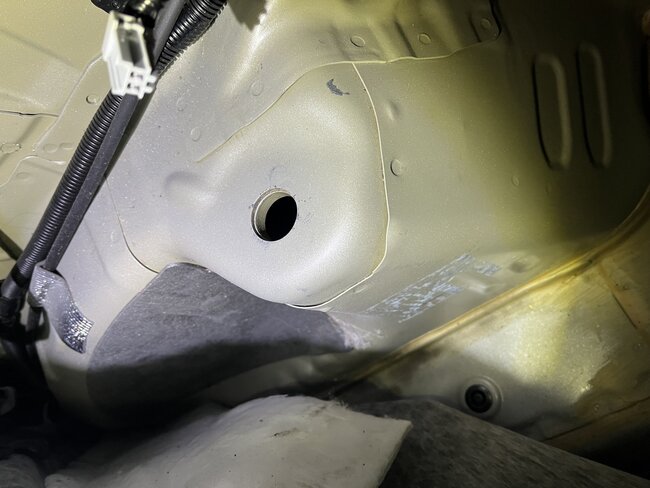

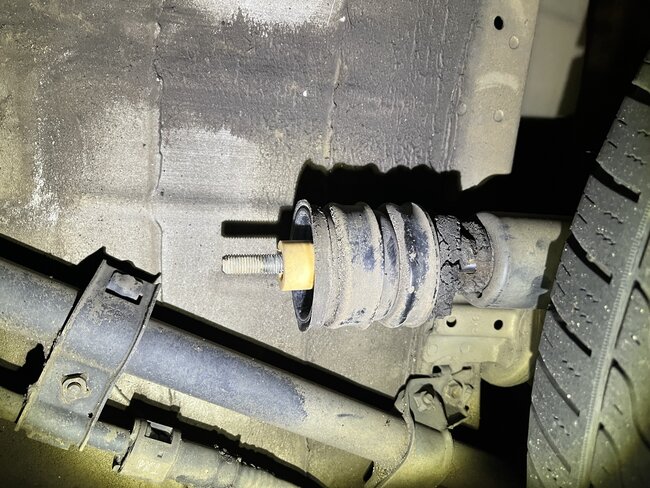

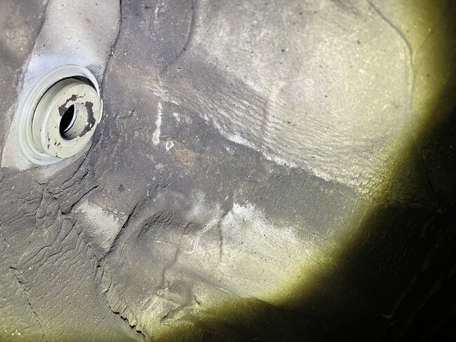

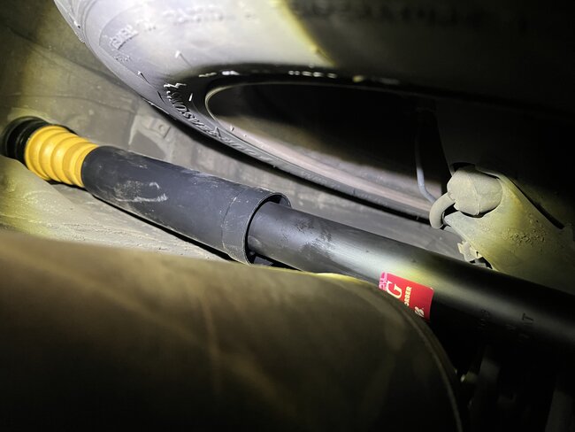

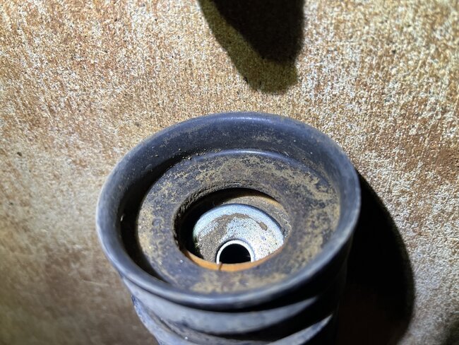

Its all fixed. Thanks for the help. The mount was mainly causing the slop. the metal was not rusted. pretty simple fix. I did use mounts from Amazon since the owner did not want to spend big money on Genuine Honda parts. I did use KYB shocks. Here is a video and some pics.
Jan 10, 2026 at 12:03 PM
lol yep, that would make some noise alright. Nice work getting the job done and the car back on the road! Thanks for he images, videos it fun to see what you are talking about when doing repairs. Please use 2CarPros anytime we are here to help. Ken
