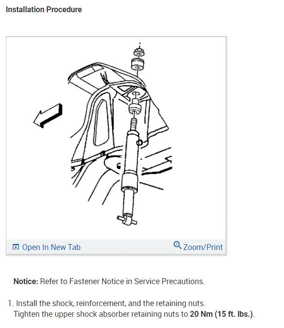

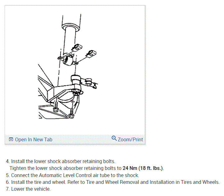

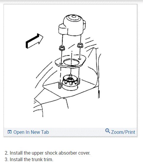

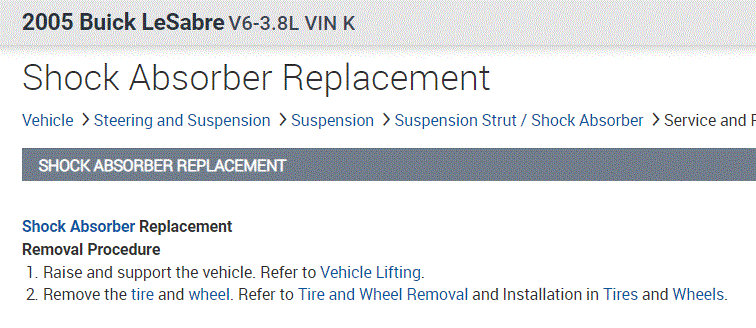

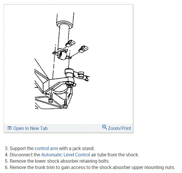

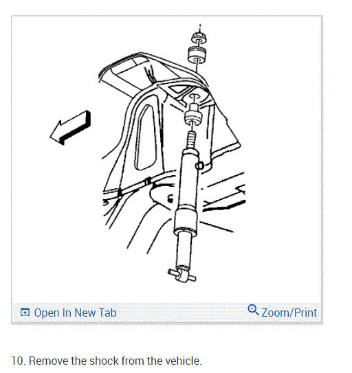

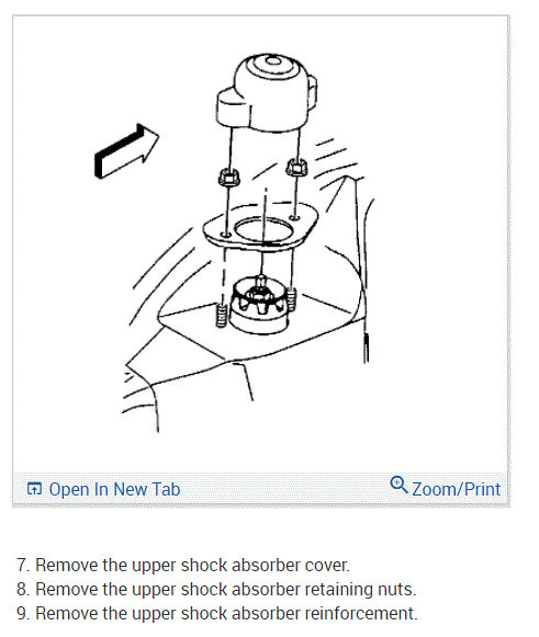

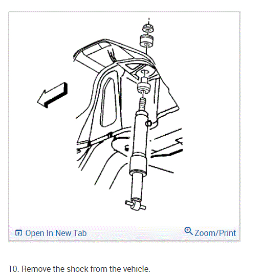

Next, the attachments below are specific directions for your vehicle. The directions include torque specifications as well. Read through them and see if anything was missed, left loose, and so on.
See pics below.

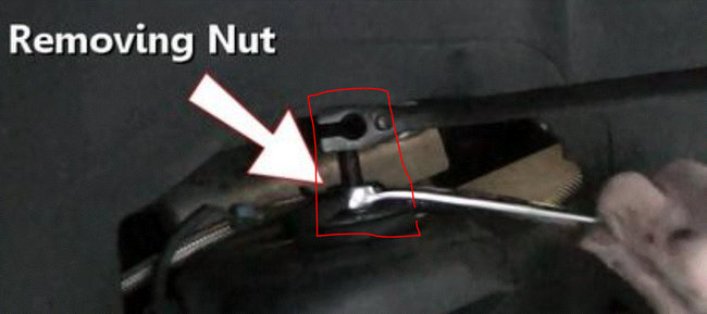

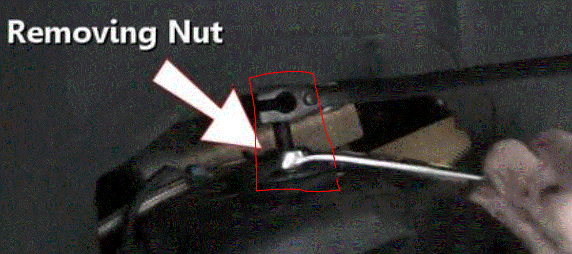

The shaft from the shock where the center nut attaches will turn. That's normal, so you didn't break anything.
You will need to tighten the nut onto the upper bushing. Tighten it until the rubber bushing is flush with the outside diameter of the washer.
On most shocks, you will need to hold the shaft to tighten the center bolt. Take a look at the top of the threaded portion of the shock's threads. Either there will be a place for an allen wrench or a place for a small wrench to attach and hold the shaft in place.
While holding that shaft, use an open-ended wrench to tighten the nut.
Let me know if what you find or if there is anything I can do to help.
See pic below.

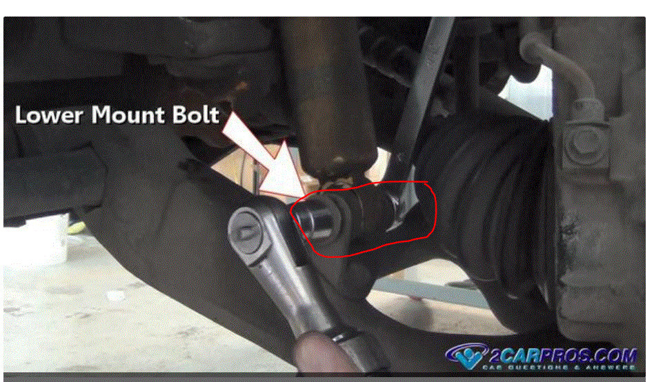

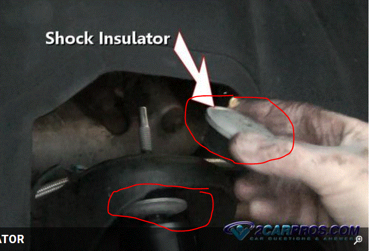

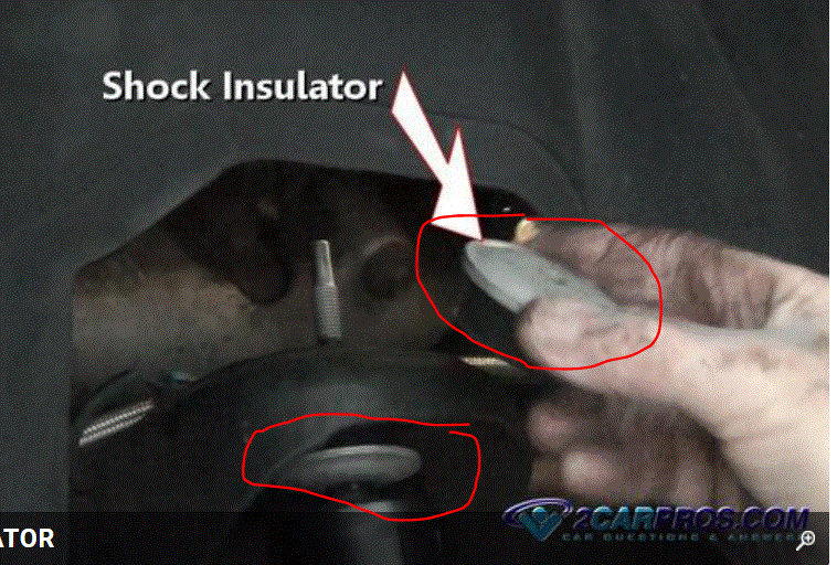

There should be a bushing both on the top and bottom of the shock. Are both present? If you look at pic 1 below, I circled both. Also, pic 2 shows the lower one. Make sure it is tight.
If everything is together correctly, then there is a chance the shock is damaged even though it's new.
One other thing. You can get a rattle if the coil spring is broken or cracked. Check that as well. Check specifically where it sits in both the upper and lower insulators (mount).
Let me know what you find.
See pics below.
