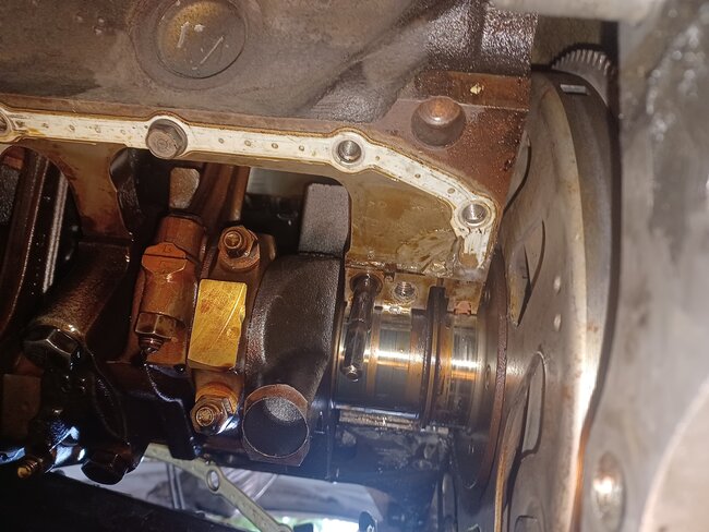

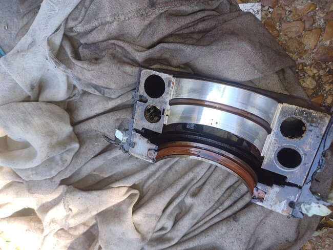

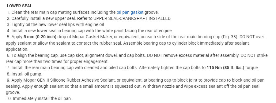

I'm replacing the 2 rear main seals. I did it 2 years ago but somehow a leak again. I wanted to know if offsetting the seals 3/8 of an inch is a better way to do it. With black RTV at ends at where bearing bolts up at to.
And is it okay if i could only get the 2 bolts to 80ft lbs, vs the recommended 85?
And is it okay to use black RTV at mating surface of oil pump.?

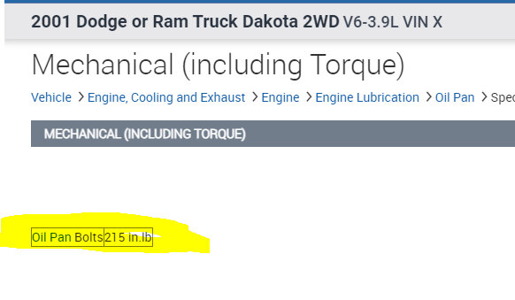

And what's the torq on oil pan, ft lbs?
How does the bearing look?
Any other suggestions are appreciated.

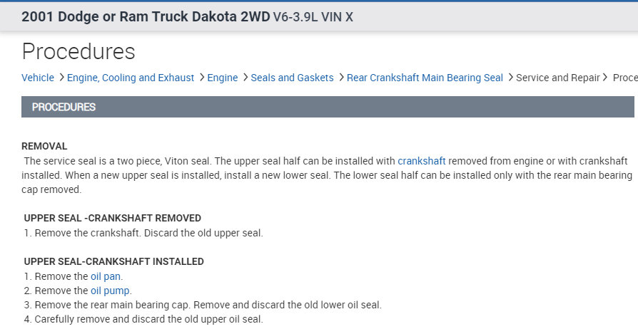

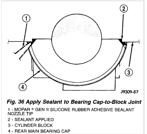

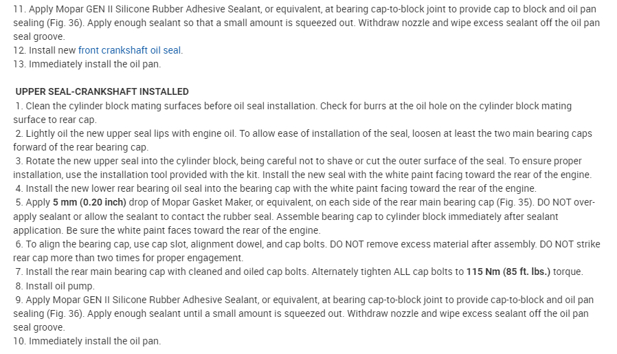

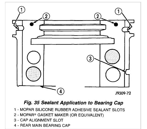

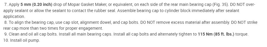

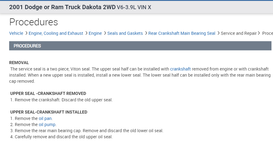

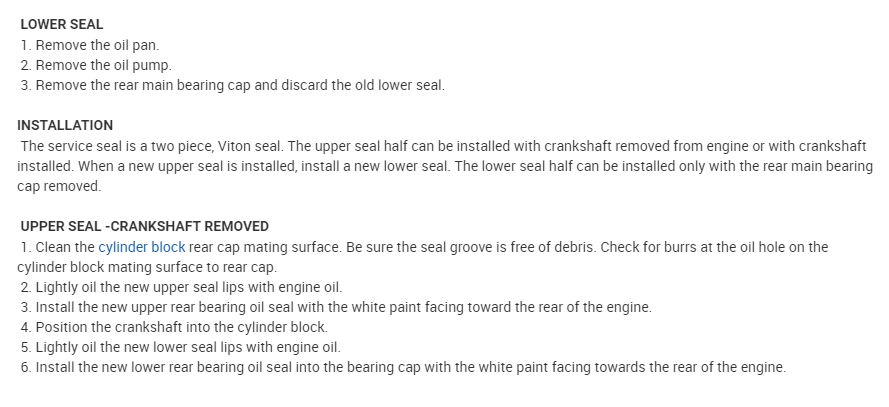

Wow, that engine has over 200,000 miles? The bearings look great for that amount of miles. As far as the seal, no don't offset it. I attached the directions below. Follow the directions for the best results. Remember to lubricate the upper seal before installing.

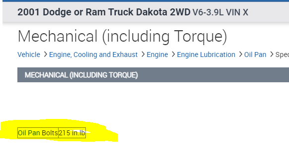

As far as the oil pan bolts are concerned, I attached the torque specifications below. Note that they are listed in inch-pounds and not foot-pounds. (pic 8)
Let me know if this helps.
See pics below.

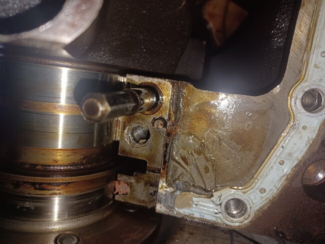

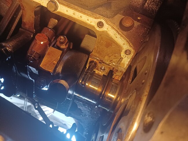

I got it all back together and i drove it about 70 miles both interstate and city. Yep, drip mark again! On that transmission flywheel casing.
The seals looked fine from the old one too...
I've already replaced valve covers and checked the oil pressure switch, no leak.
What should i look at next?
I'm going to double check the pan gasket but it's new.
Note: i noticed after i put the bearing cap on and sealed it. A tiny bit of seepage, so not sure if that factors it.

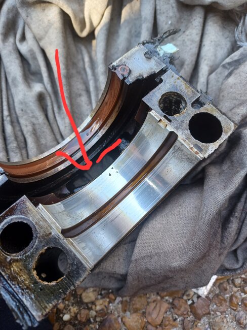

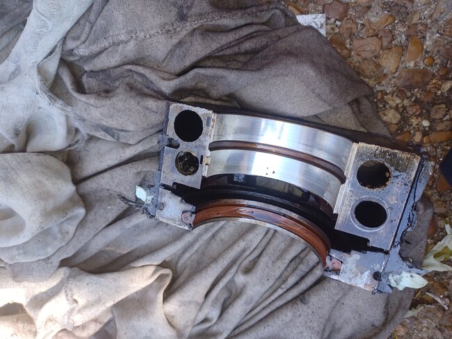

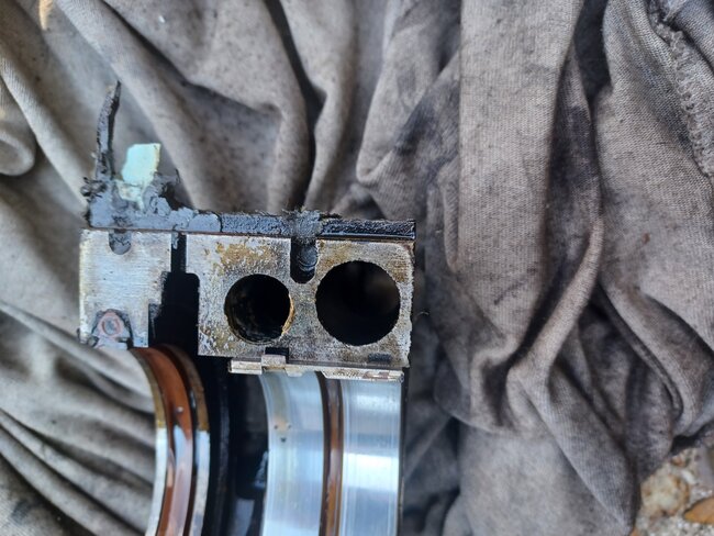

I turned over cao and see through it where there is an opening there. Is there supposed to be something in there...and what's it open for?
Sep 27, 2023 at 5:30 PM
  • 132 POSTS
I turned over cap an see thru it where there is a opening there..is tgere suppose to be something in there...an whats it open for?
Sep 27, 2023 at 5:32 PM
  • 132 POSTS

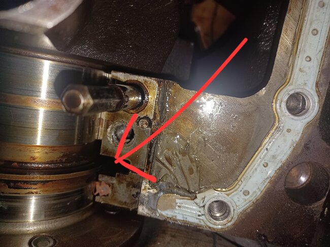

Something else i noticed in cap is that the 2-aluminum c shaped seals were able to move a bit left and right. Although once bolted it won't move an RTV will possibly seal..i wanted to know on those too...is there supposed to be something in there ,last pic arrow.
Sep 27, 2023 at 5:39 PM
In which pic are you seeing aluminum C-shaped seals? Which pic above? I'm not familiar with anything like that. Also, check the end play in the crankshaft. Grab the crank pulley and see if there is in and out play. If the thrust bearings are worn, that can cause the rear main to leak.

The shiny parts on that bearing cap i meant those 2 rows.
can i check that play since ita all bk together now and where ..at front?
When i had cap off the 2 shiny rows on cap/cover easily pivited left or right just a tad ..

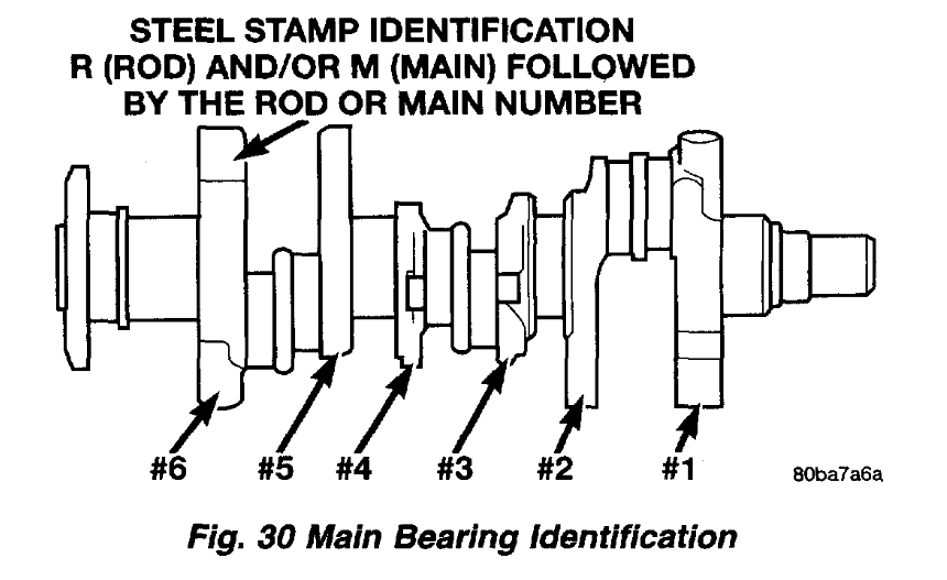

Where's the thrust bearings?
Sep 27, 2023 at 9:08 PM
The thrust bearings are used to control axial (side-to-side) movement or thrust along the length of the crankshaft. The primary function of thrust bearings is to support the axial loads generated by the engine's operation. In other words, it prevents forward and backward movement of the crankshaft.
On this engine, the upper and lower No. 2 bearing halves are flanged to carry the crankshaft thrust loads. They are not interchangeable with any other bearing.
joe
See pic below.
Sep 27, 2023 at 9:55 PM

So those pieces aren't replicable. ? I bet they've worn an oil is getting past. What do you think?

Okay, I will try that. so, those 2 rows are thrust bearings, is there top thrust bearings on top to replace with the ones in cap?
Sep 29, 2023 at 7:02 AM
  • 132 POSTS
Is it normal for them to pivot back and forth a tad as you push the sides of them on the cap?
Sep 29, 2023 at 11:50 AM
The thrust bearing is flanged to prevent movement. As far as replacing them, only journal 2 has them. And yes, top and bottom.
