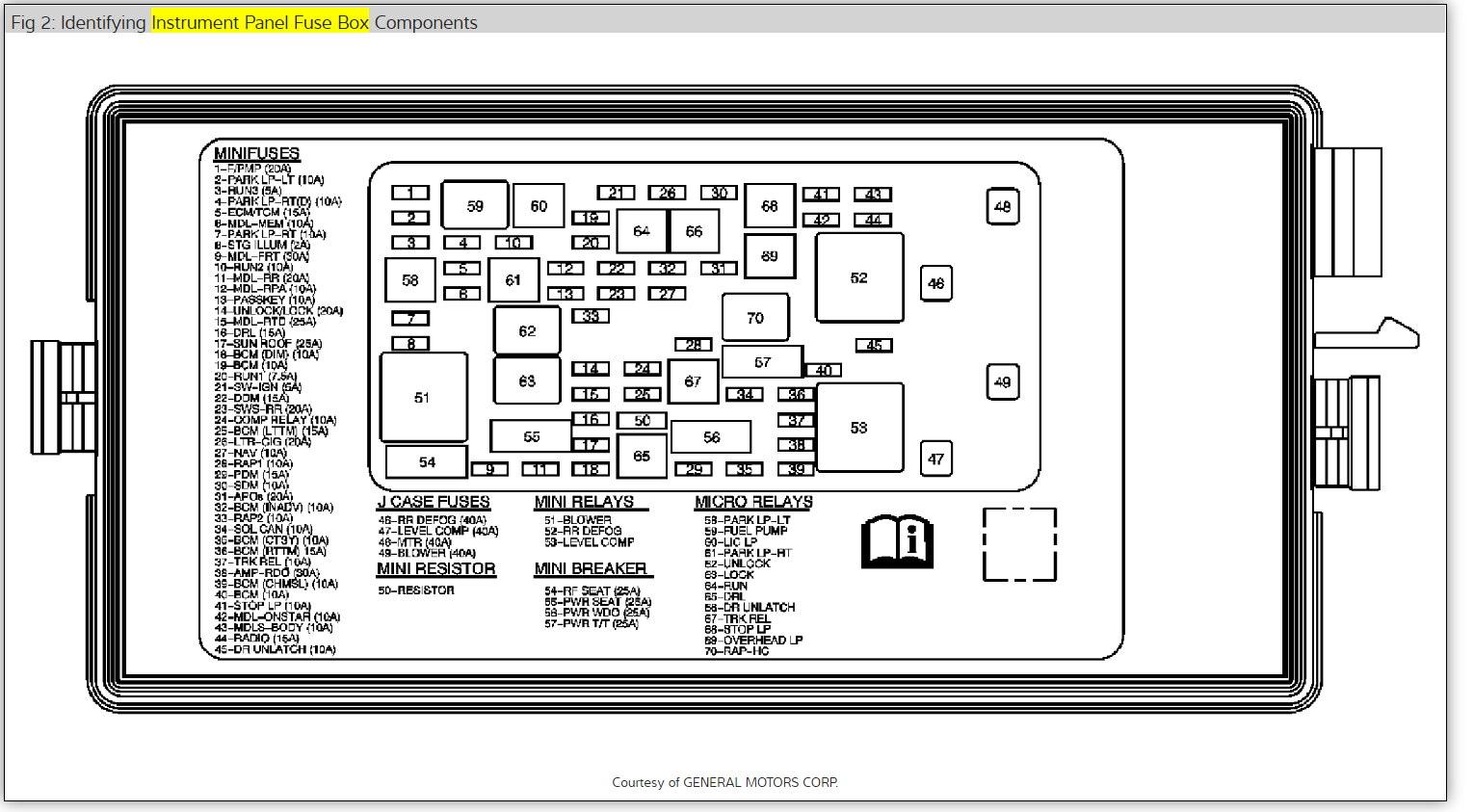

It is the classic fuse pump relay fries because rear sear latch rubs the relay and fuse box. Fuse box removed and new part received. Problem: Each of three plug-n-play connectors has a male bolt to draw it to the fuse box. The fuse box has three male bolts to draw the connector to it. Male bolt to male bolt?

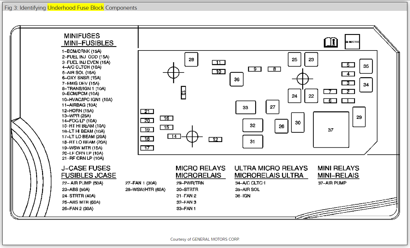

The new fuse block should have come with bolts and nuts. You can remove the bolts from the connector or fuse block and replace with the nuts. This guide can help you check the fuses with the panel location in the diagrams below.
Check out the diagrams (Below). Please let us know what happens.

The relay and fuse box (rear) had no loose nuts, no loose bolts and no instructions. The relay and fuse box (rear) has three specialized bolts with the head having a permanent washer affixed. Bolt head/washer combo on top of the circuit board. Bottom of the bolt has threads visible from bottom of part. Each bolt has a smooth sleeve that is anchored above the mother board. It goes through the mother board and is anchored in the same style on bottom of relay and fuse box (rear). If I had a female coupling on the connector the bolt would pull the connector into position and tighten. Without the female connector the bolts twirl inside the sleeve endlessly. But the connectors each have the same bolt. So I have male bolt to male bolt. That is not going to work.

Check in the fuse box under the rear seat. make sure to check fuse # 31 and 26. Both are 20 amp fuses
Here is a guide that can help with the fuse panels in the diagrams below.
