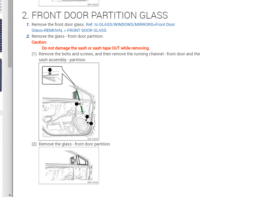

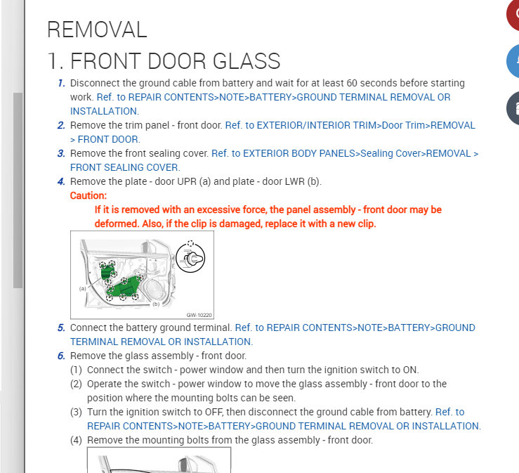

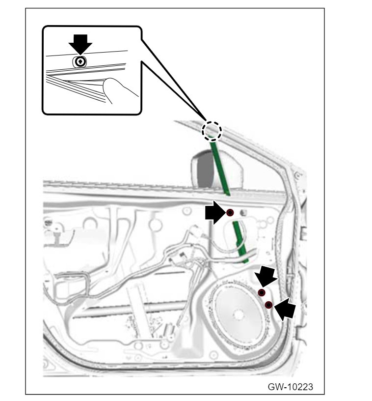

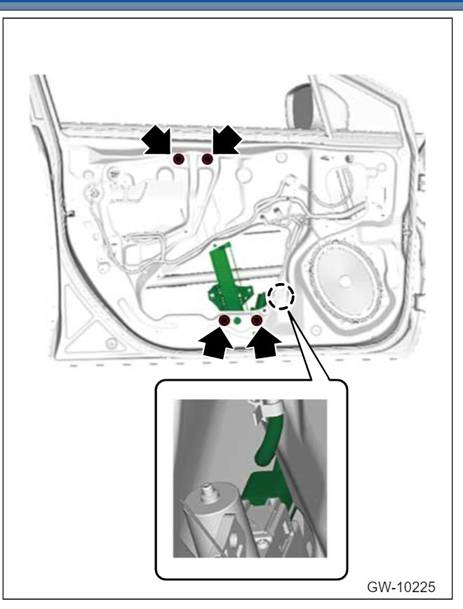

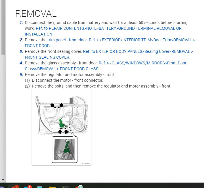

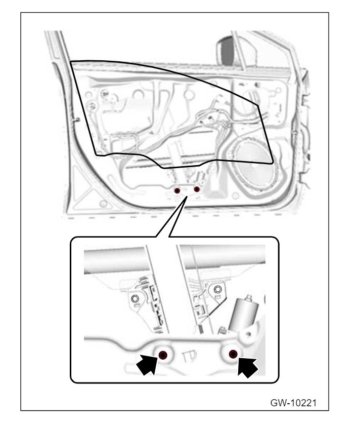

The window is held to the regulator by two bolts at the bottom of the glass, so I am attaching all the info that we need in order to figure this out.
Please run through this info and let me know what questions you have.
