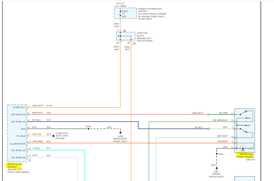

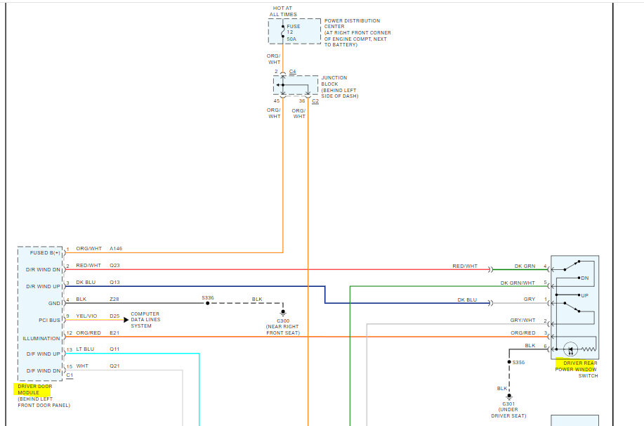

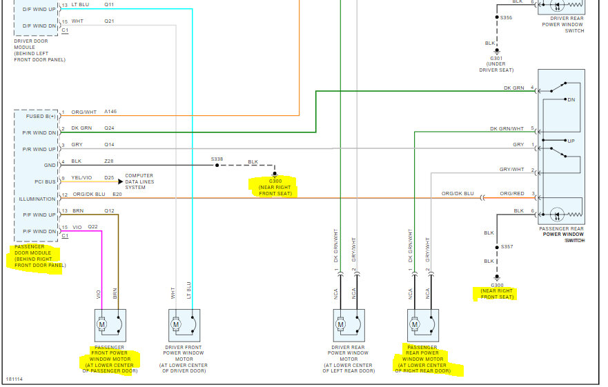

Yesterday, my rear passenger window would go down, but not back up. Drivers switch also will not make it go up. Only down. There is a clicking in the passenger door when i try. Took door panels off on passenger front and back. Getting power to the switch of both doors, actuator cable is intact. I was able to connect 12v power to the window motor and raise the window. Motor seems fine. Today, the window will not go up or down at the door or at the driver's switch. Still hear clicking at passenger front door when attempting to raise window, but nothing from the rear passenger door.
