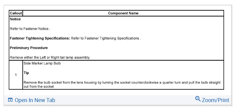

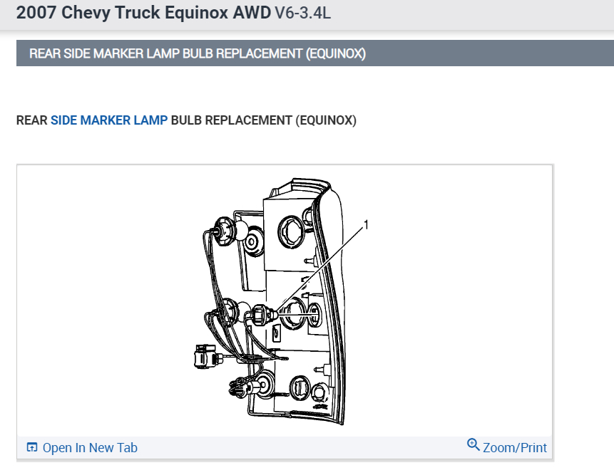

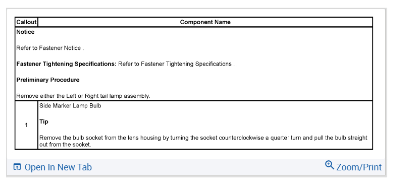

So, it only one running light that doesn't work or all of the running lights not coming on, if it is just the one it sounds like you have a bulb that has gone out here are the instructions on how to change it out in the images below. Also, i have included a guide to help you as well.
https://www.2carpros.com/articles/no-tail-lights-exterior-running-lights-tail-lights-out
Check out the images (below). Let us know what happens and please upload pictures or videos of the problem so we can see what's going on.
