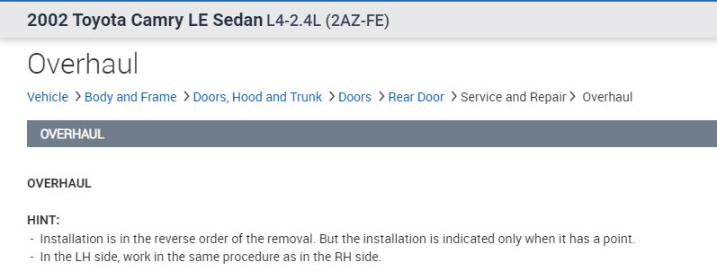

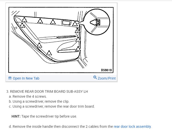

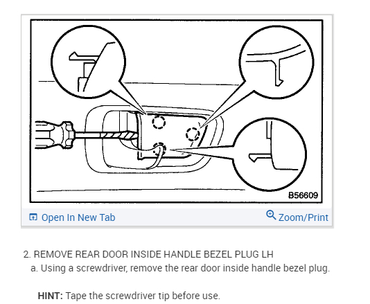

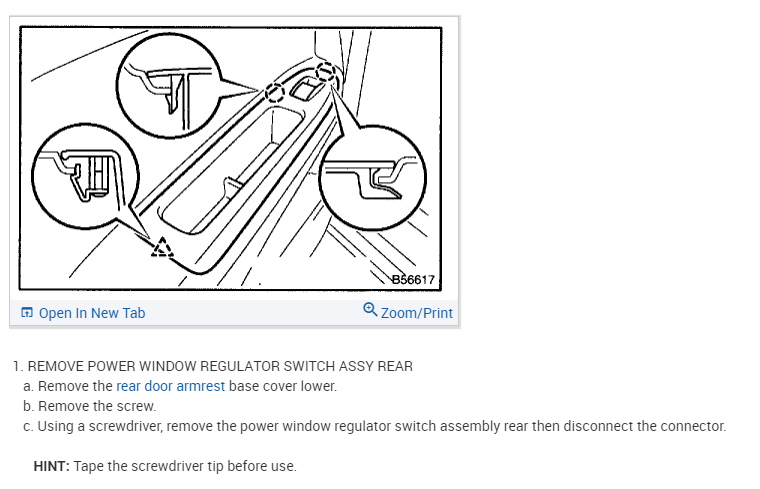

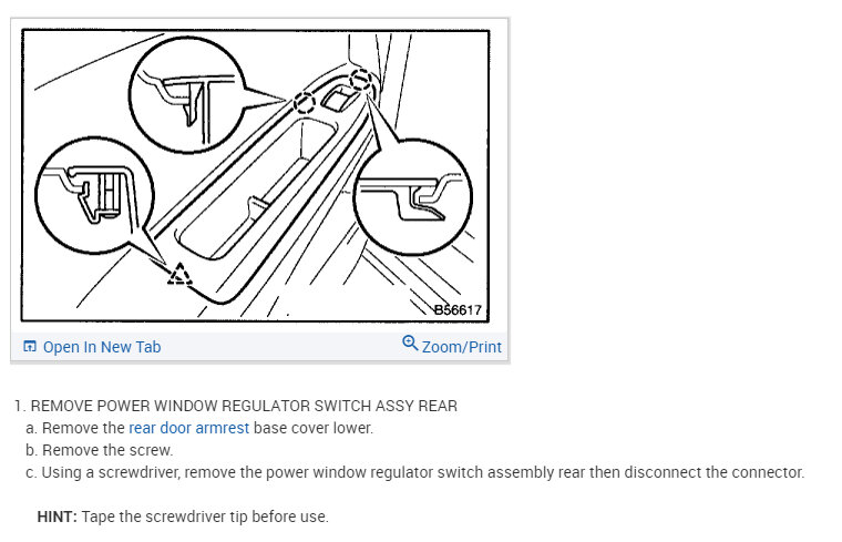

The first thing I need you to do is remove the door panel. I attached the directions below. Note: The section of the manual where I found this info is called a door overhaul. I cut a lot of things off the end. All I need you to do is remove the door panel and send me some pics of the child lock assembly in the door. That way I can come up with a repair. Or you can unlock it from inside the door.
See pics below.
