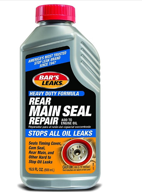

Under normal circumstances, I don't like using additives because they could cause other problems. However, if this is a temporary fix, you may want to consider Bar's Leak rear main sealer. It is specifically designed for rear main seal leaks.
When you change the oil, the product is used in place of a quart of oil. If you want to add it before an oil change, drain a quart of oil out first. You don't want the system overfilled.
I attached a pic below of the product I'm referring to. It may take a couple of days for it to seal, but I've been told it works great.
Let me know if this helps.

See pic below.

Okay, I was wondering if you were able to find it. And yes, it should last a lot longer than a few months. It actually swells the seal and stops the leak.
