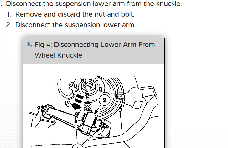

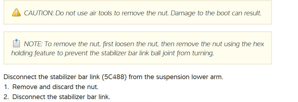

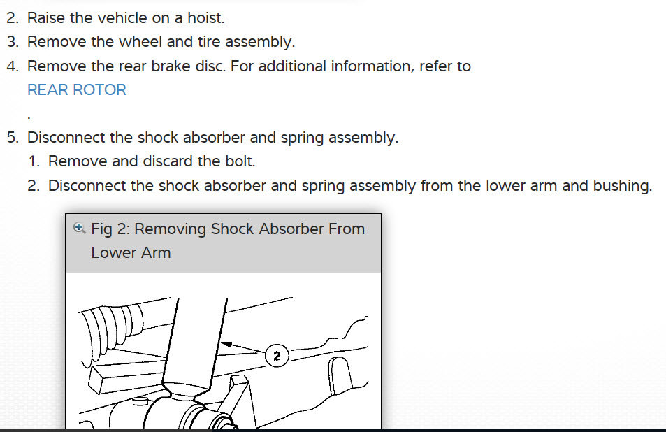

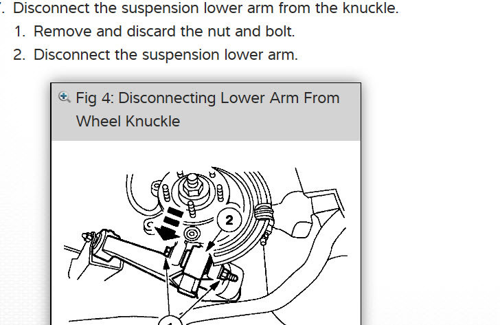

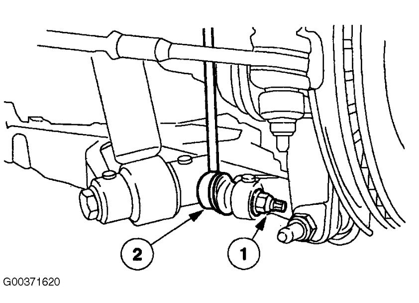

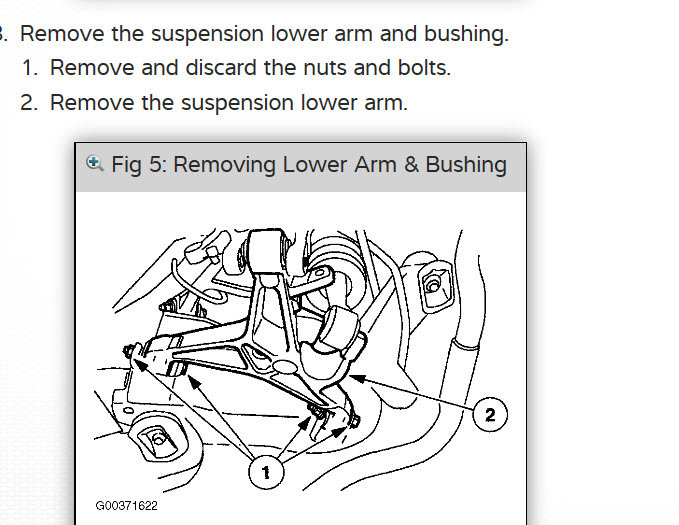

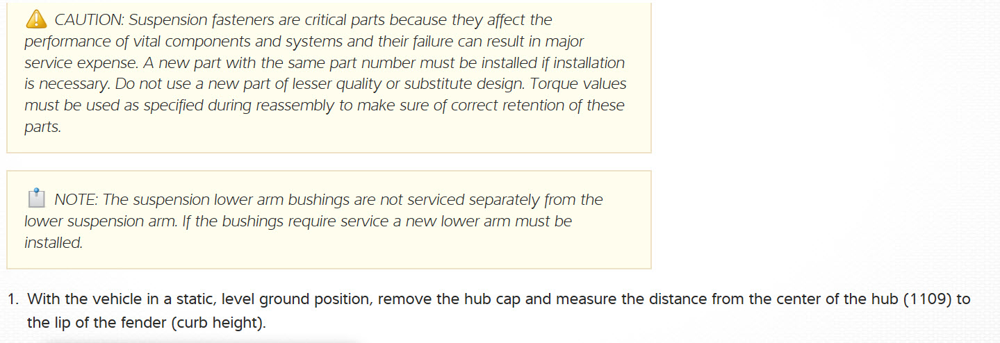

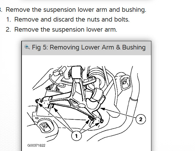

how do you remove rear lower control arm?
May 23, 2017 at 5:32 PM
HMAC300
CERTIFIED EXPERT
48,601 POSTS
see pictures, various nuts must be replaced when reassembling. follow package instructions.
