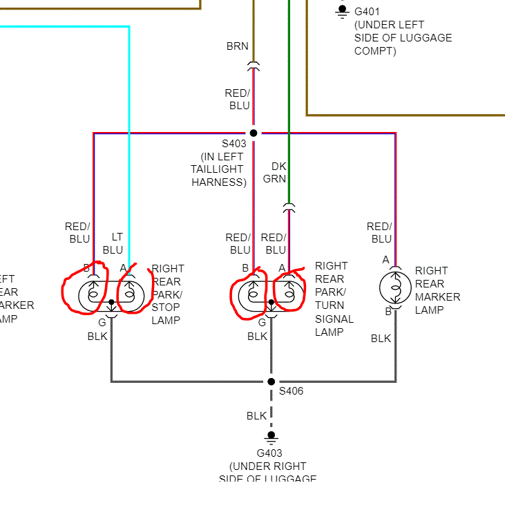

The bulbs are duel element. So, when the parking lights are on, one element is used in the bulb and when you turn the signals or brake lights on, the other element works. As far as the back up lights, that is a separate circuit and bulb system.
If you look at the first pic, I circled the two elements in each light. One is likely burned out in each bulb on the right side.

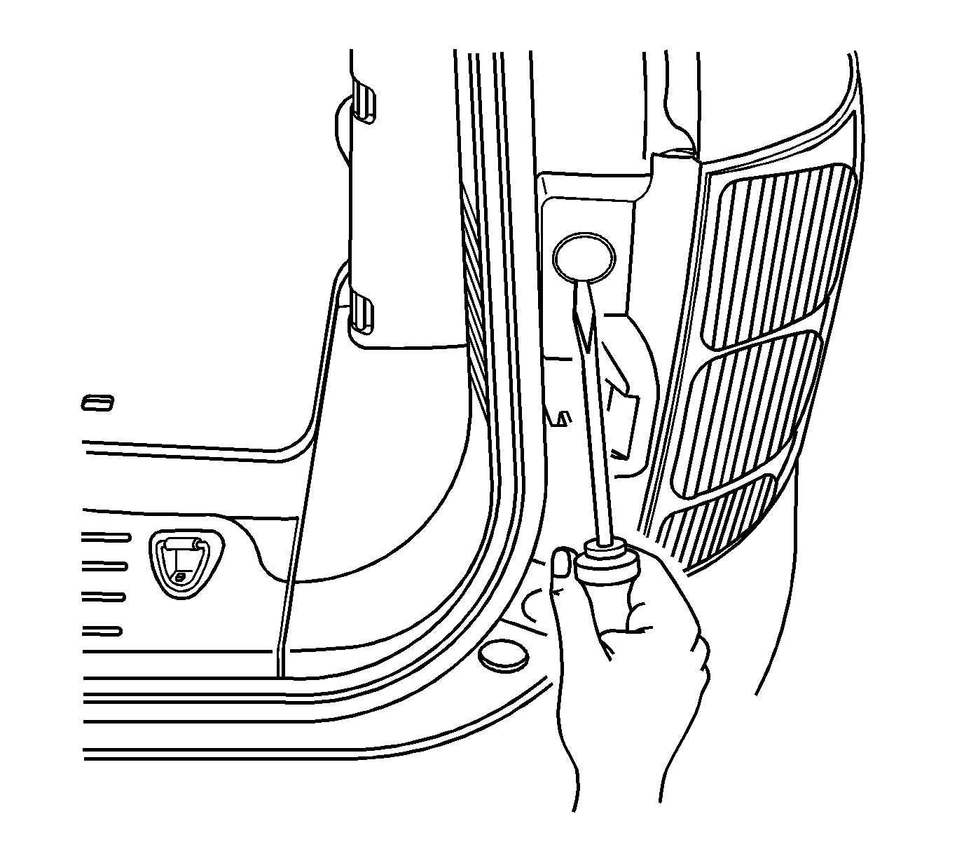

pic 2
1. Remove the tail lamp bolt covers.

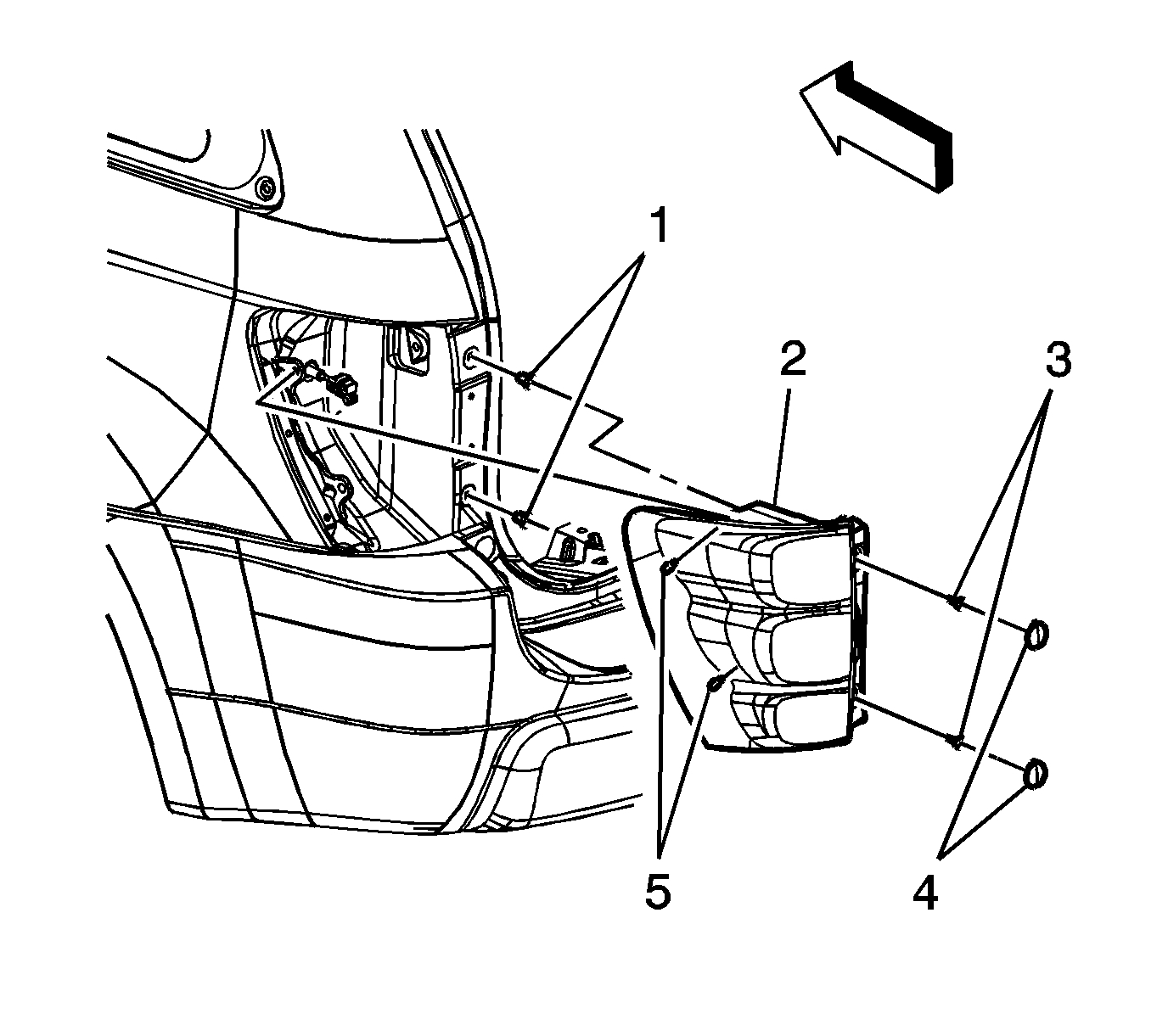

pic 4

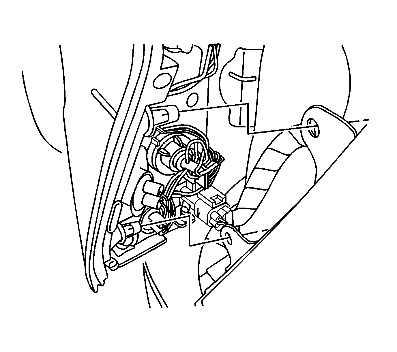

3. Pull outward at the front of the tail lamp assembly to disengage the retainers from the body side.
4. Remove the bulbs from the tail lamp assembly.
5. Remove the tail lamp assembly from the vehicle.

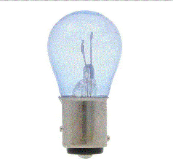

From memory, I believe the bulb you need is a 2057. The last pic shows what it looks like. Take the old one with you to a parts store to get one if your's looks different.

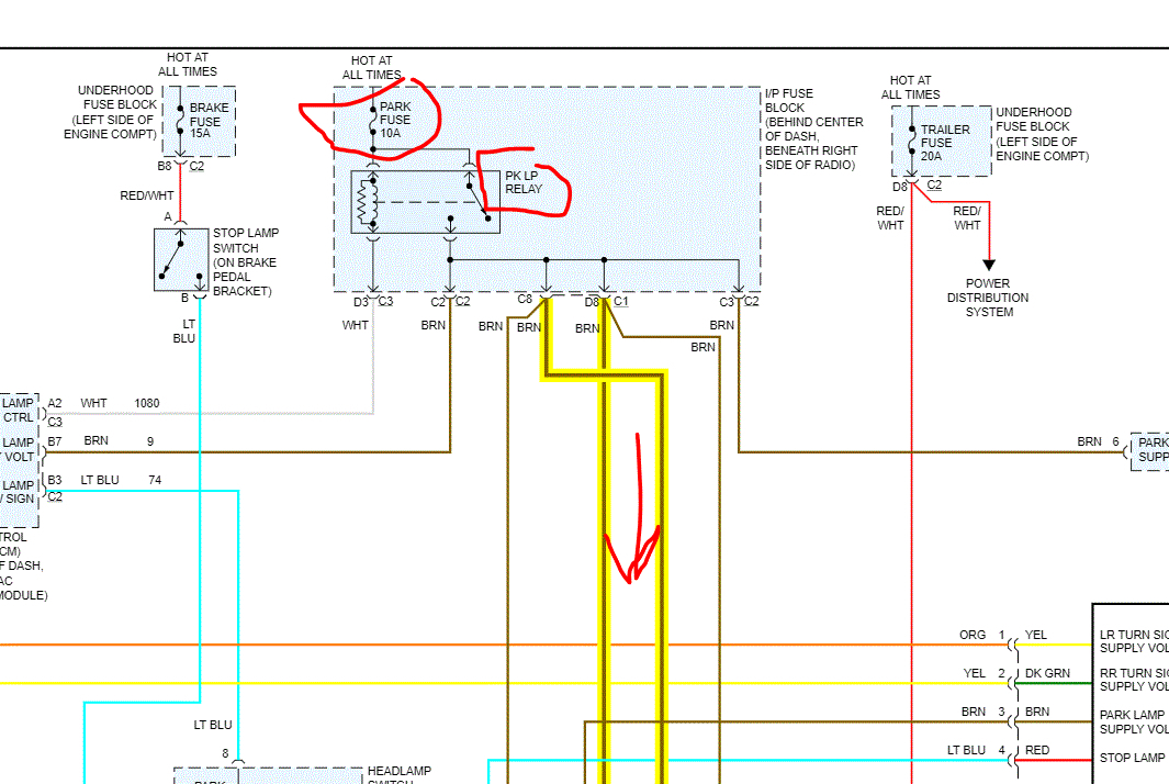

It shouldn't. Were you able to check for power to the light sockets or the bulbs themselves? I have to be honest, I have a feeling it is the bulbs. If you look at the attached pic, I circled a fuse, relay and then you will see two wires I highlighted and an arrow pointing down. Note that the fuse and relay send power to both rear parking lights. So, if the fuse or relay was bad, the left side wouldn't work either. The two wires and arrow simply are going to the rear tail lights.
If you can, check to see if there is power to the sockets for the parking lights. If there is, then chances are it is a bulb. If there is no power, then we have to trace the wiring back to the relay.
