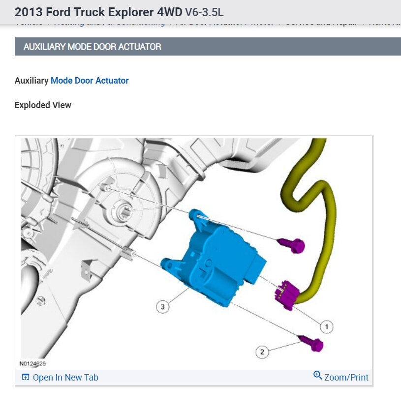

I'm having following errors for my Explorer 2013 XLT
B11E3:07 - Rear HVAC Damper Motor: Mechanical Failure
B1B7D:11 - Rear Air Distribution Actuator: circuit short to ground
I can smell odors from outside in the car when air recirculation is on.
