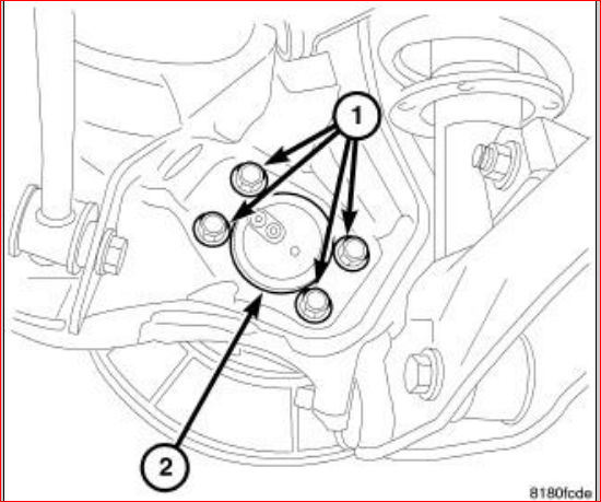

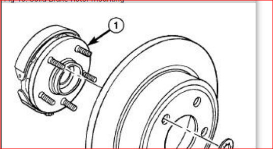

What is the question you are asking? I have attached a few pictures and a tutorial to view. Hope to hear from you soon and thanks for using 2CarPros.

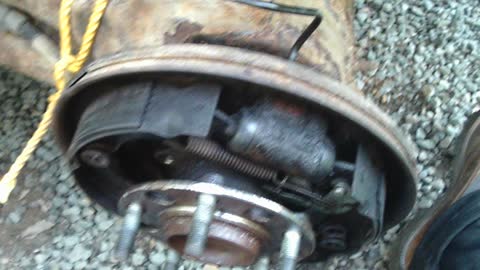

Here is a video. I hope it shows up good enough for ya'.

And every video I come across has rear disc brakes, mine has drum brakes.

Am I correct in my thinking, as mentioned in my video, that I should be able to just pop (beat) it out from the backside?

Yes, that is correct. Maybe try using a spray type penetrant (PB Blaster or WD40 Blast) Or time for a bigger hammer!

Yup, your suggestions are exactly what I have been doing, back at it in morning. I will be in contact with further information, if I come across anything new. Thanks.
