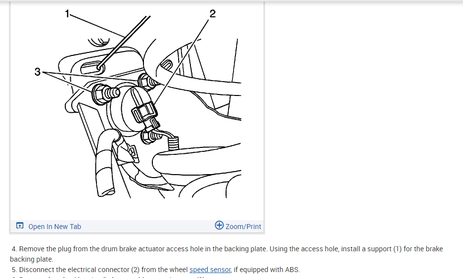

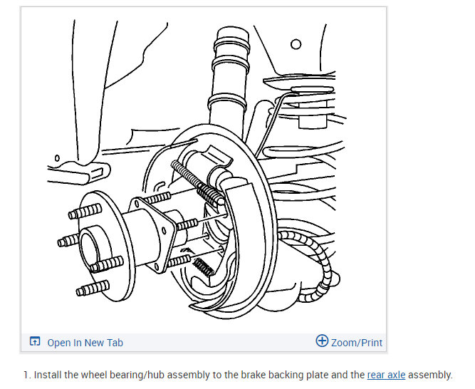

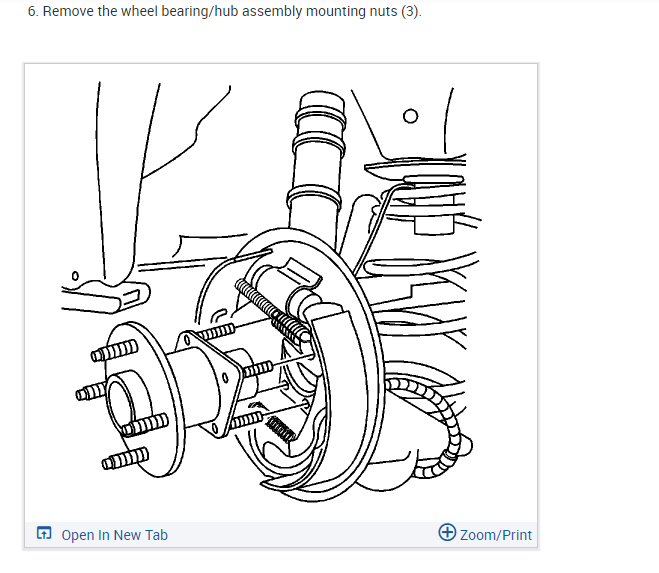

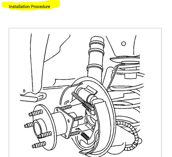

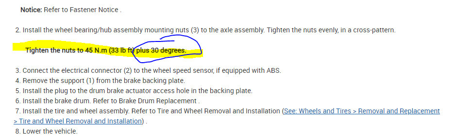

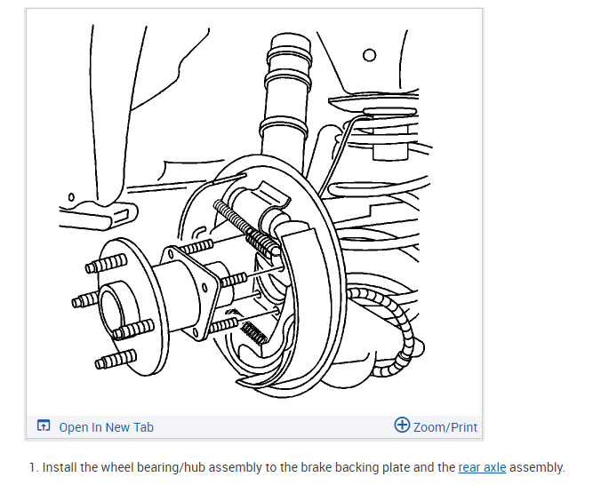

The new hub assembly should already have the new wheel studs installed. Let me know if that isn't the case.

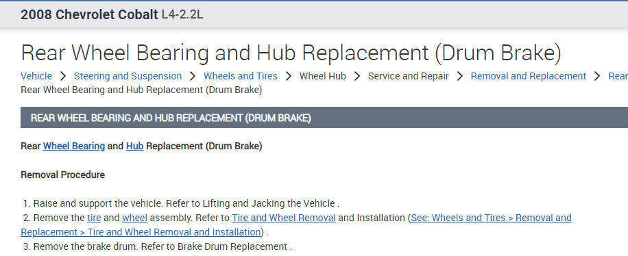

As far as replacing the hub assemblies, I attached the directions below specific to this vehicle. Take a look through them and let me know if you have any questions.
